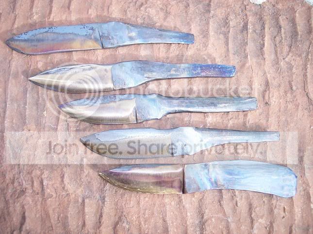

5160 and 52100 blanks
Forging, rough shape, and HT done so far, one sharpened and passes multiple edge flex-tests and is a real cutter. Have all the guards rough fit. (as I hot fit them before HT) .
One will be tested to destruction, receiver will get the best of the rest.
