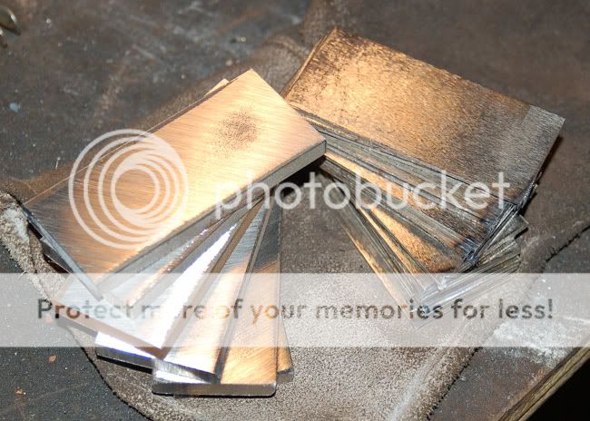

Keith, I use 416 for a couple of reasons... I've used 303, 304, 316, 410 and 416, and in many ways, they all work fine. The main advantage of 416 over most of the others is it's ease of grinding, drilling, etc. Asthetically, both 410 and 416 will "eat" carbon from the outer edges of the core and it creates those cool carbon migration patterns that look like layers of silver and gray.

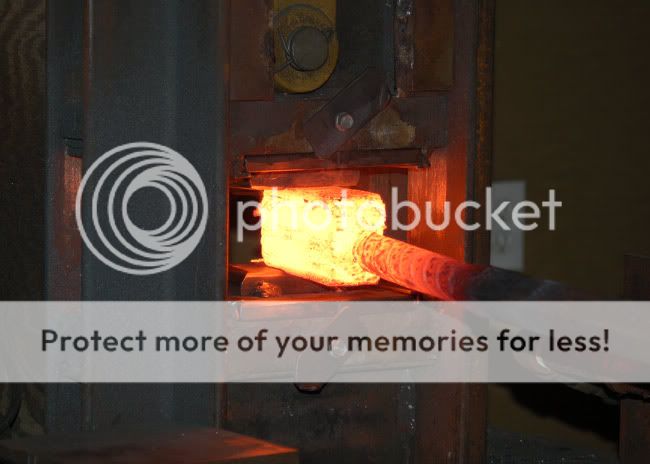

The damascus for the fittings is the same mix I use for knife blades, just to keep me from getting confused: O-1 and 15N20.

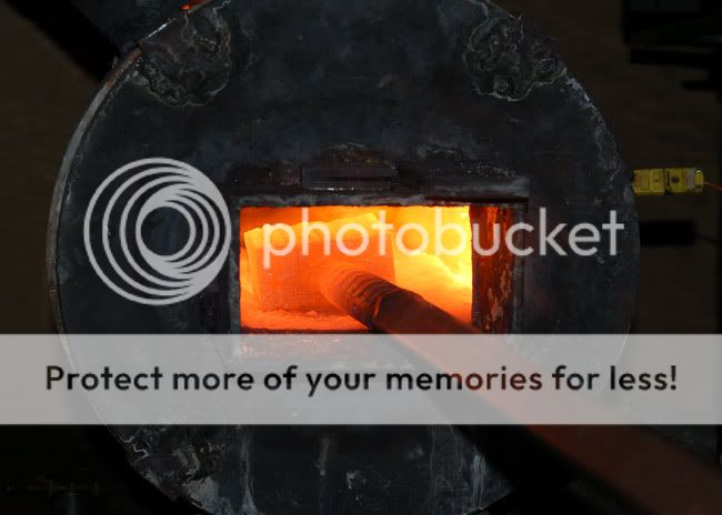

Billet goes into the forge...

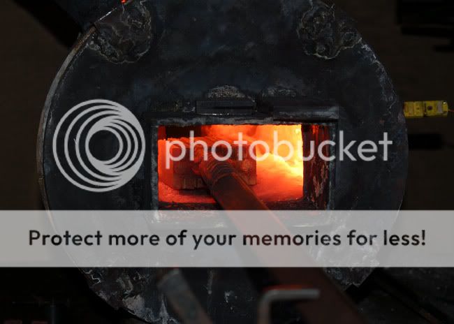

Heating up...

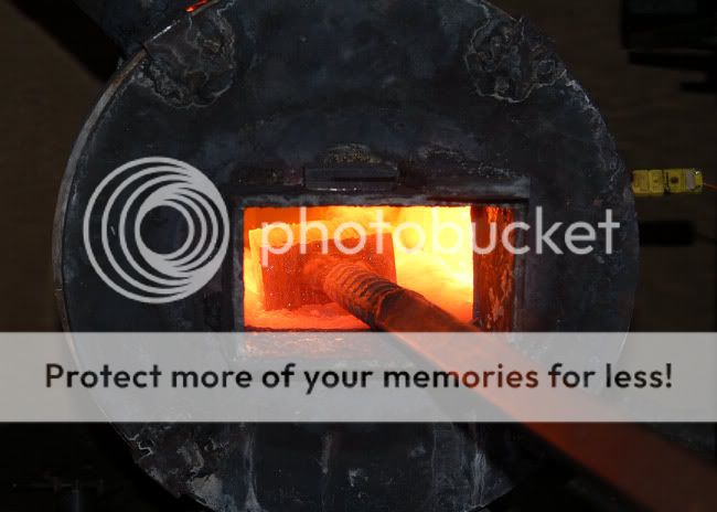

Nearly there...

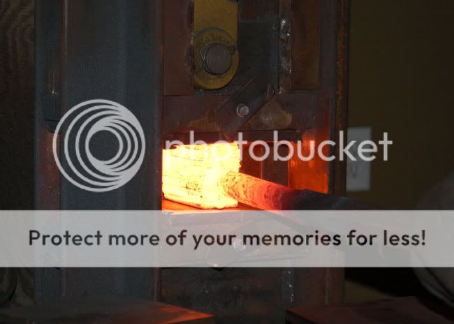

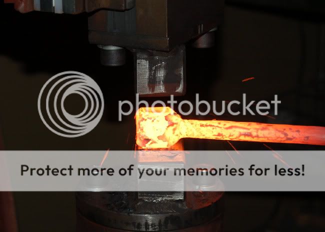

And when it's up to temp, I do the first weld with the flat dies...

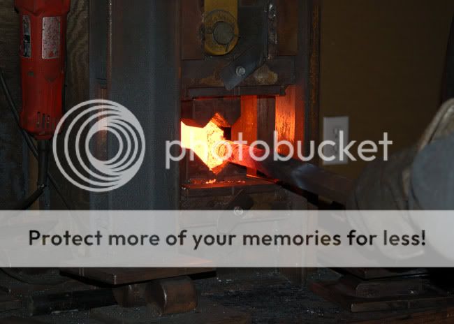

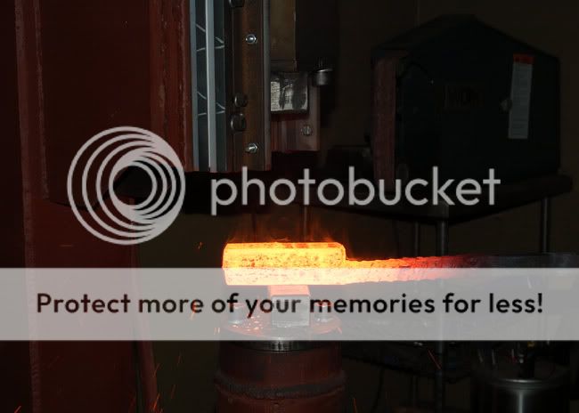

Then switch to the flat drawing dies to draw it out.
Then there's the drawing and the folding yada-yada-yada. You all know the drill, but on the other hand, some of the pictures are cool, so here are a few more.

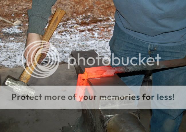

I'm re-squaring the billet...
And after folding it, I draw it out on the power hammer...

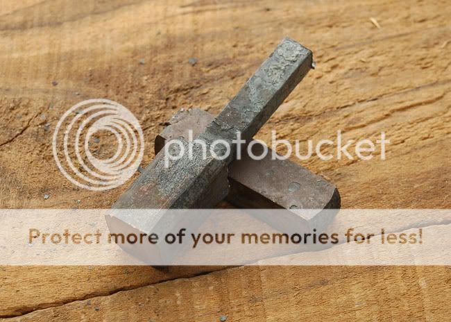

I saw off a smaller piece, weld it to a bar, and forge it to the general shape of the guard, and another one to make the take-down nut.
And here are the two forged pieces for the fittings.

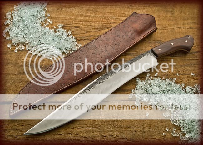

Hey, Burt, this is gonna be another beauty. And by the way, you should show the folks that "Primitive" Bolo-type you e-mailed the pic of. That's yet another Foster triumph.
John
bolo, eh? Do tell...:D
