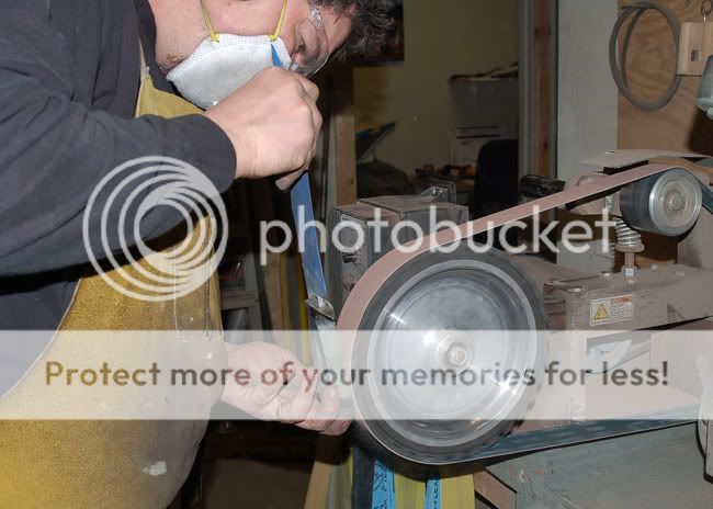

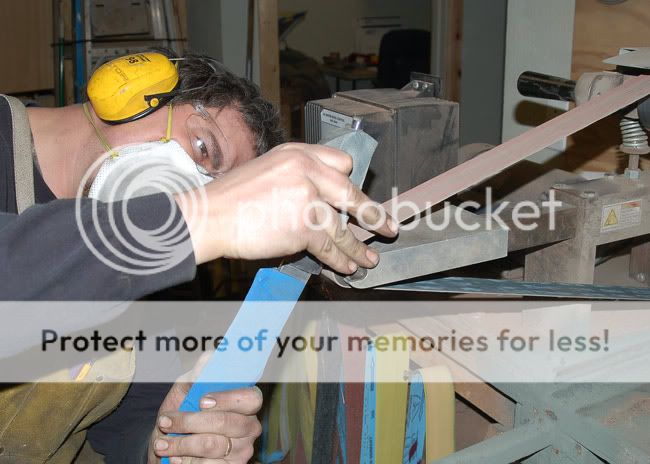

Some handle grinding...
Can't see what's happening - there's some big oaf in the way.
Using the small wheel to set the radius on the back of the guard (another wonderful shot :D ).
The 10" contact wheel for roughing in the palm swell. Actually, it's not a swell, it's the opposite, but that what we all call it.

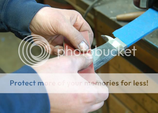

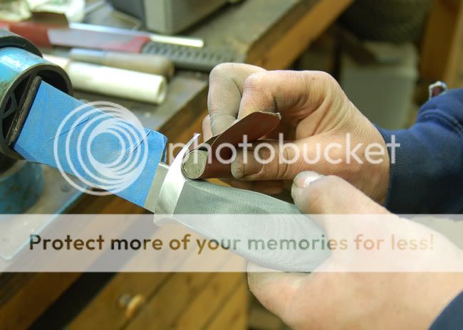

And hand sanding - super fun!
Using a leather covered steel rod (W-2 I think) to blend the curves.

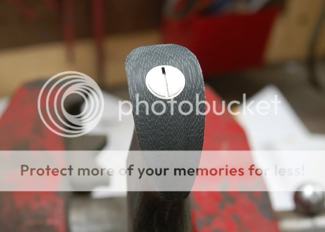

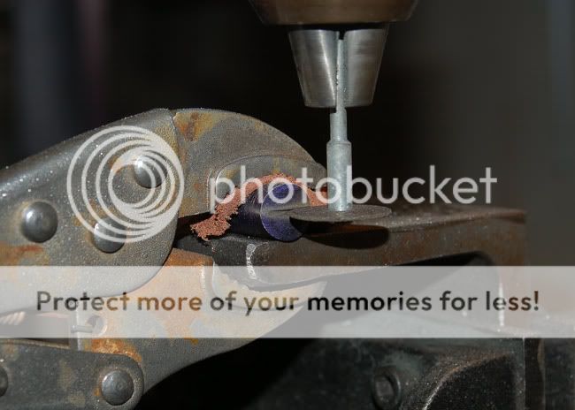

Here I'm using a little cutter to slot the nut.
And here it is sanded flush with the butt.

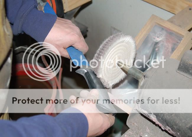

A quick buff of the handle and fittings after they're sanded.

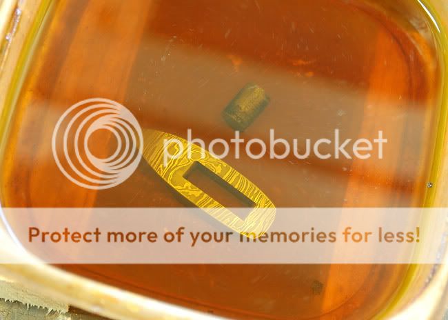

The guard and nut in the ferric chloride to etch.

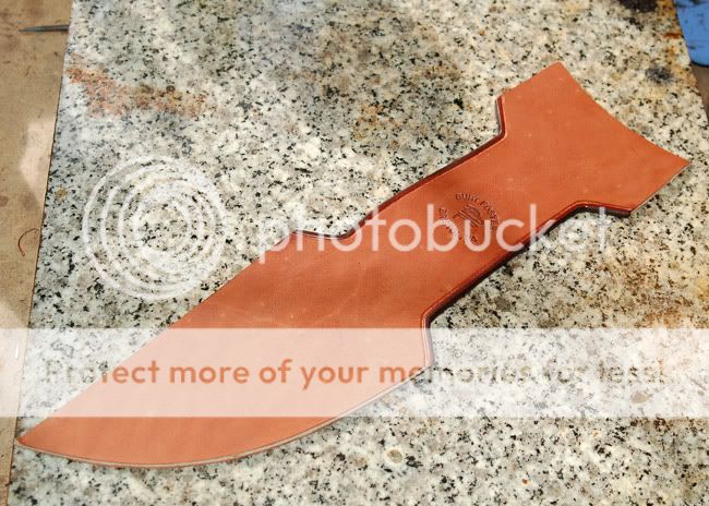

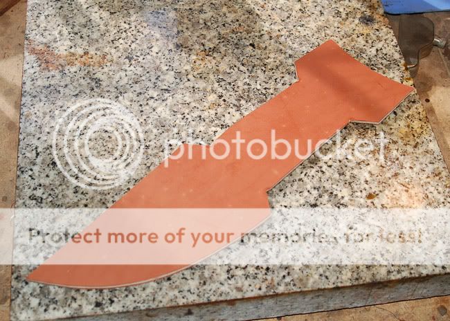

This piece will be the belt loop on the back. On this knife, it'll run the full length of the sheath, meaning the back side of the sheath will have a double layer of leather for rigidity.
The edges of the belt loop have been "beaded" smoothed and dyed.

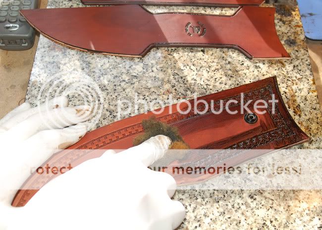

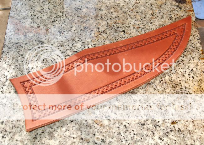

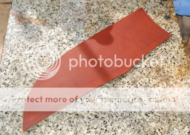

Here's the front piece. You can see the faint guideline where I'll start the tooling. This sheath will not have a lot of tooling, just a nice border.
This is the first row. This is a "meandering" type stamp I made a few weeks ago.
And this is the second row. The meandering stamps create an image between the stamped rows. Basically, your eyes notice the area between the rows and not the rows themselves.
Staining the leather. I'm a big fan of pre-dyed leather, and in fact, this leather is pre-dyed. But I'm getting back to the antique stains because I like the effect they give. It's a little warmer and richer than the pre-dyed colors. At least I think so... It loos terrible right now, but I promise it looks better when it's wiped down and finished.

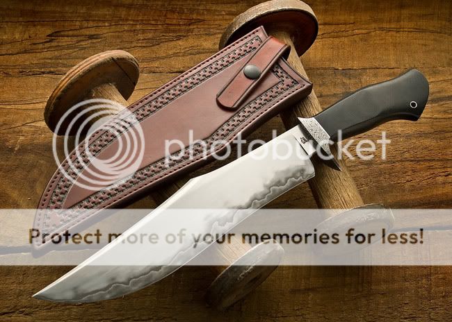

And the final knife....

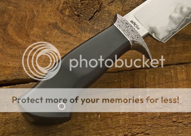

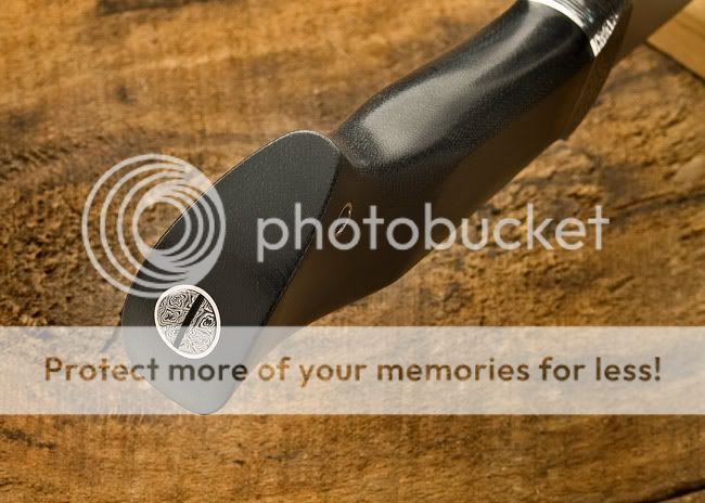

The flush damascus take-down nut.
Close up of the guard and handle.
And the whole deal.
Some knives are fun to make, and others are a challenge. Others are just a royal pain. This one was fun. The process went rather smoothly, and each part came together pretty much the way I was hoping it would.
