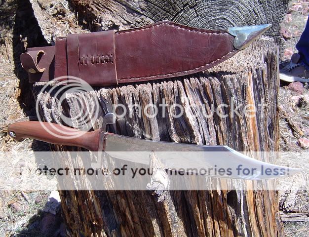

This is sort of what I settled on as well, except I use a "khukri-sized" bowie (18" blade). But, note I don't have much experience with a proper tomahawk (been meaning to work on my pipe hawk more), so it's taking the place of a Wetterlings hatchet in my case. The bowie would outchop my HI Dui Chirra khuk, and manuever faster than a machete. It's my "go to" blade for all kinds of stuff involving brush and smaller diameter wood (say, 5"-6" thick limbs), and is handy enough to clean squirrels or open the mail.
I've never studied/practiced any sort of combatives with a tomahawk. I would like to try sometime, but right now am focused on German Longsword in the Liechtenauer tradition. And then messer is next on my list.
I did used to hunt varmints with a knife; in fact, that's expressly what I made the bowie above for. No, I've never tackled a cougar or bear, but I feel I did learn lots of valuable insights about dynamic blade work from my experiences.

if i was going to design a perfect bowie (for me) it would probably be 5/32" - 3/16" stock thickness with morphing grinds for strength and mass placement, 12 inches long blade...
...and there would be a very thin metal cap on the butt that acted as ballast as well as protection, so the balde would turn hard.
With all due respect, I don't think you should rule out thicker stock. Like 1/4" or more. From there you distal taper the blade so it's thinner where it counts. And once the blade tapers are in place, you can add cutting power back in by using a properly weighted pommel rather than a thin butt cap. By centering the mass closer to your hand via the tapers and pommel, you add weight where it's easy for you to move. But it's farther away from the tip, making that mass harder for whatever you hit to move it back. Thus you get the best of both worlds- a blade that is easy to swing and fast to manuever, yet hits much harder than you'd expect, and often even harder than much slower, heavier, blades. I can explain further or link to articles if anyone's interested...

Say, like 2 feet long? (like my bowie above?) ;)
