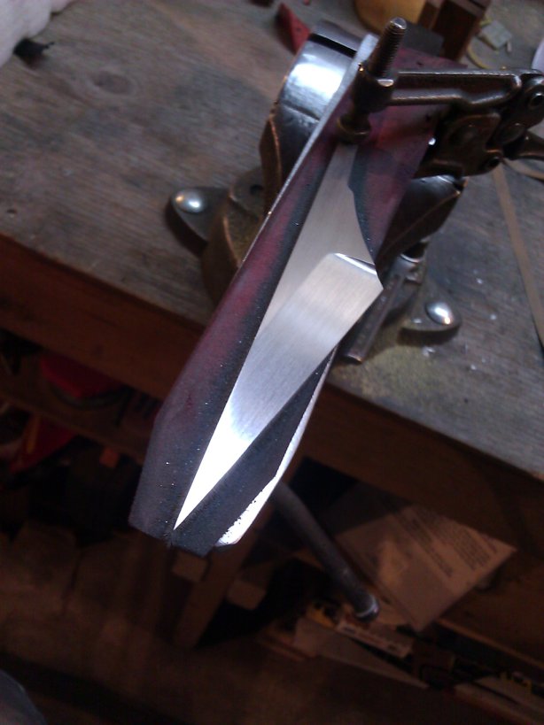

FWIW, I always sand out the blade before the scales are on. lets me keep the ricasso clean with full strokes under where the handle seam will be, and it's much easier to clamp a blade to a knife board without scales in the way. Then I tape it up to protect it while doing the handle work.

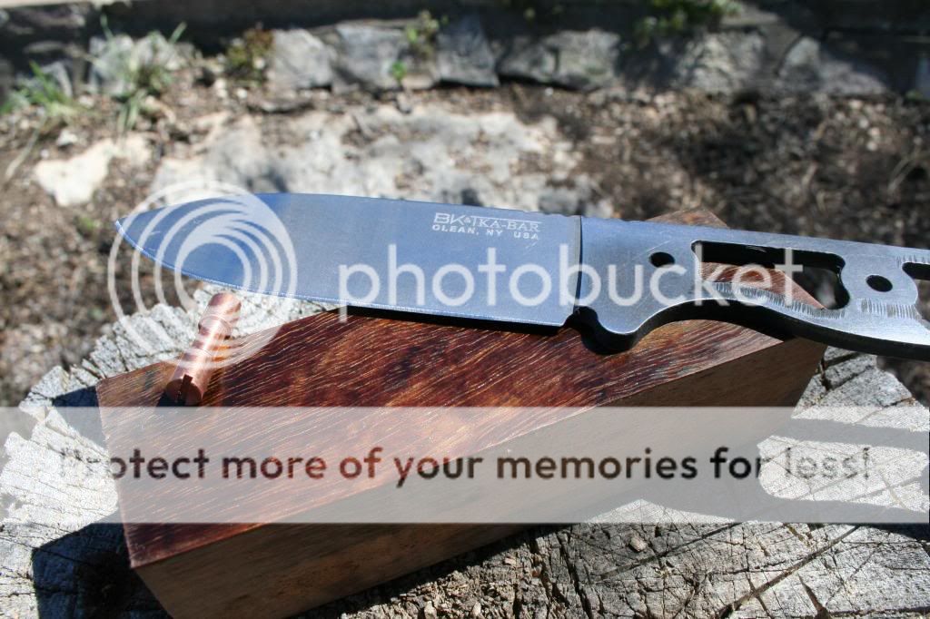

I am for sure going to be using wood as handles for my project 16. I was unsure if I was going to use wood or some burlap micarta from Shadetree but these knives have sealed the deal. Only down side is I have ZERO ability to work with wood so I will have to send the knife out to someone to have them done.

And yea I sanded the last one all out before. I did do a little sanding before hand on this one. So it didn't have to much left to be done. And I do it by hand on with sandpaper glued to a piece of glass and then finish up the high girts on a piece of plexi glass with a thin foam sheet stuck to it that I clamp sand paper to. The way I do it, the scales can't come in contact with the sandpaper at all. But I totally see how an accident can happen and then I'd have to start back at the beginning and get the marks out. I'm still trying to figure out the best way to do things. Thanks of the advice! I know you've done way more than I have.
And I guess I need to figure out what a knife board is.......... probably make my life a lot easier. haha

I would recommend stabilized wood for sure. And it's really no different than shaping micarta. Actually it's a little easier. You should just practice on some cheap wood or something first. I'm sure you can do it.

Thank you Mike! And yea, I was a diehard micarta fan before this little project, now I love the wood scales a lot more. Have some stabilized curly koa that should be here next week and is going to look amazing on the bush crafter 16 I'm working on.

here be a knife board.
It's a piece of metal from the hardware store with a 90-degree bend in it, that I simply clamp into my vise. I use a piece of craft foam between the blade and 'board' for traction and to reduce scratching on the back side (also use tape!). Then the tang can be clamped to the board. Sand up to your grit, then tape it off and flip it over. You end up moving the abrasive instead of the blade - different strokes for different folks, as they say. But this is a VERY stable setup. BTW, if you do this, make sure your 'board' is long enough that the tips of your knives won't stick off the end. The very last thing you need is to impale yourself on your project...
