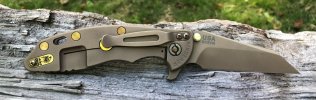

Lets see some Hinderer action
I feel like Hinderer is getting more and more popular, with the new X, new magnacut steel, and supposedly their bringing back the full track. Still expensive, but it wasn’t long ago, that it was really difficult to get any Hinderers, never mind the color/blade combination you want, they seem to be expanding. 🤘
New scale on the Halftrack.
