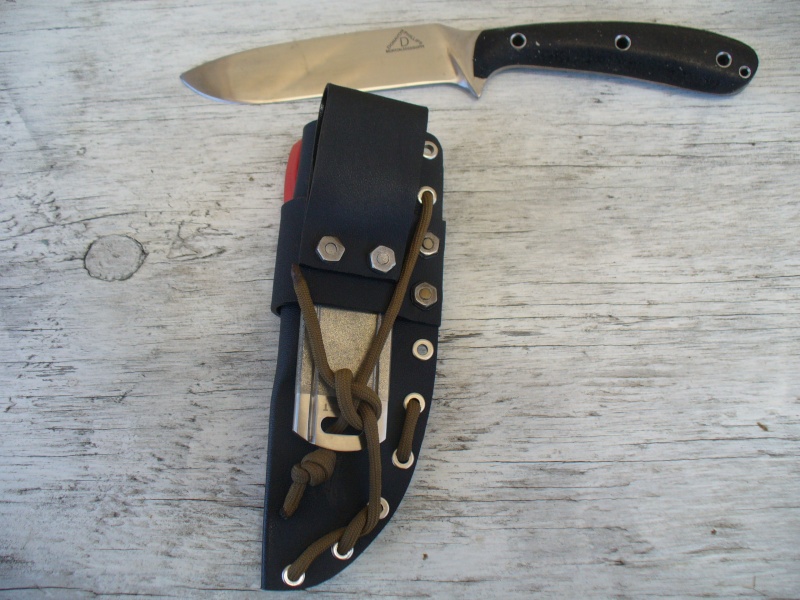

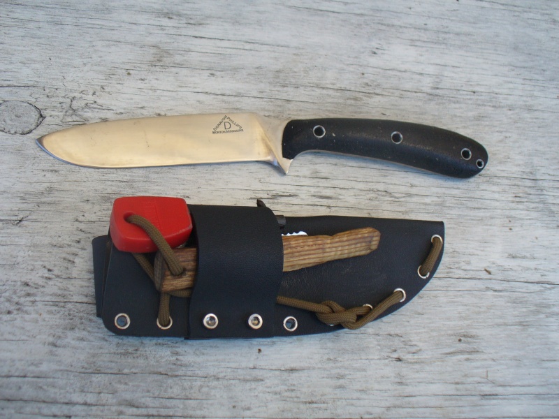

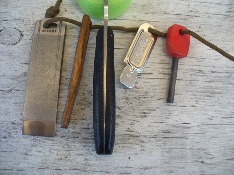

Here is my hunting knife also guys. This is made to be ugly so maybe noone will try to buy it. :D Pit I just wanted to say that I know this thread is about protos, but these started as protos.
The metal tool on the left is CRKT's PTS (pelvic tool sharpener). Acquired this at a gun show last week. 400 grit diamond all the way around with "hook" groove and the side can be used to sharpen serrations. It is designed to be used instead of a hatchet to seperate the pelvic bone while field dressing, just tap it with a rock or stick. Russ Kommer designed and I thought it would be useful.
Thanks for looking,
Donavon
Oh, the handles on both of the knives I posted is rubber like I use on my competition knives.

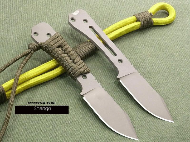

How about a survival backup/ neck knife prototype picture of an upcoming design from myself and TOPS?
The knife will be the one on top. Don't worry, those ridges will be very flat, not as protruding. 440C Flat ground, able to light/scrape magnesium and ferro rods with the knife IN the sheath. SHANGO is outa the bag!

The Shango looks like a keeper. Any chance of making the slot in the handle wide enough to store a firesteel and use the wrap to keep it in place, or maybe use O-rings, ala Atwoods tools?
