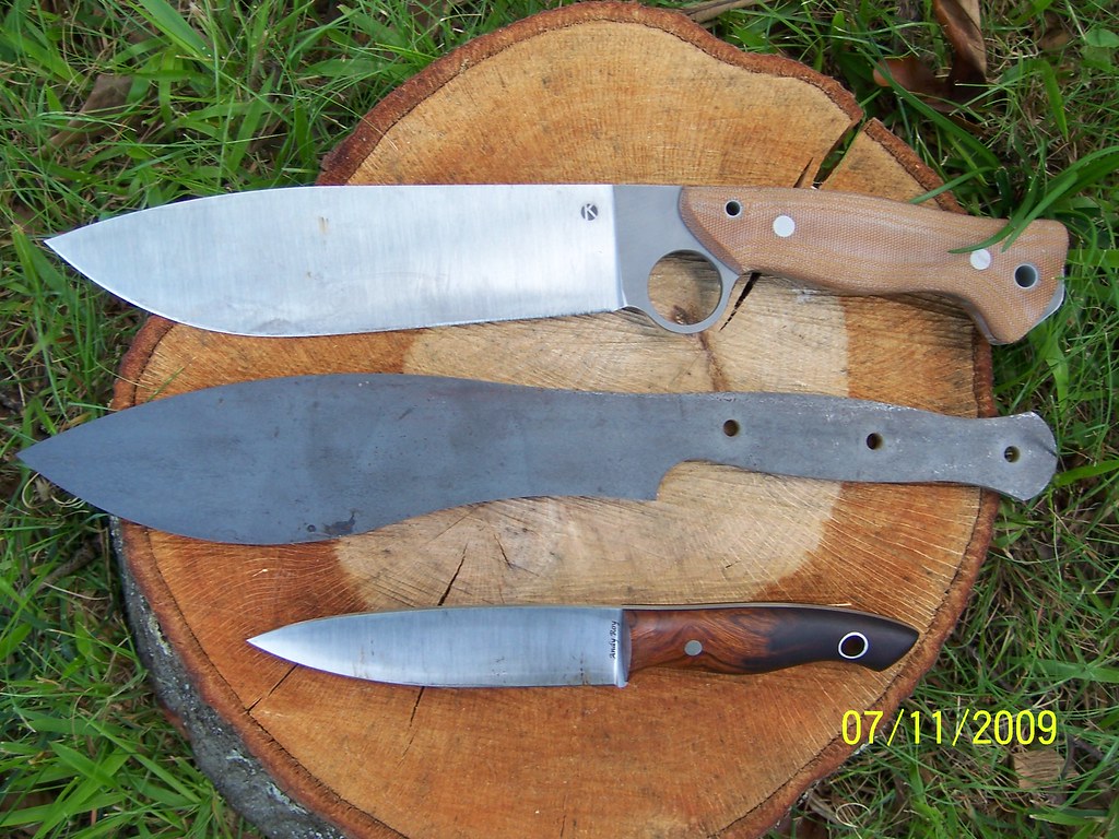

The blanks of my concept arrived in the mail from Great Lakes Water Jet on Thursday and I'm just now getting around to posting pics. As many know, David does great work and these came out spot on to the drawing. Here is a shot of one of the blanks.
It is 16 inches overall with a maximum blade height of 2.5 inches. I got two blanks, both 0.250" thick and cut from 5160. This will afford me the opportunity to screw one up or have two for use as part of a passaround and giveaway. I'm shooting for the latter.
Here is a pic of the blank between my Fiddleback Woodsman and my Koster Survivor.

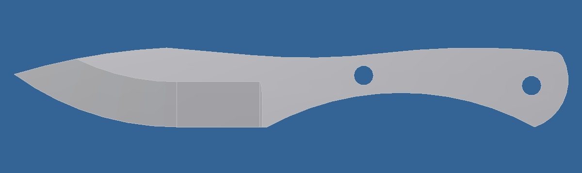

I think it is more obvious from this pic that my handle shape needs a little more refinement. I'm also going to heed the advice of a respected maker and friend who suggested that I practice on a smaller, shorter, straight blade prior to trying to tackle these. Here is a sneak peak of that design as well.
JC, those are both pretty dang cool designs, but that big one really gets my heart pumpin' :D:thumbup: I can't wait to see how they come out!

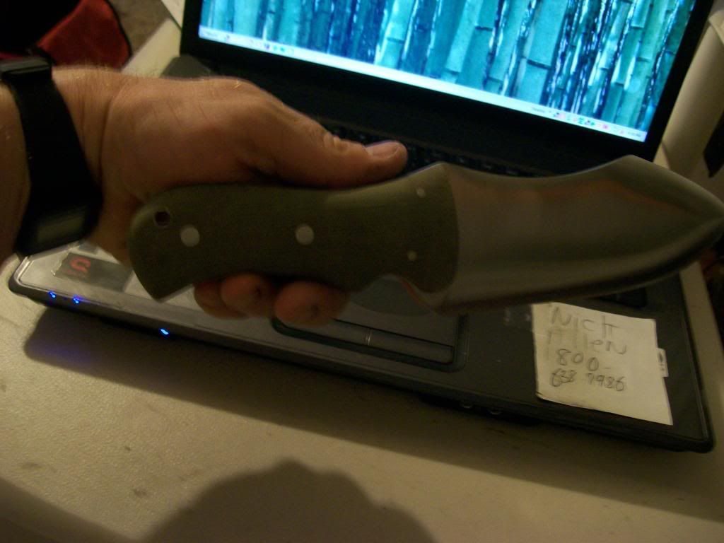

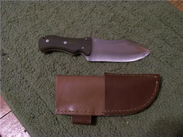

Didn't want to see this thread go away quite yet. Had to dig 5 pages deep to find it. All I have left on mine is to finish the sheath and sharpen it. There should be pics coming this weekend, hopefully.
Donavon

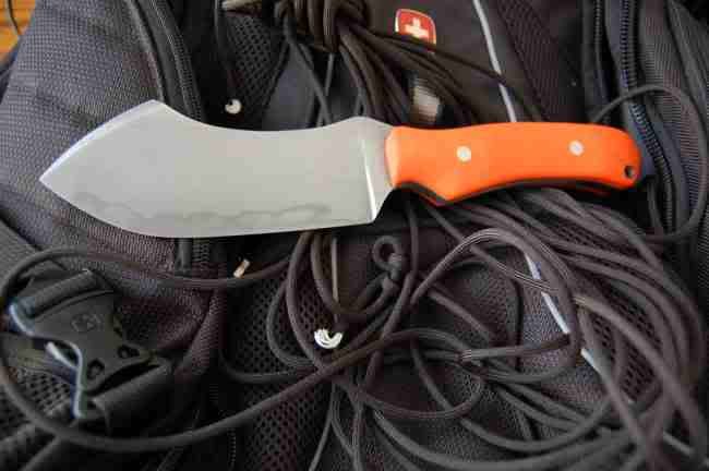

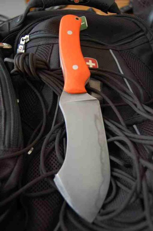

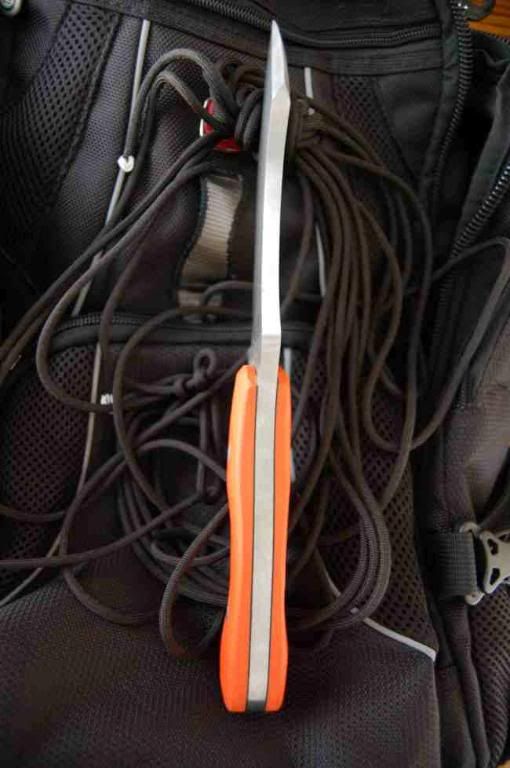

The top one kinda reminds me of this knife that I drew a short time back.....
JUst as an open question, I never quite understood the point of a nessie design or any blade with lots of belly or even a hump. Actually I find knives with rounded bellies annoying when cutting and lets not talk about sharpening. What is the reasoning behind this type of design. I don't mind the looks I just wondered what the advantages are.
bodhi,
I find the belly useful for skinning. You don't have to rely exclusively on the tip if the knife has some belly to it.
On a larger knife, some belly allows you to rock the knife while mincing onions or the like.
A wider tip, as on a Nessie, is also useful for spreading things like peanut butter.
DancesWithKnives
bodhi,
DancesWithKnives
Thx for the answer, I've been looking at some nessies and sooner or later I'll buy one.
