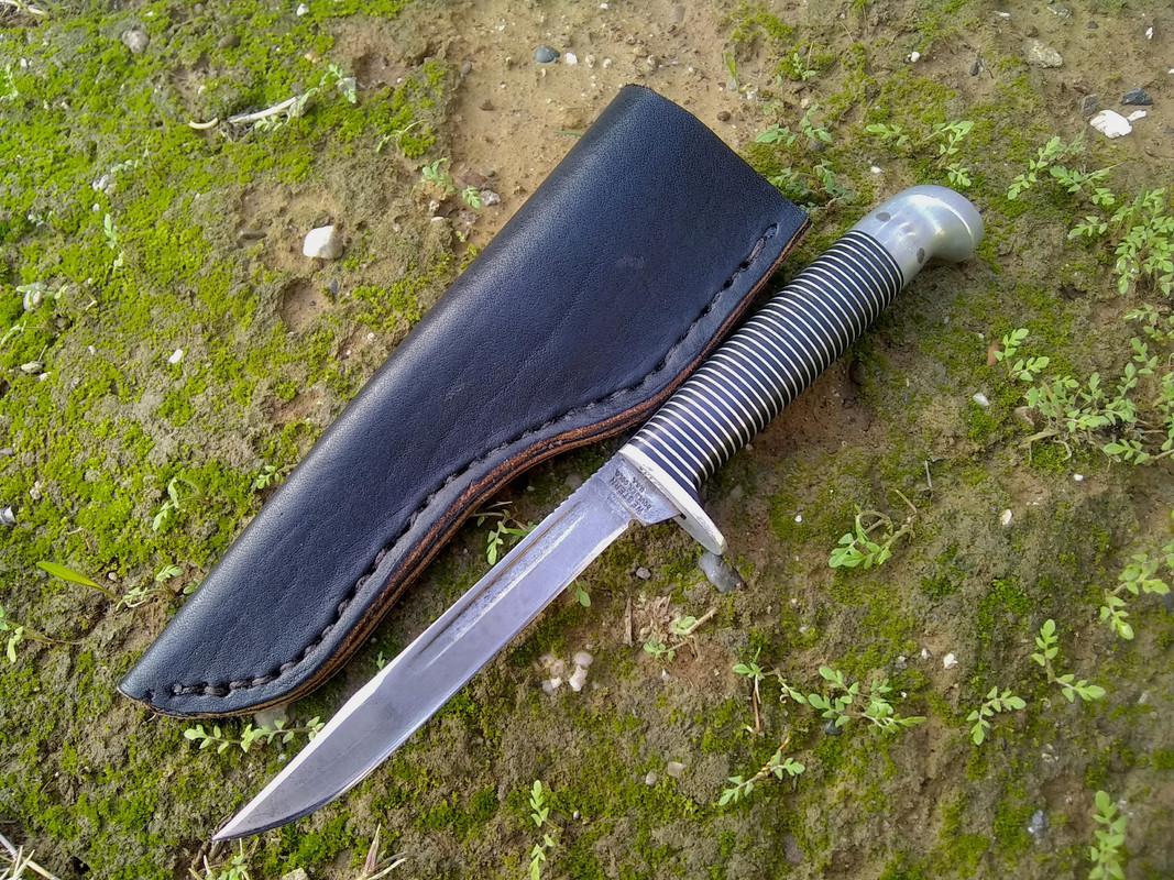

I've posted my f48a here before, but that picture is probably long gone and i made a new sheath for it today.
I looked for some yellowish waxed thread because I kind of wanted this to resemble it's original jet black sheath but. I couldn't find it so I just scrapped that idea and figured using black leather would be good enough.

I've posted my f48a here before, but that picture is probably long gone and i made a new shesth for it today.

Oh, the jumping was added by me a while ago.
The knife was given to me as a kid and was slightly bent and had some recurve to the edge.
I straightened it out and fixed the edge a couple years ago or so.
I love the knife but I have been looking to acquire a more attractive L48a or 648a in decent condition ( carbon blade of course )
As long as it's not damaged or over sharpened I'd be happy, I don't even need a sheath because I can and would need to make one lefty anyways.
It would be so much easier if I used eBay, but I don't.
