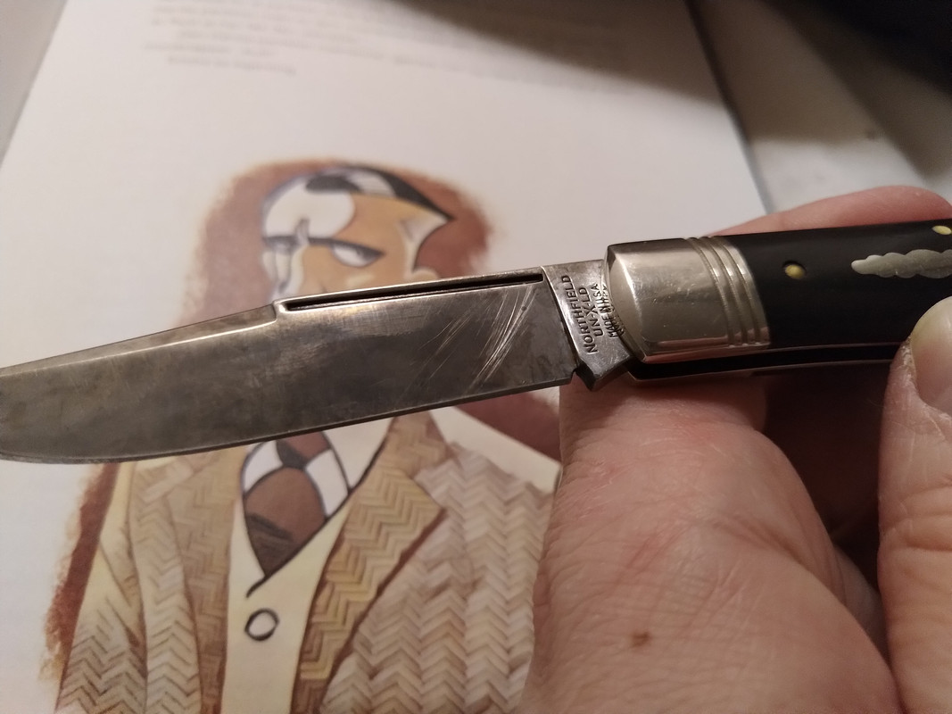

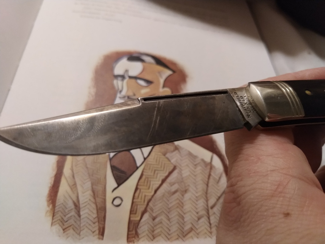

What grit sandpaper do you use to re-satin your GEC blades?
I bought this used and all is good and well, but those scratches are driving me nuts!
That is some nasty looking scratching, I suppose from incompetent sharpening of a previous owner?
The info is interesting but don't see how you can hold paper down to achieve this? o_O
A piece of wood, cardboard, a rubber sanding block etc. trick is to draw the blade consistently in a perpendicular fashion with even pressure. If the paper isn't glued to whatever you use, just hold it down on the side you are moving away from. I've re-finished a lot of blades, especially older Bucks with 440C steel. 320 is a good starting point, if the scratches are too deep for that then go down to 220 and back up through the grits till you are satisfied with the look. I have taken rust spots off of some GEC blades by working the paper tang to point, changing the direction of the sanded finish, they are users so it really didn't matter to me, I just wanted the rust gone. Sometimes I question my sanity on why these rust magnets appeal to me...
I have had great luck using a strop loaded with white compound. If a few strokes on the strop aren't doing the trick I'd start with 600 grit sandpaper on a hard surface, you could go lower grit but I'd definitely start with 600 to judge if lower grit is needed
