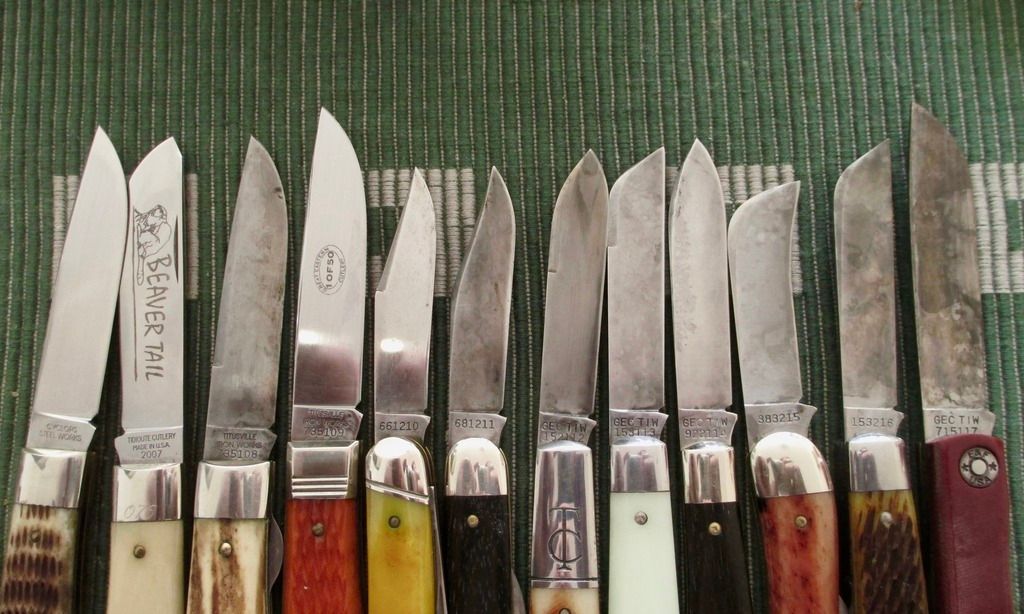

Am I the only one that would like to see a crocus finish as standard on northfield's? That was one of the ways manufacturers of old signaled that the knife was a premium offering and it would be most suitable (and nostalgic) on northfield's.
I'm not sure what your talking about (happens to me at times..). The Northfields almost always have a mirror finish that doesn't show the grind lines. Can you explain more, sounds like a learning opportunity for me.
It's a mirror finish on the front side of the main blade only, the rest of the blades and back side of the main blade are glazed (glazed is essentially the same as gec's satin finish)
Like Canal Street Cutlery used to do.
Glazing is done on a wooden wheel covered in walrus hide (skived, not butted), coated with either tallow and emery (English) or hide glue and emery (European).
It produces coarse parallel lines.
Crocus polish is the same as mirror polish (German: black polish). Crocus of iron is powdered iron oxide (rust), so-called because it looks like saffron, crocus pollen.
