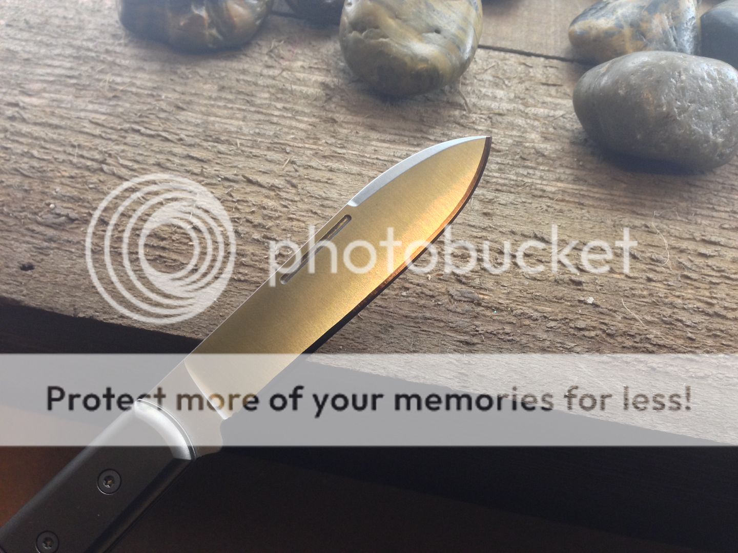

Wow that polish job looks amazing in my imagination and cuts like a laser to :) Apreciate the effort though and I know uploading pictures here with the new forum format can be challenging.
Took me a while but got it dialed in

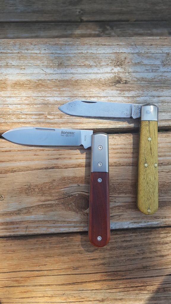

Here the mod done by I idahoguy

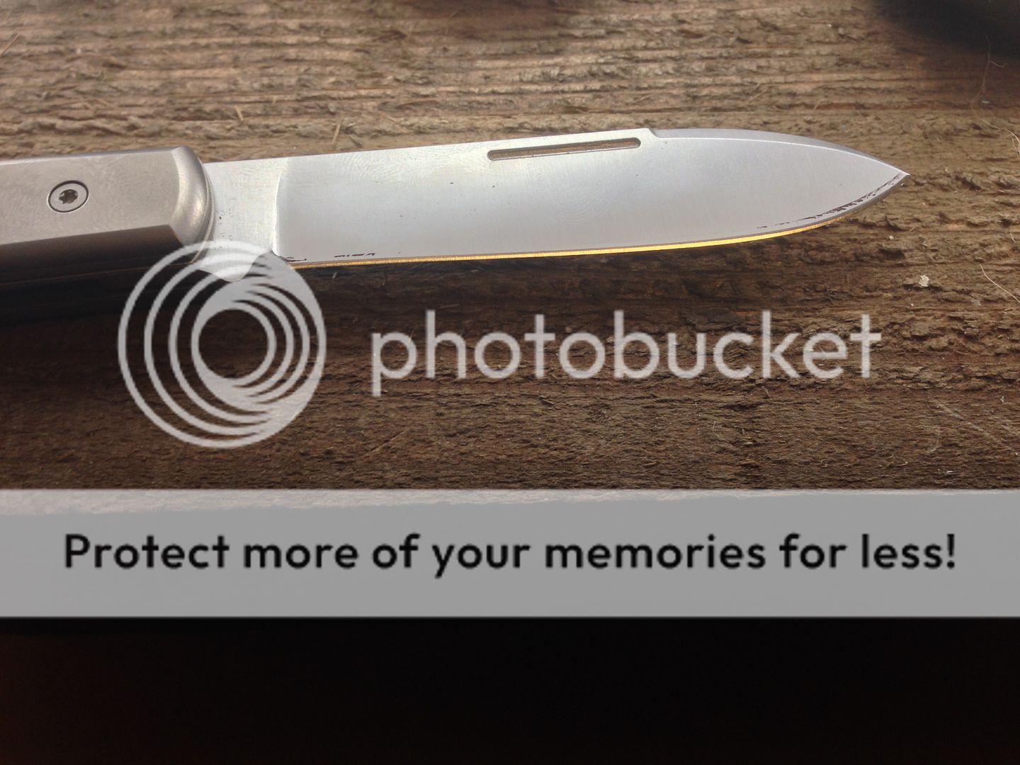

I re-profiled one of mine on a sharpmaker with the diamond rods to 30 degrees inclusive. Just wanted to give an idea of what it took with my meager skills.
After a half hour, going very slow, this is what the marker line looked like:

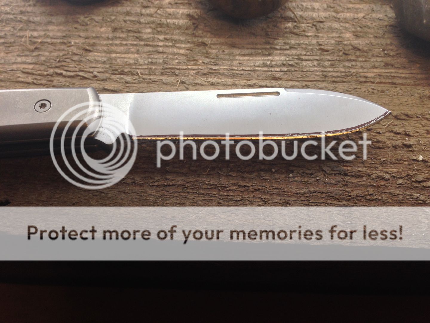

After another hour it was pretty clean, but would only pass the fingernail test:
I still need to finish it on the ceramic stones.
By contrast, I sharpened another on a 1x30 inch belt sander. That took about 10 minutes, going from 600, to 800, then 1000 grit belts, and finishing it on a leather belt with white stropping compound. I used a very light touch (and was really nervous), but it came out the sharpest knife I own. I would not recommend the belt sander on a knife this nice with my low level of skill, too easy to screw it up, but I think I got lucky.
