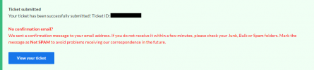

Good afternoon, in my second to last batch of 1000 eyelets I bought, I started noticing that eyelets would sometimes split on me, similar to what has happened to Robert in the sheath he is finishing on my pass-around knife. His post and pics here:
I had a few eyelets split on me also, but not very often, so I never thought to bring it up before.
But I also noticed that at least one out of maybe 20-30 eyelets seemed to have some kind of hardened residue, or anomaly inside the hole, which although small, was unsightly if one looked in close. I just got into the habit of looking for this, and tossing the eyelets if I found it in there. But it never amounted to very many, so I just assumed it was normal... I guess I am not very exacting.
But after Robert mentioned the splitting issue, and that he had contacted you about it, I figured it made sense to let you know as well. I am not seeking any compensation or anything, maybe just a reply about what this could be caused by.
But I mostly just want to let you know as one service provider to another, since if there was a way I could give better product and service, I would want to know as well.
Thanks for your time,
David
