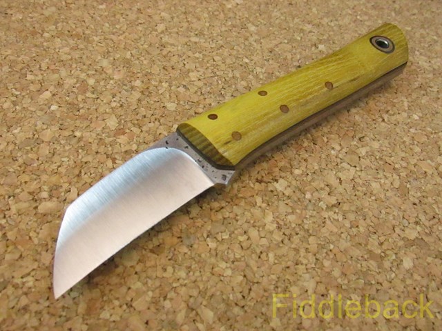

Knives-Like Tal says, best cutting tool is a razor knife. Been trying for years to make a blade that I liked and worked well for cutting leather. Haven't made it yet. Tandy sells a simple razor knife with good ergonomics, quick easy razor change and priced right. Just tried a Stanley Fat Max and sure liked the feel. The quick blade change feature didn't work well, so back to the Tandy.
Rick, I'm not sure if it's something you might consider, but I use a Cold Steel mini tuff lite to cut leather. They come very sharp from the factory, but I went ahead and reprofiled mine to around 25° inclusive. The thing is a machine at cutting leather (and carving wood). They go for around $25, and it's one of my very favorite knives.
I have that stretchy medical tape wrapped around the knife to make it more comfortable. I also rounded the spine, and chamfered the inner sharp edges of the jimping. Sweet leather knife.

Strigamort-Now that knife looks like it would sure work. I like the blade size and the ergonomics of the handle. Tough thing with most knife blades is getting the grind thin enough to cut leather well. I'm still planning to work on a couple more with that handle shape and get down tight on the grinder.
I wonder if a Fiddleback Carver in 3/32 or even 1/16 would work. Give it a distal taper, nice high grind and beefy handle.

Look for one of Andy's old Carvers. I would verify with him that they are ground well for the job (I don't own one... yet), but looks to me like they'd be great.

Edit- (don't want to clutter up the thread any more) thurin, yes, I do believe one of those would be excellent. I own a number of handmade carving knives and all (with the exception of hook knives) would make for wicked leather cutters. :)
