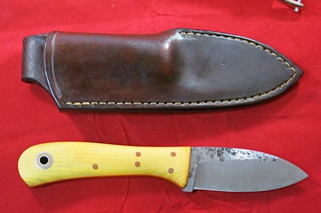

Thanks to Tal, and others, my FIRST sheath is done! Is it perfect? --not even close; there were times when I almost threw it away and started over, but I wanted to finish it as a learning exercise so that the next ones will be better.
I opted for a folded "butterfly" type sheath for this shape of knife, an EDC II, and am glad I did because it looks good with the leaf-shape blade.
I opted to use a so-called "Loveless Cam Lock" to keep the knife in, and wish I had not --it added a layer of complexity that I didn't need. Does it work? -oh Yeah! it works. Would the wet-molding have worked just as good without it? -probably yes. I'm not giving up and will try it again with more experimentation.
I pushed one hole when using the drill press, in the wrong place due to working at night in a poorly lit garage --lesson learned there, work in better light.

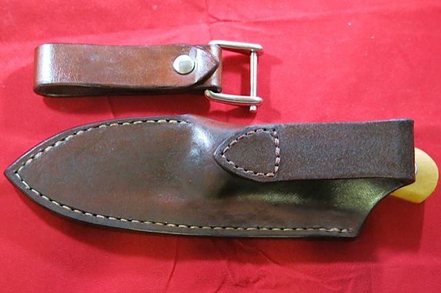

The dangler shown will not fit this sheath. It's a 1" dangler and the belt loop on the sheath is 1 1/8" because I cut it oversize and forgot to trim it to 1" at a later stage. I also ran the taper too high, resulting in almost an inch and a quarter where the dangler would go. I just did the dangler for the experience, but still.... another oops.
And... I bought 1/4" Chicago screw posts, way too short, need at least 3/8" screw posts for 3 thicknesses of leather, and this one could have used 1/2 inch screw posts due to thick leather; you can see the mark where I put it in the vise to squeeze it down so I could attach the screw post. I swear I read 1/4" somewhere, but 3/8" is needed, trust me.
My leather is too thick in my opinion at nearly 12/64ths. 8/64ths, or 1/8" would be better. A problem with mail-ordering a shoulder from Tandy. I'll try to get some better leather, but for now will skive the next one down to closer to 1/8" or 8 oz.
You will notice the belt loop stitching is brown thread and the rest is natural thread; just because the evening I was sewing I couldn't find the natural thread that I thought I had purchased, and didn't find until later.
I didn't notice until looking at the pictures that the stitch line is imperfect; but I think I can fix that with the overstitcher.
All in all, a fantastic experience that I would not have tackled without the video guidance of Tal, and others. I already have two more cut out, and I can't wait to get started. The next one will be twice as good. In the meantime, I have a bullet-proof sheath that will last a lifetime (I'm 68, so how long is that?).
Thanks, Tal.
ricsha - Nicely Done Bro! Thanks for sharing the details and the lessons learned. Very ambitious with the cam lock. I think it looks pretty awesome. Nice job burnishing.
It looks like Rick and My sheath had a baby! ;)
1) I don't see the stitch line problems you are talking about. This is common. You see a mistake and others don't.
2) There are no mistakes - there are only 'design modifications'. ;) I like the belt loop. I think as a belt sheath it will wear perfectly without the dangler.
3) In terms of quality. I am stunned at how well this turned out. Simply amazing. Everyone in this thread has made such great work the first time out.
A few things I see - and they are picks of nits.

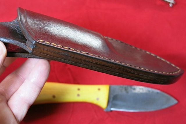

1) Leave another 1/16th on the outside of the sheath to sand off. You have a little uneveness between the layers. Sanding those flush would take care of that.
2) Watch out for things that will leave marks on your sheath. I see what I think is a fingernail mark on the middle. It matters little - it is just one of those things.
3) I would skive your welt further down to have an easier time of bending the leather at the point of connection.
4) What did you seal it with? It seems a little glossy. I think it looks great - and it may just be the flash - but if you used Tan Kote - did you put on quite a few layers?
Again - total nit picks. You managed to turn out something in your first try that looked like my work after two years. I am really proud of you and happy for your experience making this sheath. You are indeed correct - you have an heirloom quality sheath that honors the animal whose hide it was made from . Well done!

Thanks, Tal. High praise indeed. I don't know where that mark came from; I intentionally used a piece from the worst part of the shoulder for my "practice" sheath. Shine is too much; I'm not happy with it either --one coat of Tan-Kote followed by one thin coat of Montana Pitch Blend. How would I de-shine it a bit?

1) It is the pitch blend! No worries - you buffed the hell out of it didn't you? It is the bees wax. Just wear it - it will mellow.
I would use one or the other from here on out - but you didn't do any harm.
2) Buy a back or a half a back from a place like Wickett and Craig. You now have the tools to do mostly anything simply - like a possibles bag or journal over - or that sort of thing.
It will be about 100 bucks for a whole back (7-8 ounce veg tanned in Oak - then you can dye it anything you want) - but you will have something like 20 square feet. Enough for a FEW sheaths. ;)
Also a back has no belly leather and thus little waste.

A baby:eek: Well, it really is a very well done combo of both styles and I like it!
Like Tal said, if you'll really thin that welt at the bend point, the leather will fold much neater. I'm curious how wide your welt is? A more narrow welt on the butterfly style will reduce the slight bulge look on the spine.

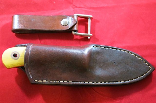

Attempt Number 2. I decided to try the pouch sheath this time and I made one for my Bushcrafter. Different process, but some things went a little smoother this time just because I already done it once. Still not perfect, and I think some of that will be easier with better leather. I just bought the Tandy on sale stuff and it pretty rough. It will be fun to make a few more for my family members. My wife has actually started one for her Arete. Here is #2:
With #1
Also, while I was shopping online for the things I needed to make sheaths, I came across a place that makes custom stamps for $40. I had the emblem we use on our family ranch gates made into a stamp and it has a nice spot for initials so I can personalize each one I make. Getting the little 1/8" letters straight is damn near impossible, but I don't think those getting free sheaths will care much.

I'm really liking what you did with that one, too. I've been too busy to start #2 yet, but you give me inspiration to get going. I thought you were dying them black, but now I'm seeing more of a dark burgandy; what is it? Nice job!
