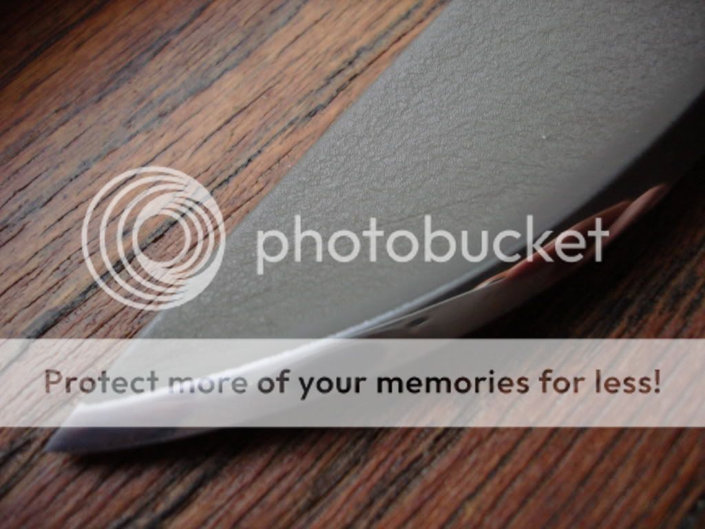

meaning of a mirror edge
That is one far-out razor! :eek::thumbup:
How are you all achieving your mirror edges?
My technique is 600 grit to 1000 grit to 2000 sandpaper on a piece of glass, then to a 6000 grit King Waterstone to a strop loaded with green compound.

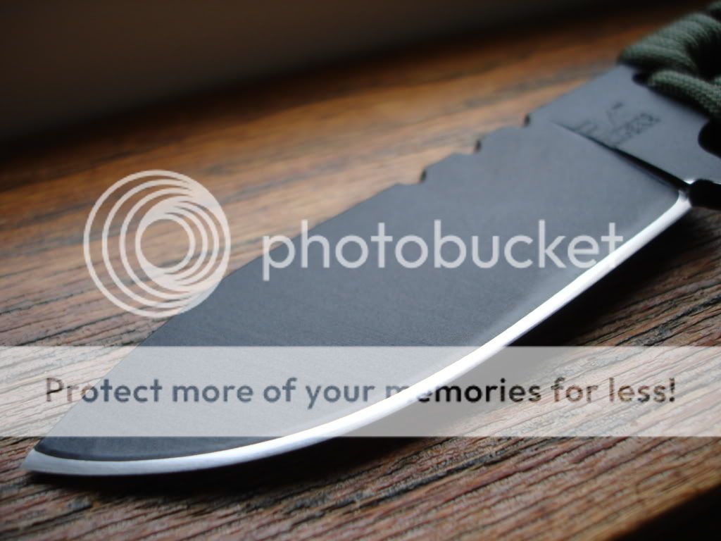

I've been working on getting mirror edges with sandpaper and strop. Never had a chance to try diamond paste yet, but it sounds interesting. Here are a few edges I've done recently...

Looks good. Here's one I did up yesterday:
I brought the convex polish all the way up the tip of the grind. This was done with an 8k waterstone and 100k diamond powder.
