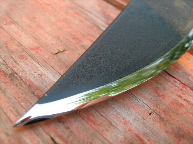

meaning of a mirror edge

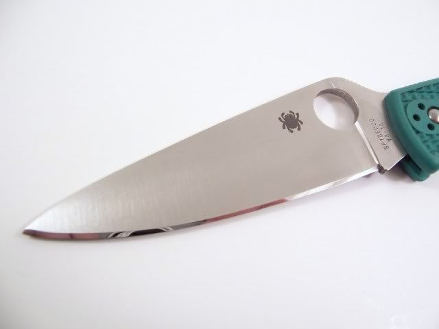

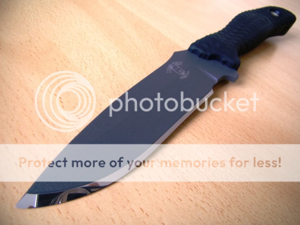

I tried my Skyline first, but the edge grinds are pretty darn thin on it so there isn't a lot to see. But it was enough to show me that I wasn't damaging anything, so I moved on to the knife I really wanted to polish, my brand new Blur (just arrived TODAY) :d

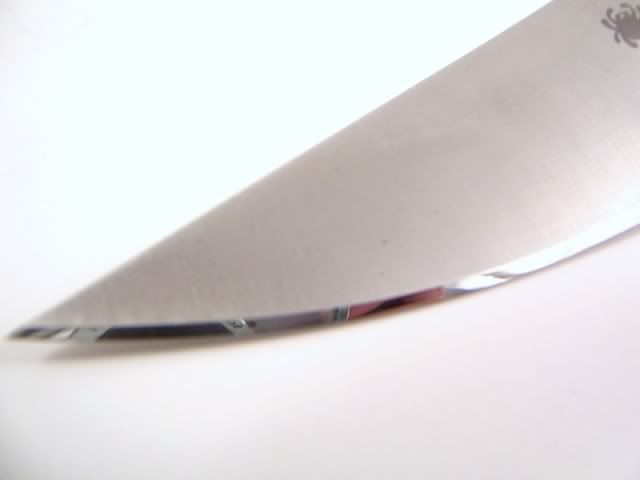

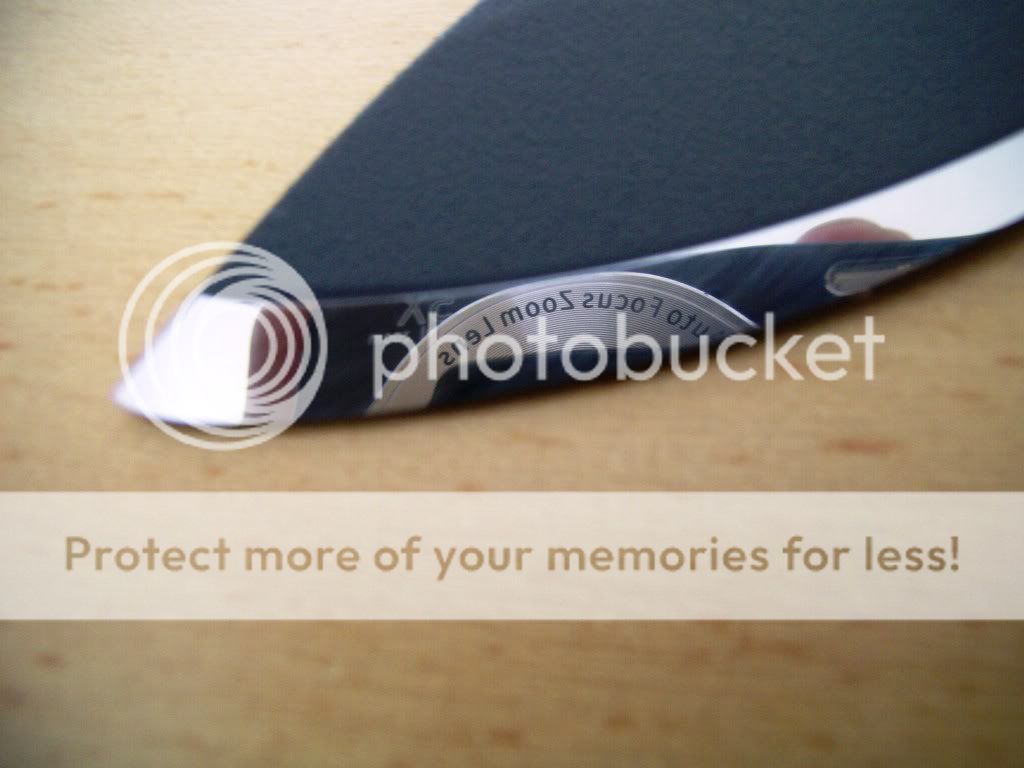

Well I gave it a try, my problem was that I kept cutting through the sandpaper. Even 2000 grit wasn't enough to get it mirror like, so I grabbed a piece of cardboard and some mag wheel polish and gave stropping a try.
It actually came out pretty darn good. I probably shouldn't have tried on a recurve right away, but the Blur is fairly mild in that regard.
I got most of it pretty darn shiny, but I'll have to work on the curved part some more, I need something round to wrap with sandpaper, maybe a paper towel roll.

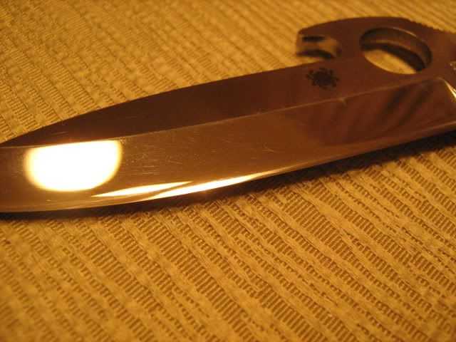

I was going to save these for another thread but I figured what the he :D
DING DING DING, we have a winner...GOOD LORD.
kwackster you truly do know the mirror edge . thanks for all the great pics & the inspiration. dennis. a hearty thanks to everyone for all this great participation.

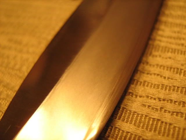

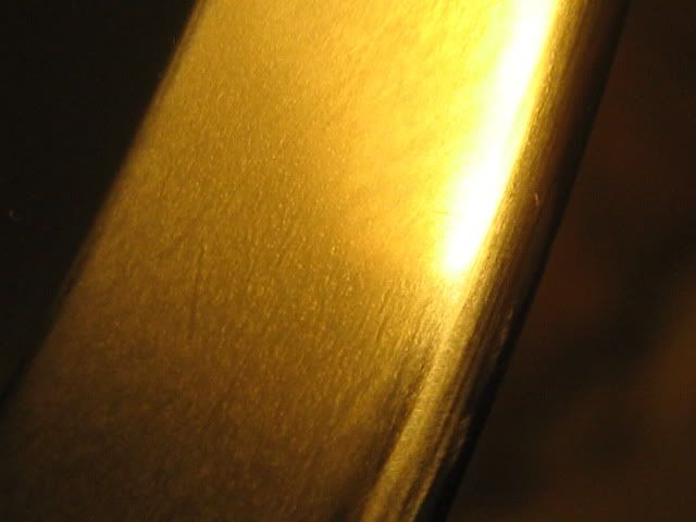

this old 06 hunter polished up quite a bit with cardboard & green paste. beginners can achive initial results with primitive means, however the results are fairly primitive as well. thanks guys dennis your pics & blades are truly increadible.

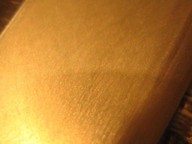

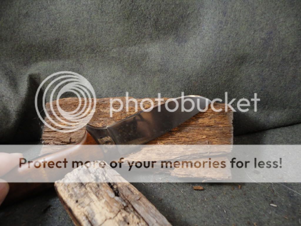

Finished reprofiling my Demko AD10 to about 26 degrees inclusive. :D
Its a work in progress but turning out better with time.
Full convex to top of saber, all by hand on water stones with a final finish on a 1 micron balsa strop to bring out the flaws. It was a test run and I wanted to test the skillz :D
It was OK but I wanted to see if I could get a Kasumi finish with my natural stone. The result is not bad and brought out a near damascus grain to the VG-10. The stone is only a 8-10k grit so on the curve of the edge the scratch pattern shows.
