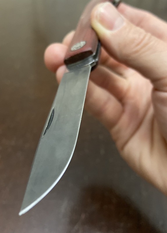

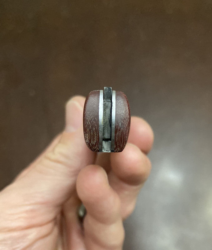

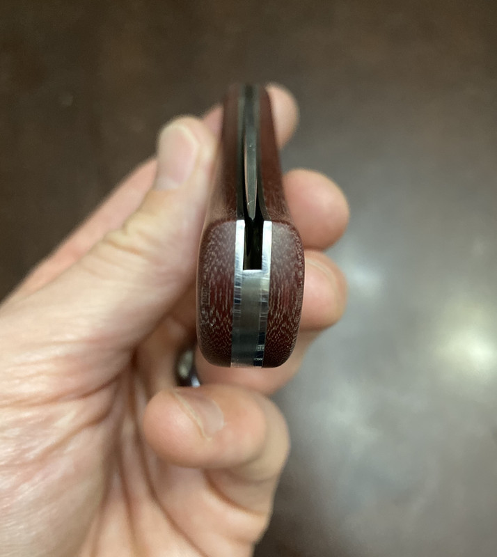

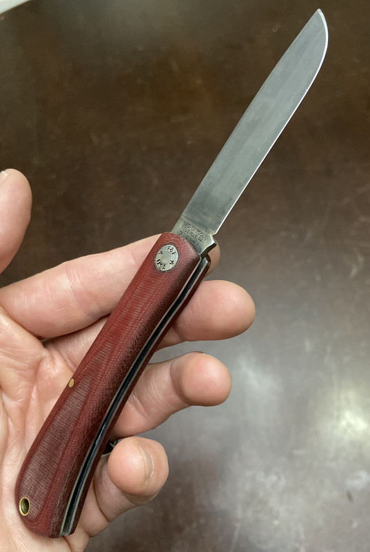

Looks good. I’ve wanted to do that to mine but haven’t had enough courage to do it yet.It's been awhile, but I figured a project post would be a good way to dip back into the waters. I recently bought a GEC 71 in O1 Tool Steel of the Exchange for a nice deal due to the patina and used quality of the knife. I have wanted to try 01 for awhile, and I have also wanted to try slimming down a 71 because I really like the sodbuster style knife, but am not a big fan of the chunkier and squarish handle. I'm working without any machines--just pieces of sandpaper from a wide variety of grits--so it took me quite awhile just to get the material to the point I have it currently. I may go for more eventually, but I think I've hit a pretty good compromise between "work knife" thickness and "contoured" feel. I forgot to protect the blade at first and got some pretty deep scratches, so I hand to sandpaper it through several grits and then did a vinegar patina just to give it a more even look. Oiled the joint, ren-waxed the micarta, and sharpened the edge to finish it off. Enough talk:

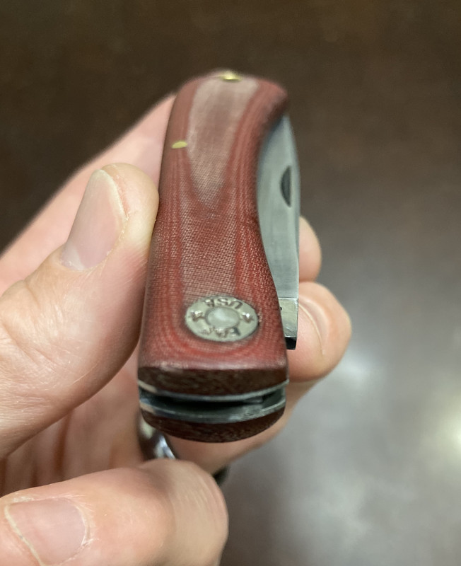

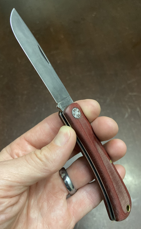

Wanted to add a couple (not so great) photos. I still want to work on smoothing out the area around the birdseye pivot.
The new rounded version is a pleasure to hold and seems to melt into my pocket, but having rather large hands I wonder if the more robust stock scales might be better for extended use for me. At some point I'd like to try this on a #21 Bull Buster.
