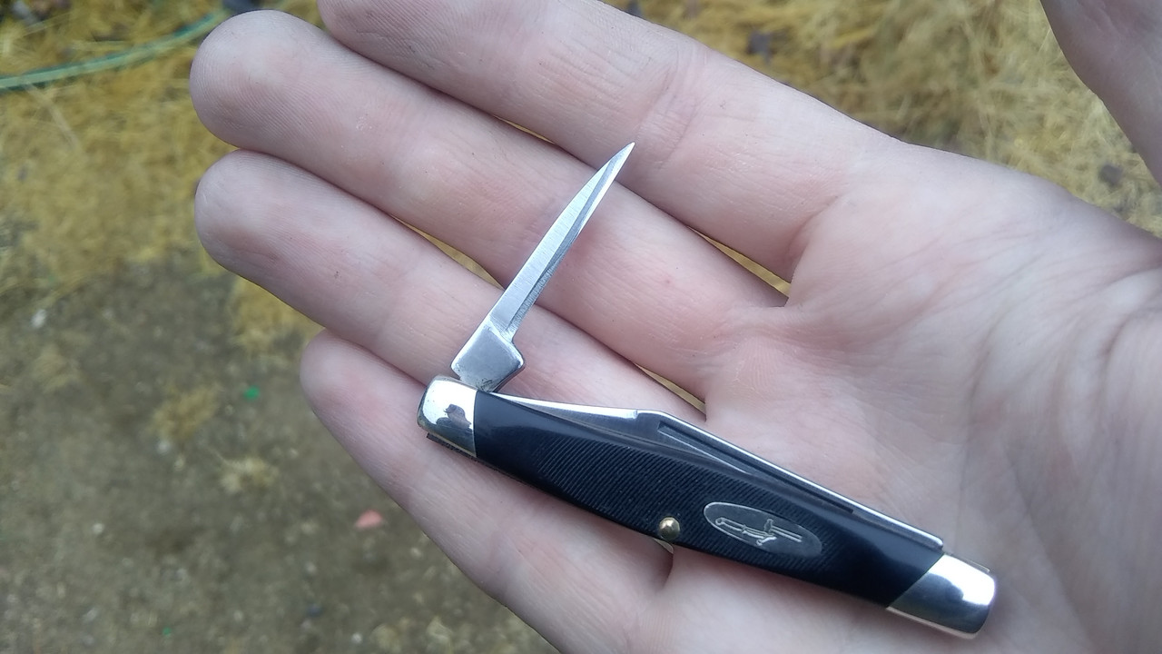

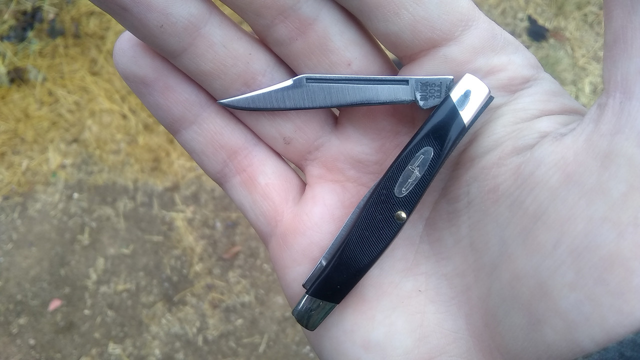

Nothing as good as you fine folks do but here's a mod / salvage I just finished on an old Buck 305 that came in the mail today.
Let's just say the coping blade was worse for wear, so I turned it into a little awl.
This should make a handy little package, the little awl being great for all kinds of things.
Shoot... that's a great job on making an awl. Should be handy to have along...
Looks great.

The only show I remember from that time frame, that spent any time in a garage, was "Home Improvement"...
