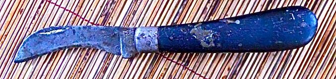

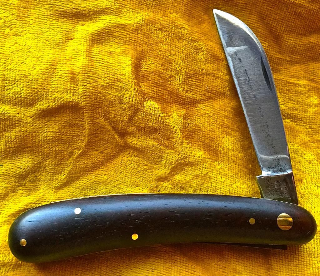

This first one is an old IXL George Wostenholm. The old ebony handle was gorgeous and the blade was solid, with a great fit and finish. The blade was badly sharpened, however, and I decided to modify it into a big sheepsfoot and clean it up really nice. It is a super sweet knife now.
Before:
After:
