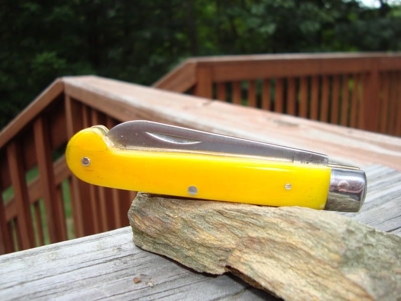

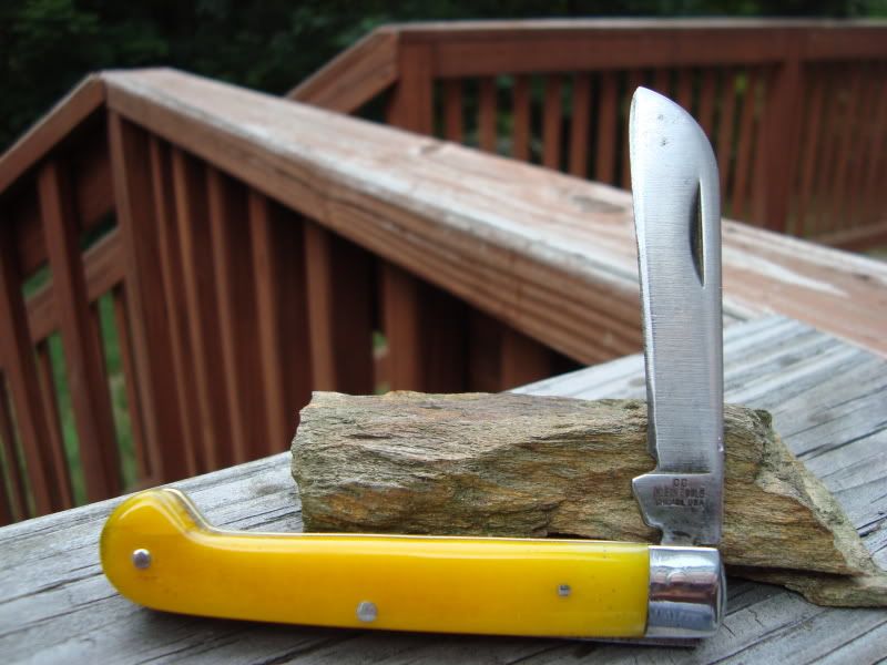

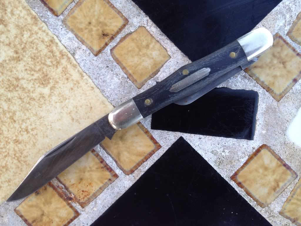

I haven't had a chance to post the new Remington barlow Bob did for me. I got it a couple weeks ago, and am very happy with it. It has a big gap on the right side, enough to slide a piece of paper in, between the spring and the liner. I am debating on whether to send it back to him, but everything else looks great. I think it is just going to affect my OCD, not the knife itself.
Here it is before...
[/IMG]
And after pics from Bob

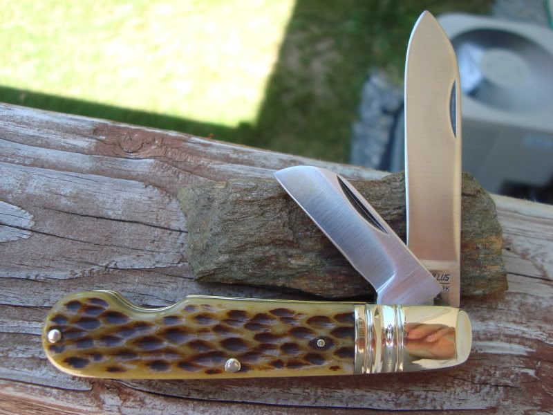

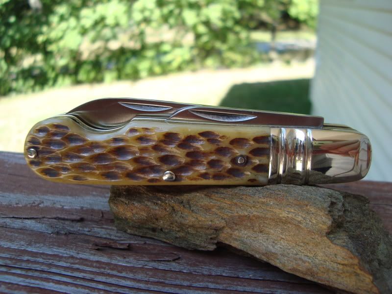

Here is my latest out of the shop.
TL-29 redo, elongated NS bolsters, reprofiled screwdriver blade, EO notch, some bolster filework. Covers are Antique green pick bone. Wish I had made this for myself, LOL!
Glenn

VERY COOL
nice jigged bone
and repurposed screwdriver ...is the sheepsfoot still locking?

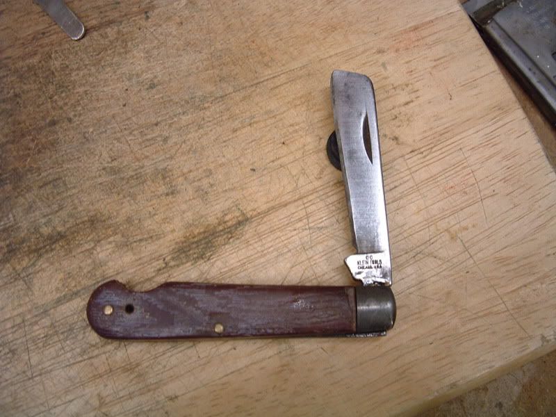

glennbad any before pics? I'm realy liking that ans would like to see if I could manage something similar...

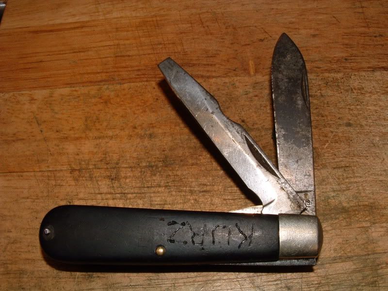

Sadly, no. I usually take a before shot. In this case, it started out as a standard TL-29, like this one...
The pattern is good to work with, because so many of them have been made. And for the most part, parts are somewhat interchangeable between manufacturers. You don't really need any specialty tools, alot of the work can be done with files and sandpaper and hard work. Of course, it's helpful to have brass/NS pins and bar stock, but I have also seen people get quite creative with materials they have on hand, like copper, finish nails, etc.
RSmith_77 - No the sheep is not locking. It's got a pretty stout spring however. Alot of my customers usually want the liner lock removed. That is up to them.
Glenn

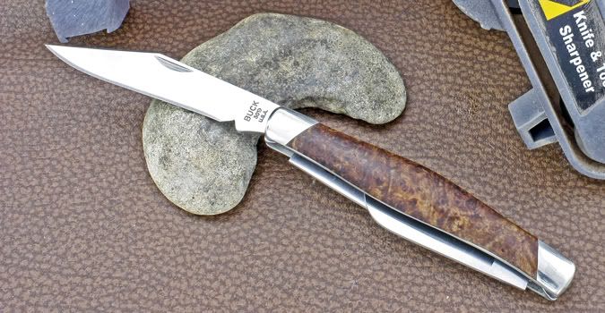

Here's an un-planned mod on a Buck 701. The main spring let go while I was cleaning it, so I had nothing to loose by pulling it apart to see what I could save. A two well three blade became a one well two blade. Main got ground into a wharnie so the two blades would fit together riding on a single spring.
Nice save on that Buck! Bet that rides nice and slim in the pocket now.
