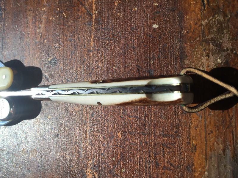

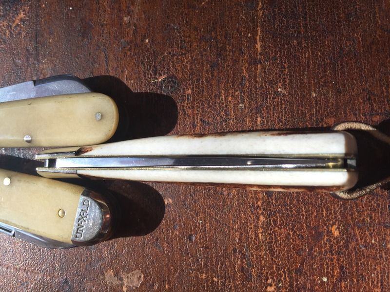

Various handle filing and sanding on GEC jigged/scratted bone knives:
#15 Huckleberry Boy's Knife (rust red)
#15 TC Ancient (scratted parchment / already posted in the barlow thread under my former name)
#25 Little Jack (orange)
#85 Bullet End Jack (green briar)
Some Schrade and Schrade Walden 3 7/8" stockman an old stand by. Old piece of pre ban ivory, stag, and Westinghouse micarta.
Happy New Year and hope all enjoy the pics.
Harold

I really like how that boys knife turned out. Can you give more information about how you did this?
Thanks, LR.
The more handle material was removed, the more the colour disappeared and went into light orange (almost white on some parts).
I used a file and sanding grip (120, 400, 1000). Finish with fine micromesh and wobbling (if you have), then oil it.
But beware: I put the Boys Knife to the limit, two of the rivets became loose during the whole process.
(I made these flat with a thin tong pressed together bench vise, and fixed them for sure with some drips of thin super glue.)

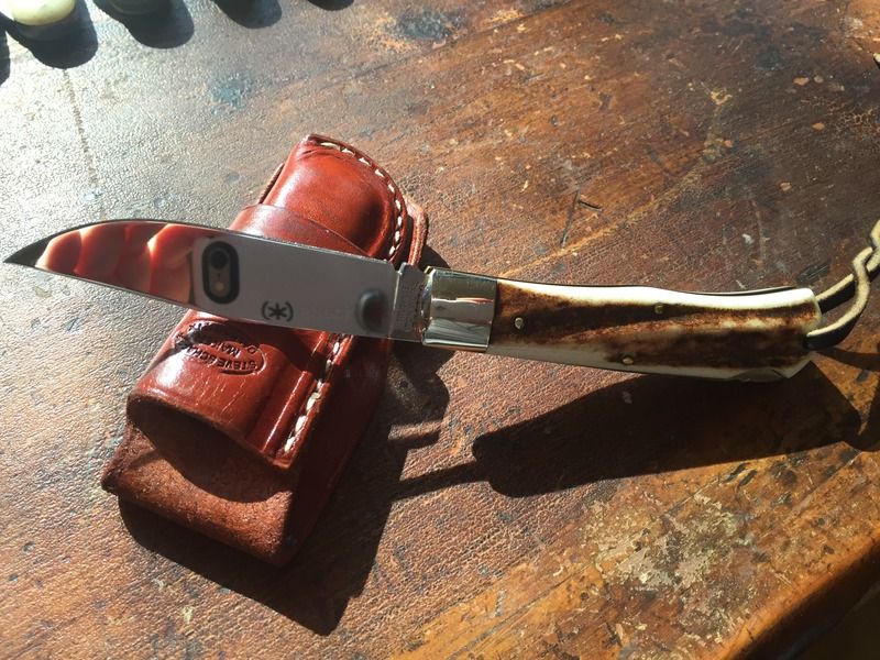

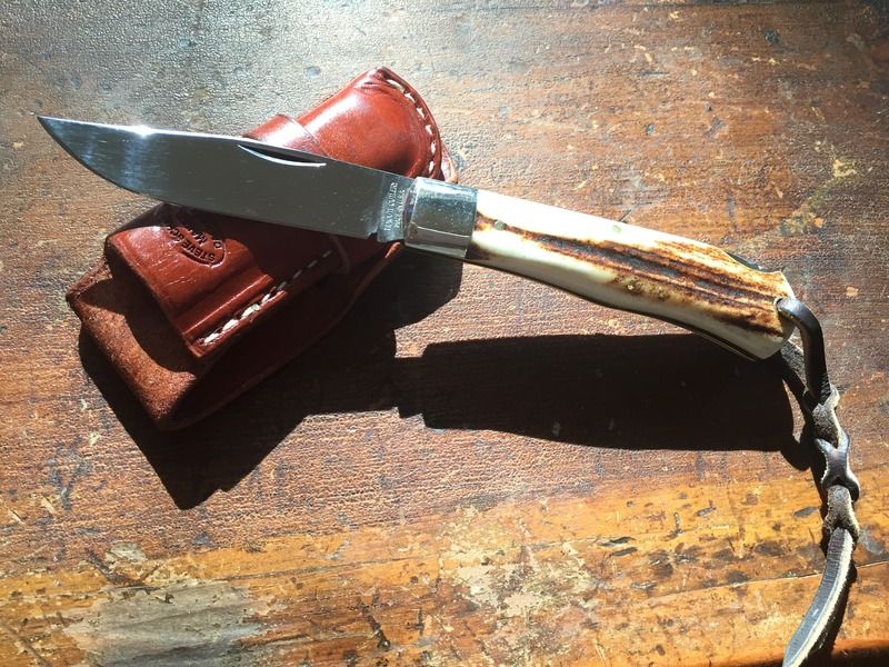

So, a year later, I finally rescued the old Pal electricians knife that I tore down. It is now a single blade with bocote covers

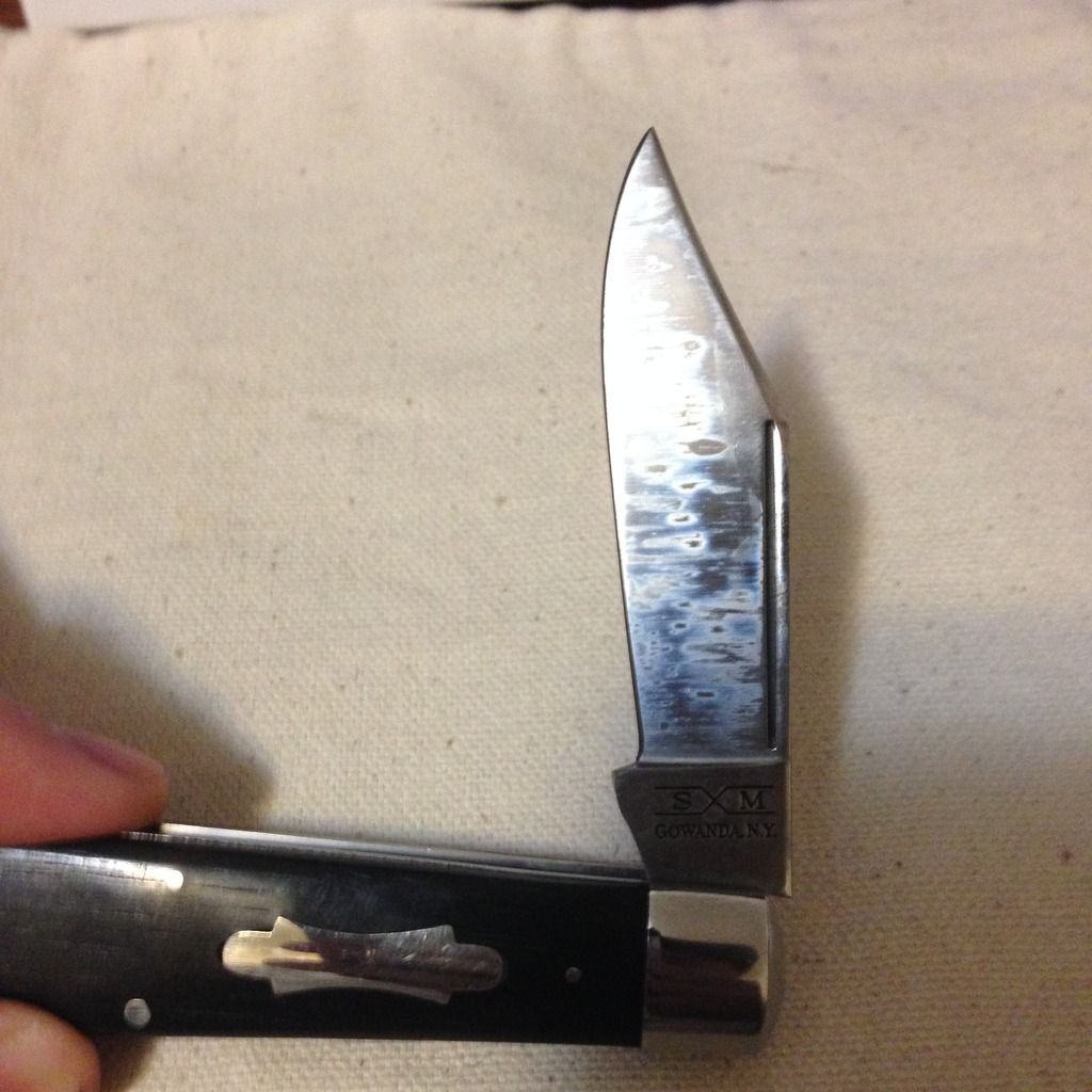

And an old Case sodbuster with homemade blue burlap mycarta
I added a half stop to this little guy. It's one of my favorites now. Nice and slim in the pocket
Looks like a true classic swell-end now, great work! You should stamp the pile side of the blade or something like that, a Bighaze custom. :D Also enjoy seeing that soddie again. :thumbup:
Hmm. A custom stamp. Not a bad idea. 😀 Thanks, this little soddie was almost discarded but I kept at it and got it working like brand new. I'm glad I kept it

I posted at the top of this page some pictures and just want to shout out a little supplement/warning.
I did this sanding technique again on an #25 Amber Jigged Bone, but definitely took off too much material.
Two of the rivets got so loose, that between handle and frame a little gap became visible.
The only thing I could do, was to take these out...
Do You think I just can replace the rivets and get everything tight?
I've never done this before...:confused:
(Unfortunately I also broke the edge of the bone. Pretty annoying for an unused knife:grumpy:)
In spite of everything, I really like the color/jigging of the handles...:D
Yes, that is possible, but peening does create stress at those holes. I would be especially careful around that broken piece. I assume you are going to glue that back into place first. I also assume that you are going to get some new brass pin stock, as I don't think the pins may be long enough to spread adequately anymore. Once you have that material, I would then create a head on one side of the pin material and use that on the broken side, so that the peened head is already made/started. Then go super nice and easy, with slow light taps with the lightest head hammer you have. Peen the pins with a solid metal surface underneath for support, like a bench vise.
