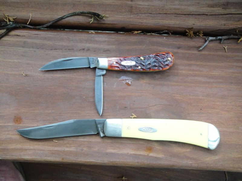

In the barlow thread, I thought it was a wharncliff, but now that you called it a slim Zulu, I see it. Even better Mark. Very nice. :thumbup:

How would you go about "refreshing" the jigged bone on an older knife? I want to darken it up a bit.

Thanks for the heads up. I appreciate it a lot.Lots of different dyes would work. Leather dye, furniture stain, potassium permagnate, RIT dye...
Just make sure to wash it really well before and after. You want to get all of the oils off the surface before dying so it takes evenly, and afterwards you want to get the leftover dye off the surface so it doesn't rub off on your hands or pockets. Then finish it off with some mineral oil or something similar.
Agreed. Nice clean work. :thumbup:You did a great job on your EO notch:thumbup:![]()
Read the last line of his post Tim.Looks great cairndude Did you re-dye the ground down bone at all with a stain maker or tea?
I can post it, but not here. It needs to go into another subforum; Maintenance, Tinkering, and embellishments. I use a different method, but the short answer is a Dremel with a sanding drum.Biscuit, great work! Can you explain how you did this and with what tools? Thanks!
