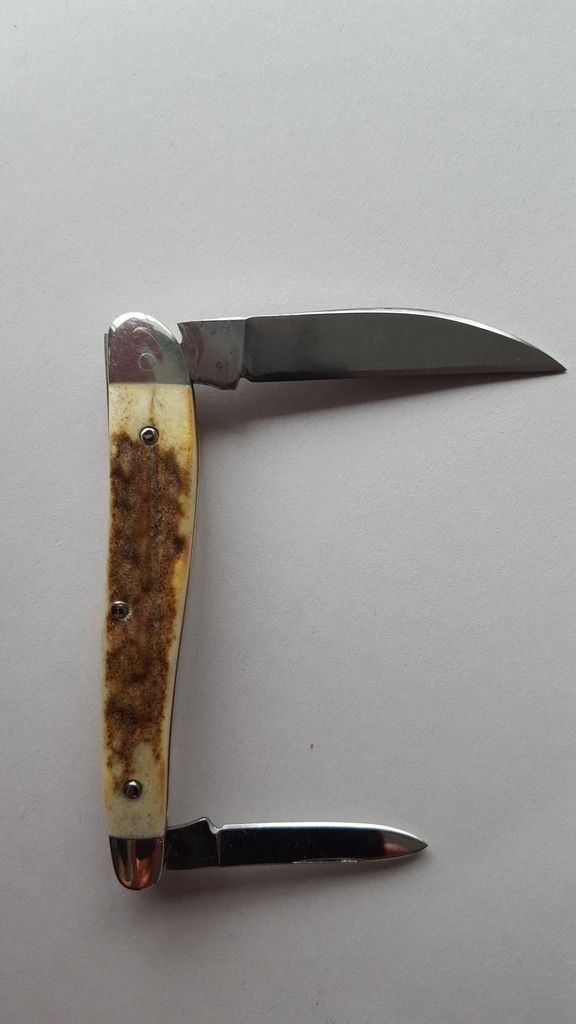

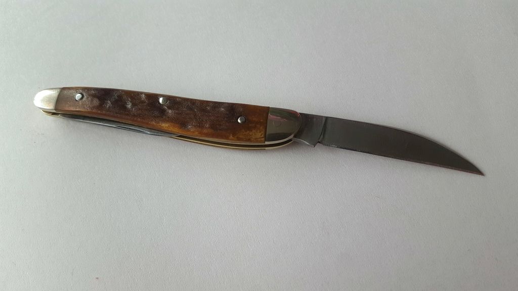

This afternoon I was looking at my Queen half whittler. It's seen very little use due to the wavy, butter knife grind. I also don't like the mismatched stag...

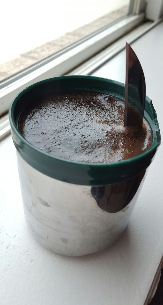

So I let it soak in a coffee spa for a while,

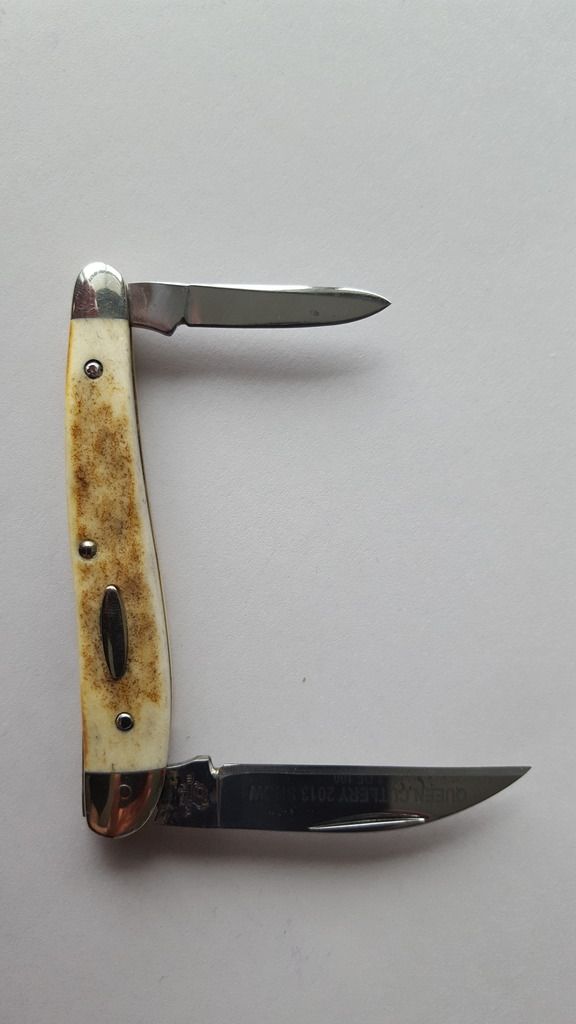

Then busted out the sandpaper, and went from 100 grit down to 600. Nice, thin, even grind on both blades, and the stag came out pretty nice too!
Nice job! It's very satisfying to fix up these old knives and give them the love they deserve

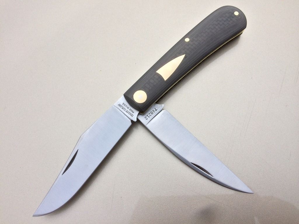

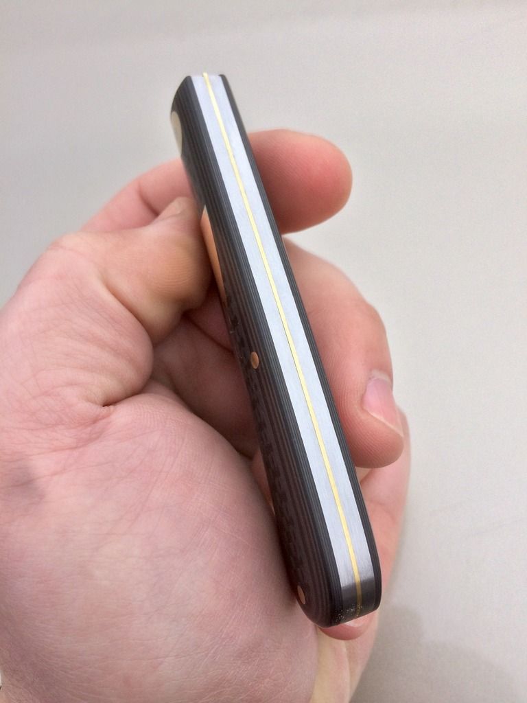

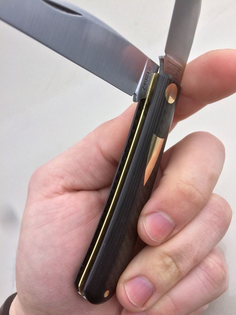

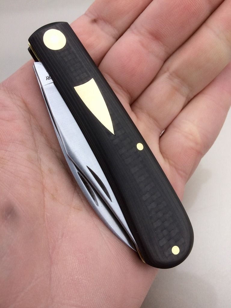

Turned my Coffee House Acrylic 74 into a linerless CF shadow Wharncliffe Trapper. Also my first go at a shield. Shield, birdseye pivot, and pins are all brass (pivot pin is NS). Very happy with how it turned out! Much thinner and lighter now, feels great in hand and in pocket.

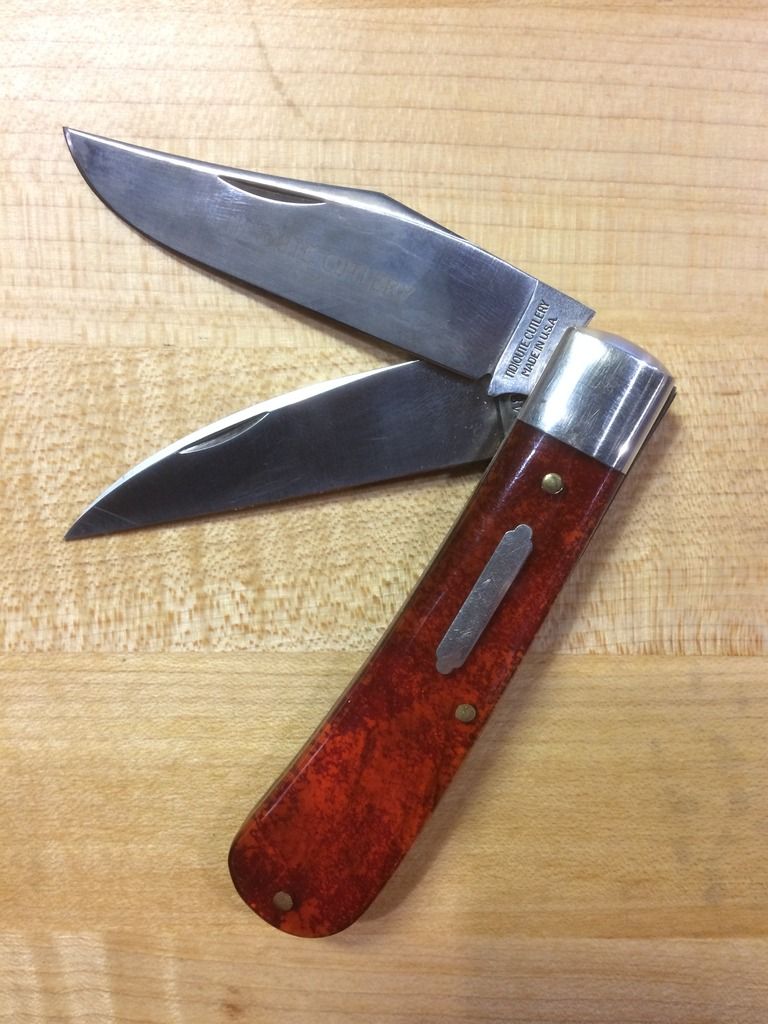

Almost done with this 29. Still needs an easy open notch. Carbon steel blade will take a nice patina.
Ben, the Coffee House Acrylic 74s are fine knives while your Linerless Shadow CF... it's in a league all it's own!!!
Just outstanding Sir!!!
Ice Tigre - I really like what you did on that Muskrat. Major improvement, IMHO.
Thank you Sir!
The industry is really short on options for knives with this combo, just two blades sheep's foot or wharny with a large clip.. Ill never ubderstand why since it's always so popular for modified knives.
Boy, Howdy!! That stag sure came out a fantastic color, congrats!
