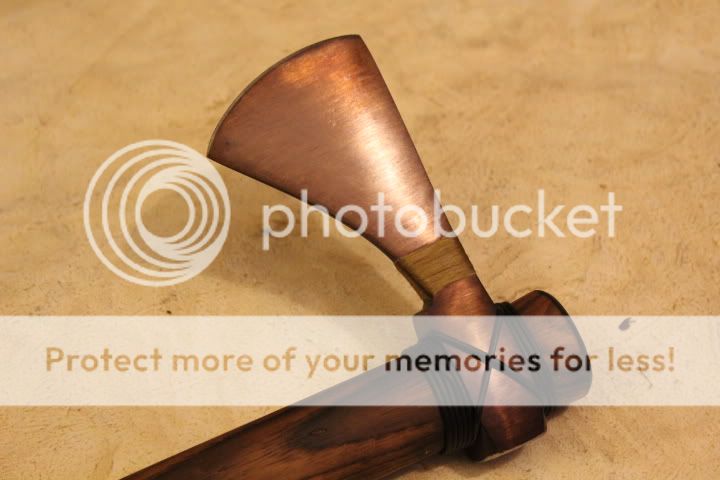

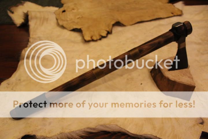

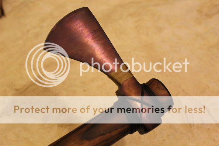

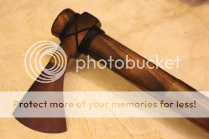

just a pipe hawk i removed the "pipe" from (needed a hammer, liked the way the frontier throws). but i've been messing around with these temper colors lately. pretty looking, pretty fun. some come out a nice "peacock" blue (higher temper tempurature than the brown/copper). from what i understand, blue would be "too soft" for a knife and about as soft as you'd wanna go on a hawk. and the brown/copper, being a little "harder" than blue. both being acceptable for a hawk. anyway, this finish wont hold up long to use but, its fun, and looks pretty (and i had to temper them anyway). they'd be easy to polish up/remove temper color coating when needed and just cold blue later or something. s'pretty while it last, get alot of different color "play" depending on light. be real nice for "collector pieces" that just hang on walls.
I like that PF. . .I particularly like the wrap around the base of the blade and the nicely spaced wraps on the handle. . .
. . .got a link for this color temper stuff?
nah, im sad to say, i think i learned more on wiki about tempering colors than i did here.
i usually put some kind of wrap on most of my hawks (fake sinew/real leather i use alot), in case you need cordage for something.
I must have misunderstood PF. . .I thought you were using a chemical treatment and heat to achieve the colors. . .I didn't realize you were just tempering the blade. . .
. . .I have color charts for the color and have color tempered a few knives for cosmetic reasons. . .thanks!

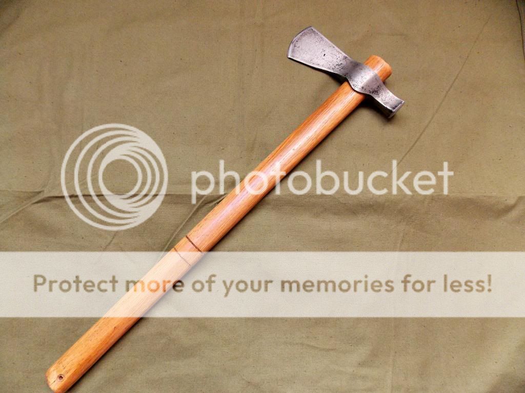

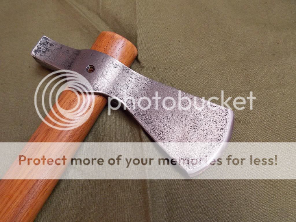

Well here's my contribution. Ditched the set screw, worked on the handle fit a little, and took some 100 grit sandpaper to the shiny coating so it doesn't look so lame. Finally, sharpened it up. Might thin out the edge a little more but it's leaps and bounds better than the factory edge. I think I'm going to shorten the handle a little, I'm going to actually try it out before I do that though.
