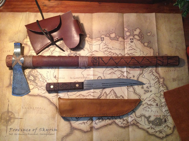

First off, I'd like to thank everyone who's posted on this board for all the great tips and inspiration. This is the first time I've tried to do anything like this, and I have to say I'm pleased with the way it turned out.
I've seen this thread at least a hundred times, and each time I did I thought "I really need to do that!" I'm a huge tomahawk and knife fanatic, so after modding my own pair, I've gone ahead and registered here. Love all the different hawks and designs I've seen! Good to know I'm not the only person over-obsessed with sharp pointy things.

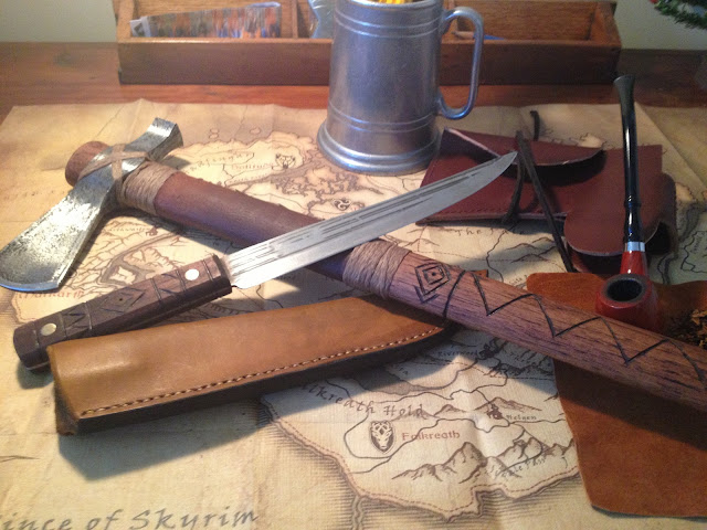

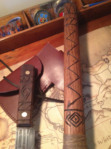

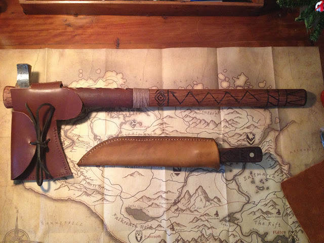

ANYWAY. Here's my customized Trail Hawk and Old Hickory Slicer knife. Both were given custom stains, custom engravings were done via my hand dremel (what a useful tool!), and the wrap is simply some craft leather and sinew. For now, I've only sanded the paint off on the hawk head; I like the rough, forged look by not cleaning it entirely of paint, so I've left it as is. I may at some later point decide to cold blue the head if I get tired of how it looks now, but we'll see.
Also got a couple of custom leather sheaths for the pair. Not too bad, nothing fancy (yet). The thing I like about them the most is that, despite all my modifications to them, they still function great as actual tools. Took em camping several times, had no issues.
You all will have to forgive the cheesy map underneath. It's the only "Weathered map" that I could find. Seemed to fit the theme, hehehe.

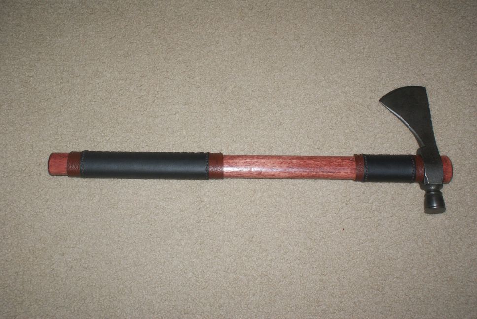

Spike hawk... Gave it to my nephew for Christmas

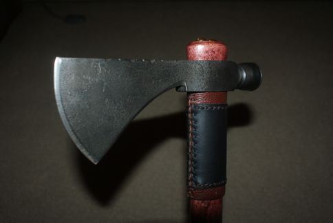

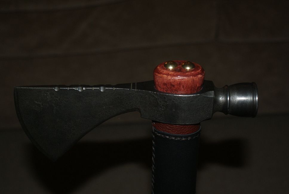

Sanded head to 600 then gave it a brushed look using green pad, cold blued, screwed up pewter inlay where screw hole was. Had my initials etched on other side of screw hole but pics don't show very well... Handle sanded down to 600, BLO with wax finish and blued metal caps, waxed leather wrap.

Where is everyone getting the brass looking tacks they're putting on the ends of their handles? Couldn't find anything similar at the local craft store...
