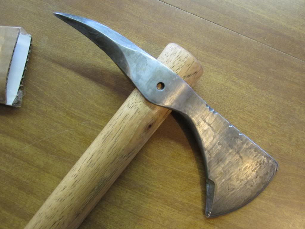

this is mine:
I kept it simple, not just because I have little skill in doing mod's but because I'd cry if I spent hours making it pretty then making fugly in one day out in the rough! :D
I done the usual removale of the grub screw and clean up up of the inner parts and edge, then removed the paint and went over it with a flap disc on the angle grinder (did the same on the edge) and then used it at work to let it form its own patina/mess! :p
For such a small, light weight tool it certainly cuts well, infact it spit out those chips like a bulimic!

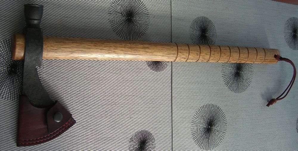

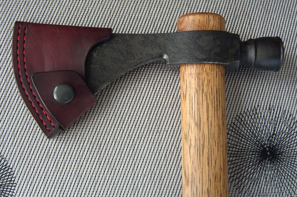

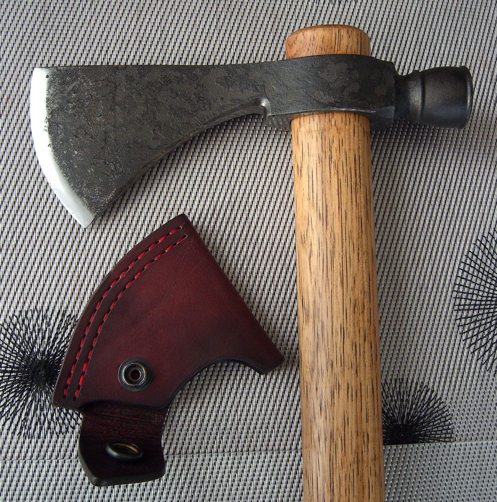

Hello,
I refinished my Cold Steel Pipe Hawk and made a leather sheath for it.
I cut grooves in the handle every inch to be used as a quick ruler and to give it a little more grip. Added a copper lanyard tube and stained and finished with Danish Oil and furniture wax.
I tried to get a rust-blue finish on the hawk head, but the rusting didn't take good and ended up pretty rough and uneven.
It sharpens up quickly and gets razor sharp.

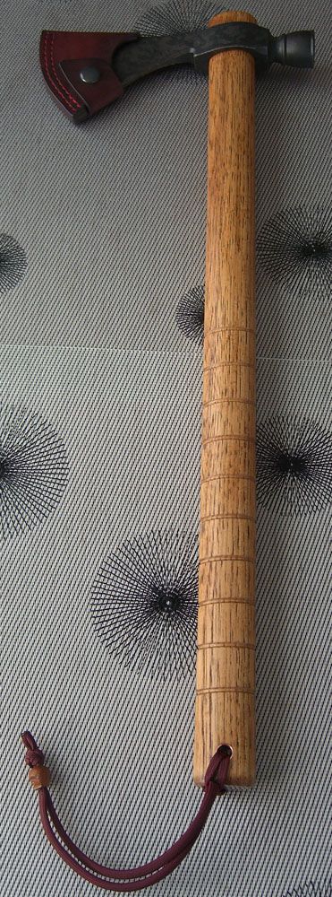

Hello,
Nice stuff here, I like the ruler Idea, gonna try that. Some file work on the head will really make it special, I have a feeling you have the chops to pull it off too.

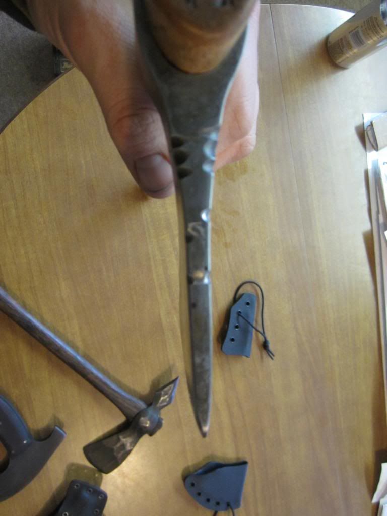

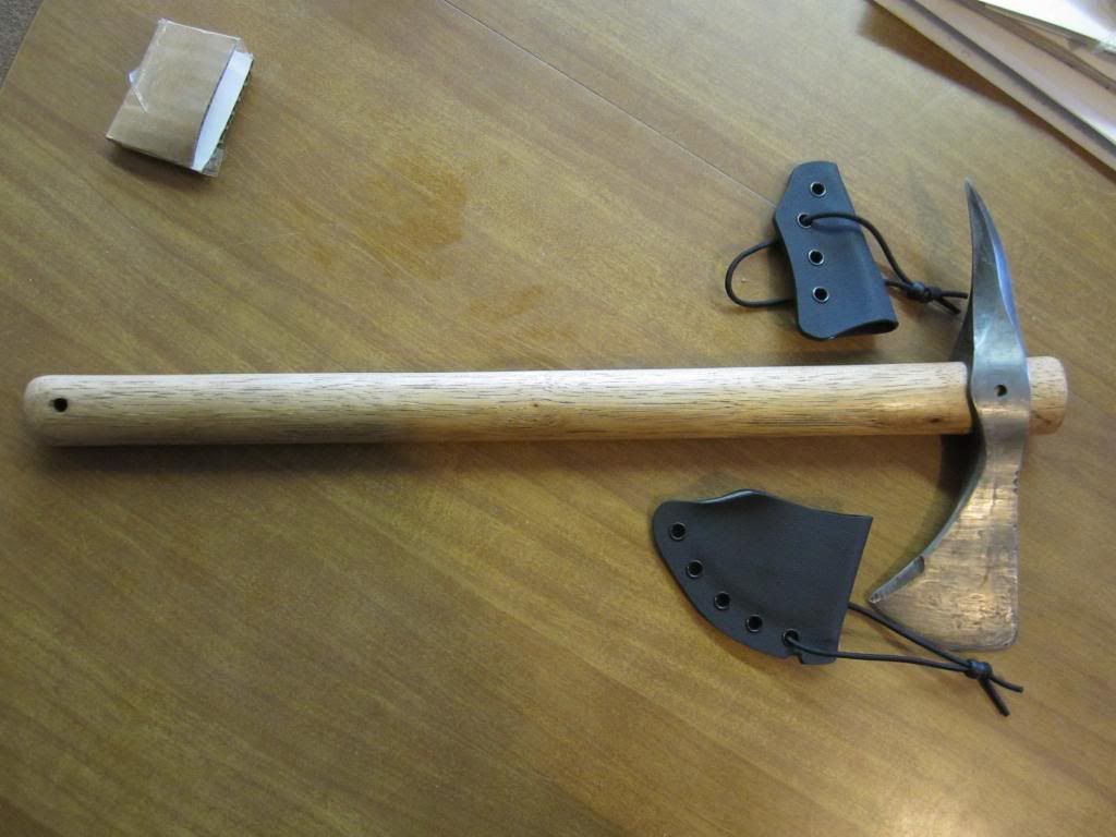

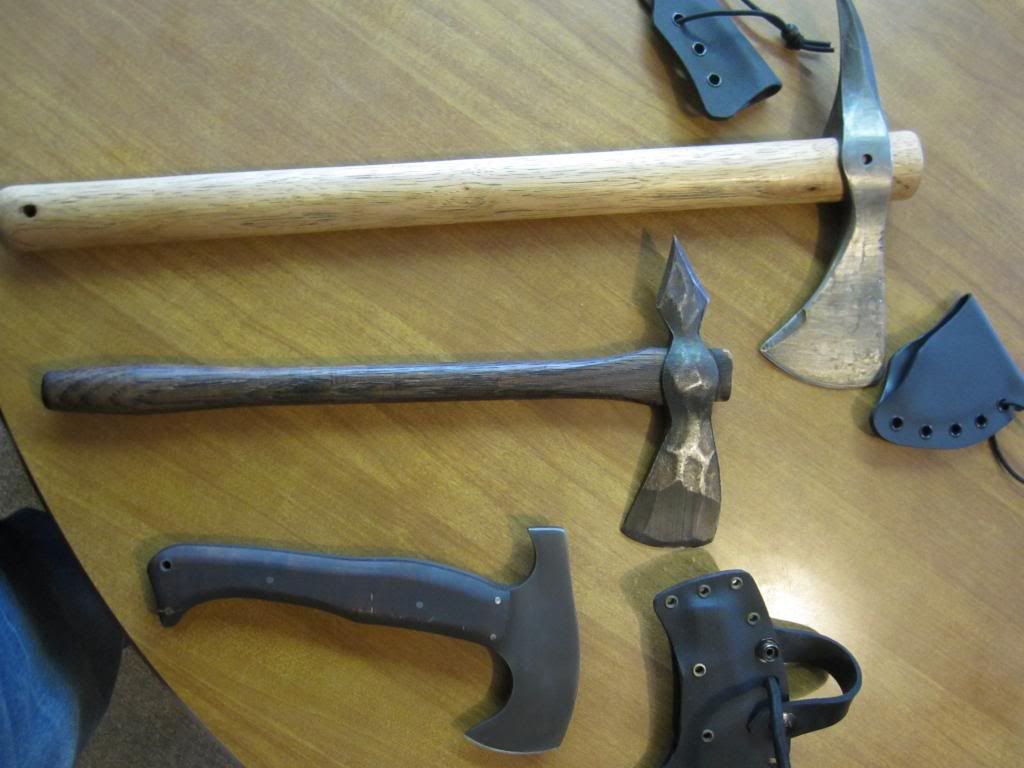

Here is my first but not likely my last try at modding a CS hawk. I went with a spike hawk, stripped the paint, polished out all the real nasty/ugly casting and grinder marks, rounded down the edges, did some ez file work with a set of chainsaw files, bearded the blade, soak and bake vinegar patinaed the head, sharpened the blade and made the last 2" of the spike nice sharp, kydex sheaths, full size handle that I tapered at the end and drilled for a lanyard and sealed with tung oil.
