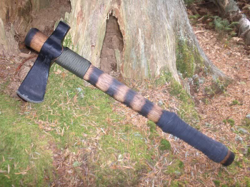

I finally got my trail hawk the way I want it so I took it for a test spin this morning...
...add Q don't let the ebony get you down brother.
NICE!...hmmmmmmm...perhaps I need to torch the haft I hath ruined...FIRE! I GIVE YOU TO BURN!
