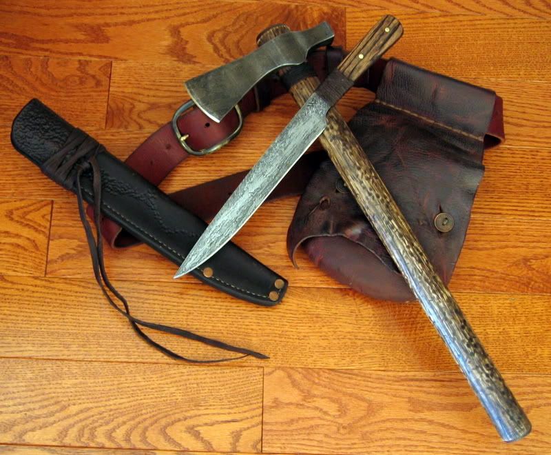

I finally got around to finishing my latest:
- 24" tung oil finished haft
- Para-cord and jute twine wrapped haft
- Sanded finish on the head with mustard and vinegar patina
- Applied polished convex edge
- Smoothed and chamfered eye
that looks pretty cool, im about to get a TH, so i have a newbie question, what is the purpose of chamfering the eye??

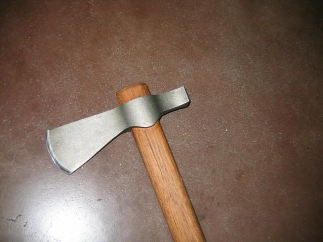

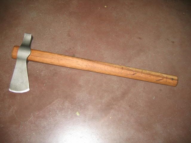

Ok I just had to do a modified trail hawk after seeing this post.
I got to thank you guys for all the info, heres my mod
Close up of the head
I tried to do a mustard and vinegar patina but it didn't work out as well as I hoped. I deburred the eye and took off all the paint, sanded the haft so I got a better fit and added some lines for decoration, I'll most likely paracord wrap it later. I treated the haft with boiled linseed oil.
Thats it!!

Better eye/haft fit.
NICE work MatthewDanger :thumbup:
Thanks CitizenQ. Like you said, it promotes a better eye/haft fit but by rounding the sharp edges of the eye you also make fitting a new haft easier. The edge of the eye can tend to bind and bite into the haft like a chisel when you are trying to dry the old haft out. By rounding the edges you prevent this and save yourself a headache later.
