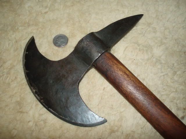

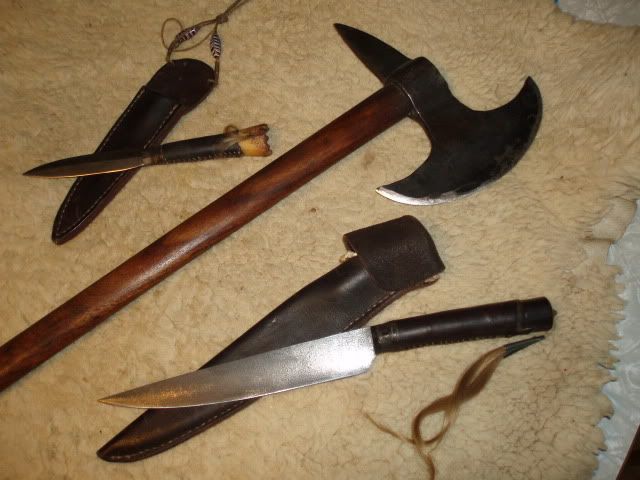

kinda off topic, but I thought I'd share what is left of my edged collection from my buckskinning days...
The axe is a French fighting axe with an 8.5 inch cutting edge & an overall head length of 8.25 inches. The 22 inch hickory handle is the fifth on this head. Illegal for all sanctioned throwing contest, it still is wicked on the block and relatively handy about camp for splitting wood and dragging poles.
The axe was purchased from G.Gedney Godwin. It is a copy of one found at Fort Ligonier.
The knives are two of three I had made by a friend in northeast Georgia. All of the knives he made me are of O1 tool steel and two of them are daggers. I watched him make the dagger not shown here and until then never knew how the blade curves during forging. The trick is to make the blade come out straight when forging the second edge to match the first. What a pain! Great blades, though...

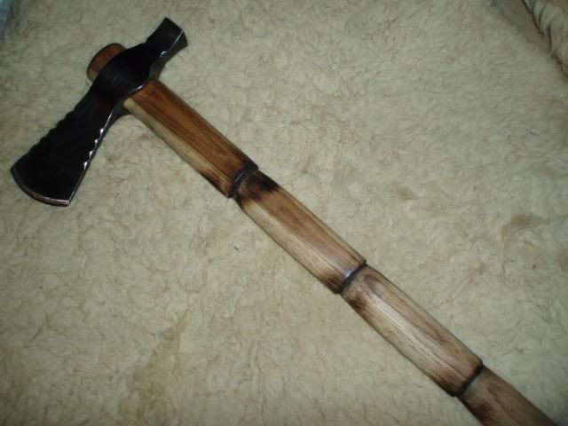

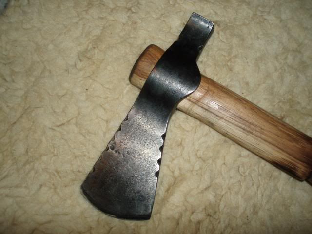

The CS Trail Hawk arrived... and was promptly disassembled! Mods began right away. who ever the guy was that turned the handle was either drunk or on his first day. Anyhoo, here is where we are this evening...
Still have much to do, but it is coming along nicely.
I modified the handle a bit. I've not cut it down from its 19 inch length yet as I'm awaiting delivery of some pewter grains for casting the end cap. Still debating casting a headpiece for the handle as well; it may be too much in weight & looks.
I've had the idea since first seeing the newer Last of the Mohicans movie which was filmed near my family's home grounds. One of the hawks shown had a stepped handle and a thin, light head. I believe it was made by Dan Winkler. I figured that with good straight-grained hickory a man could get away with doing that without weakening it too much. With this handle I did not make but three steps, equally spaced over the 19 inch handle. In the movie there were seven steps, if memory serves.
This photo does not do it justice.
After cutting in the steps I went through several rounds of whiskering the wood and sanding with ever finer grits. Effort was made to round off the edges of the steps equally. Then I scorched the steps & also burned in the Square & Compasses of my fraternity just below the head, (photo was taken before this was done). Finally I went with 000 steel wool and a good beeswax based wood polish.
The results are better than I expected. I took the axe out and worked over a few oak limbs I had recently cut. Then I split a few rather small (4in.) diameter lengths, mainly to see if the handle would crack or break. It did not, nor did I notice any hot spots on my hand following the workout even though I had gripped the hawk over one of the steps. The change in the edge that I made earlier worked well. It cut through the hard oak quickly and the edge held through out with no rolling to be found. (Thanks for the advice on that, guys!)
Once the pewter arrives I'll cut it down and make the pour. (I used to build flintlocks in my younger days and poured many a nosecap.) Once that is done I'll drill a thong hole.
