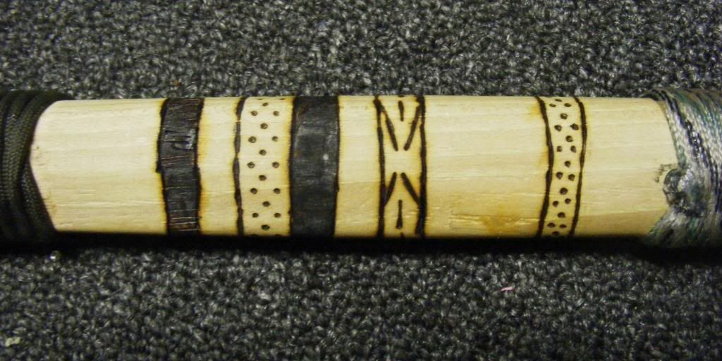

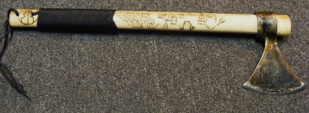

The markings on the haft have been engraved, penetrating deep enough so that the wood is lighter than the stain I made on the surface, ( the whole things was then beeswaxed....)

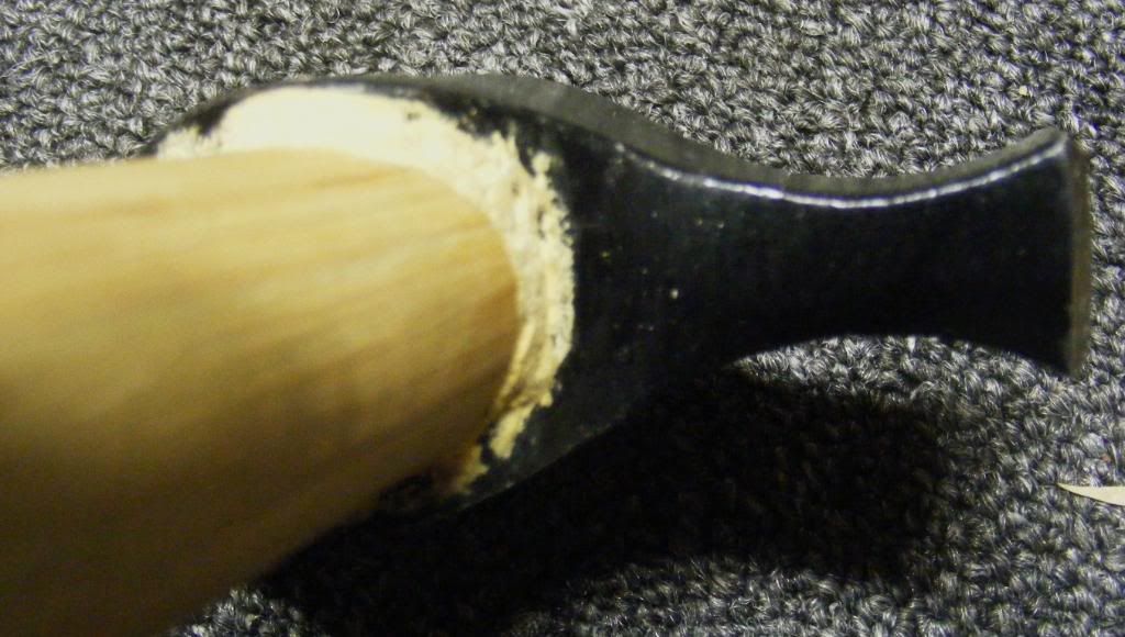

A little wood filler (before cord wrapping) really keeps the head on...
A woodburning pen gives it a neat touch...

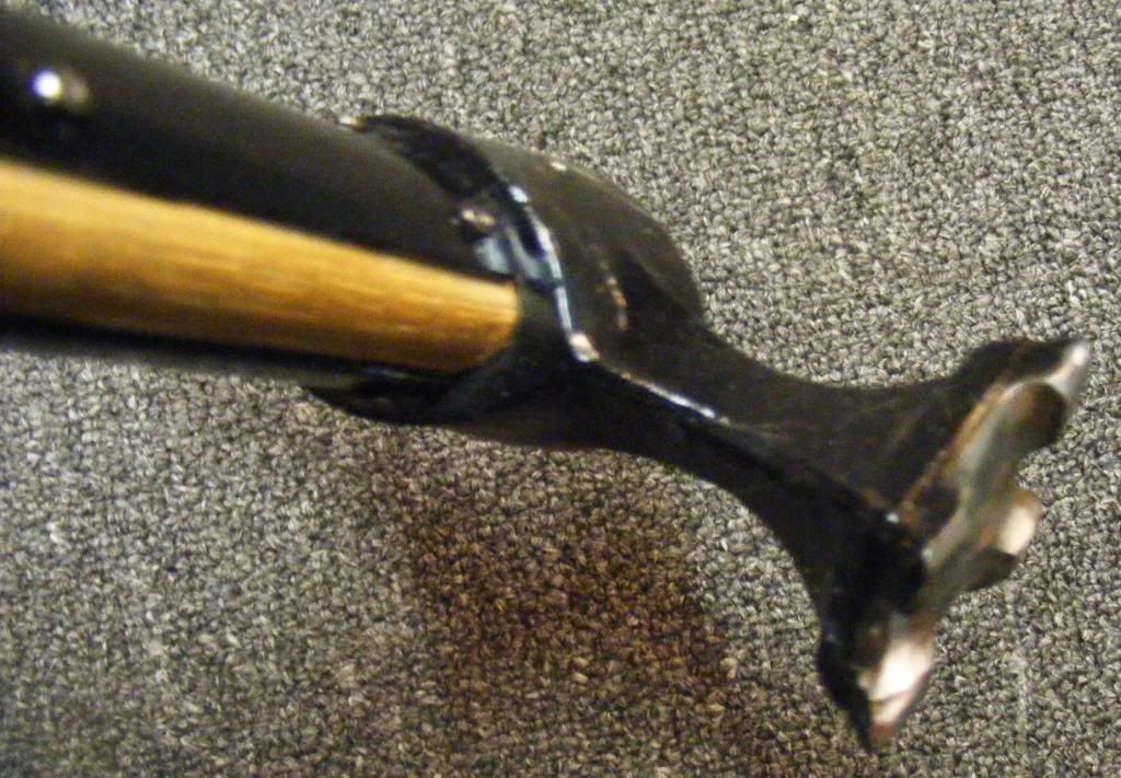

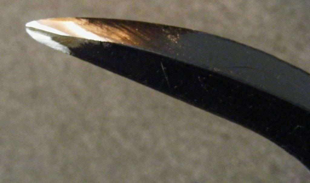

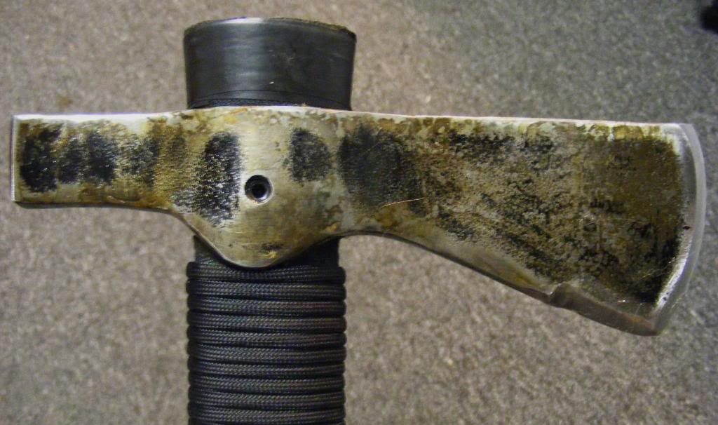

First Trail Hawk , reforged the poll into a spike. Profiled the cutting edge less rounded. Welded in the screw hole. Thinned the handle until it felt comfortable. These pictures were taken after heat treating. Cleaned it up and did a forced patina using cold blue and bleach. Don't have any pictures of the finished item... got shook down by a friend for the hawk shortly after it was done lol.

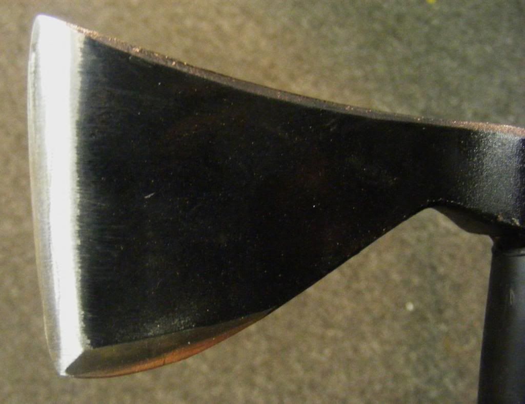

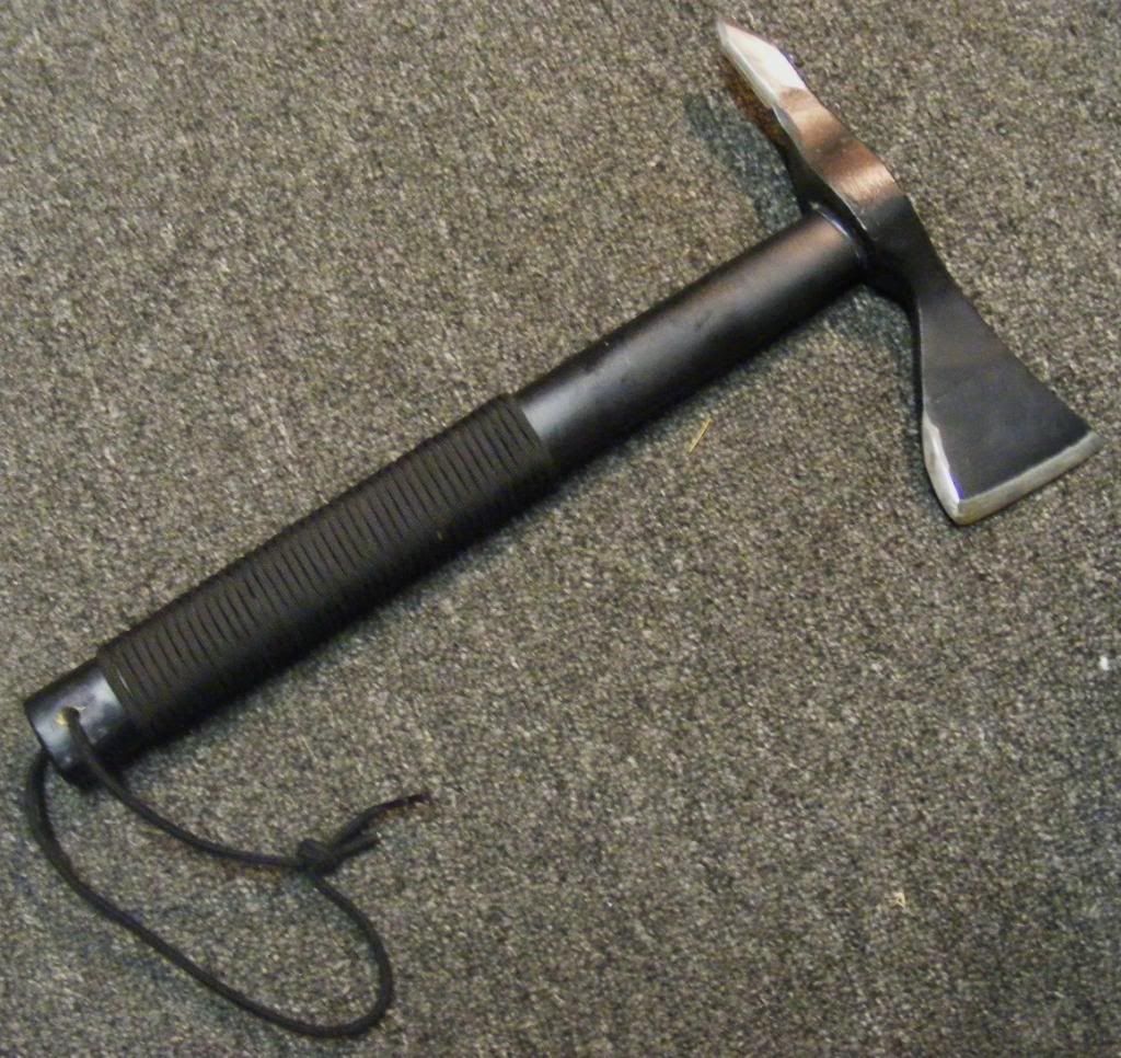

The first one is a simple United Cutlery Vietnam Tomahawk. I drilled a lanyard hole and added a wrist thong, then cord-wrapped the usable portion of the handle.
Then I convexed the edge and gave it a scalloped underside...

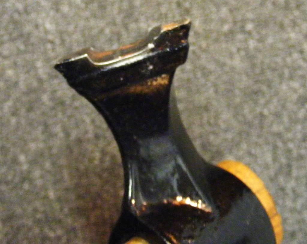

The spike was resharpened and given a swedge...
My Cold Steel War Hammer was up next. I filed out a nice diamond shape into the head for better zombie-busting ability...

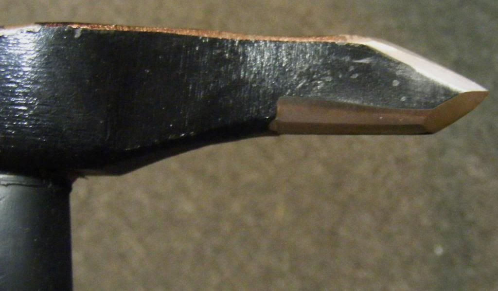

The spike was ground further back and then dulled a tiny bit to aid in retention, although sacrificing as tiny bit in pointiness...

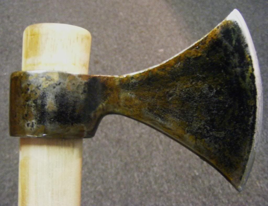

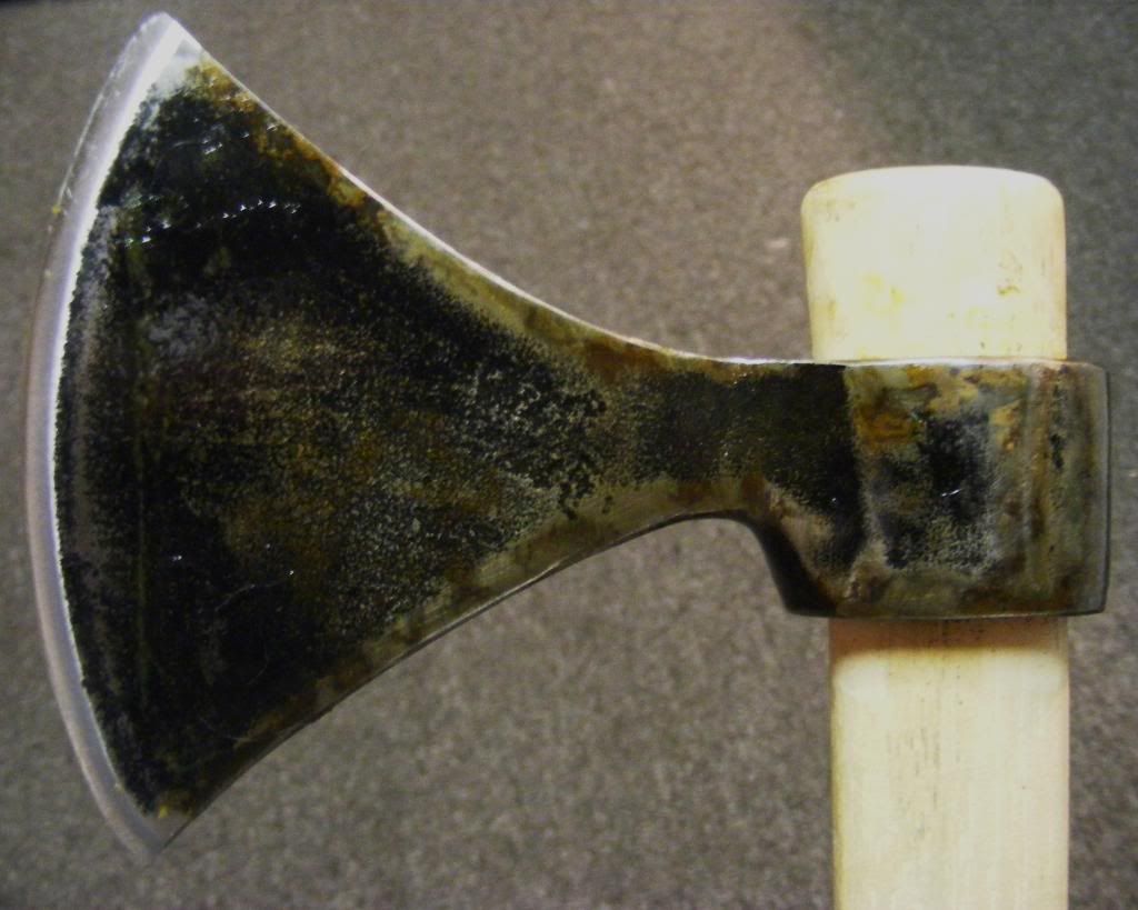

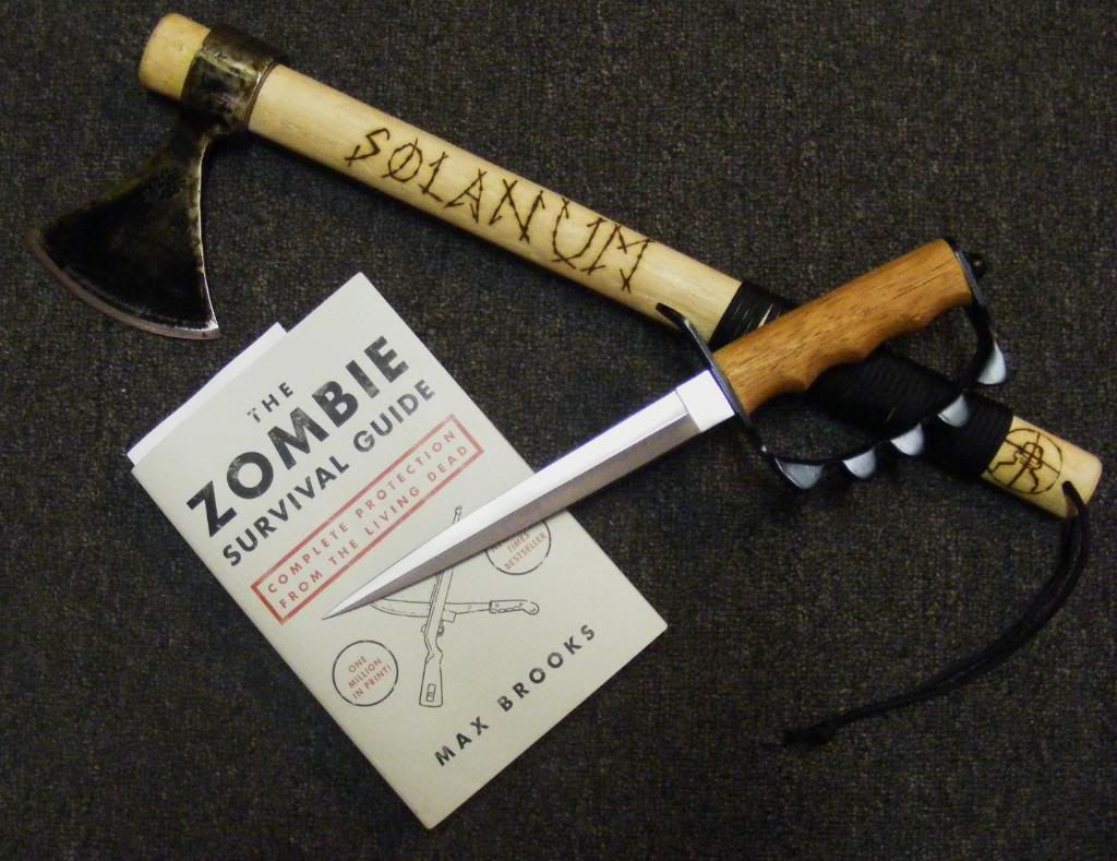

I made some Norse Hawks for a customer who wanted a zombie motif. I started by removing about 70% of the black surface and filing it smooth with sandpaper. The inside of the eye was then smoothed out and the entire thing was wiped down with rubbing alcohol. After mustard-dyeing the outside, it went into the oven at 200 degrees for 23 minutes.
As this is a zombie motif, I gave it some woodburning etches...
It looks nice, but it's missing something to be a zombie tool while still letting the customer have it as a Norse Hawk. This will do it...
The knife is a 1917 trench knife, regarded by the author of the book shown as the best anti-zombie knife ever made.
