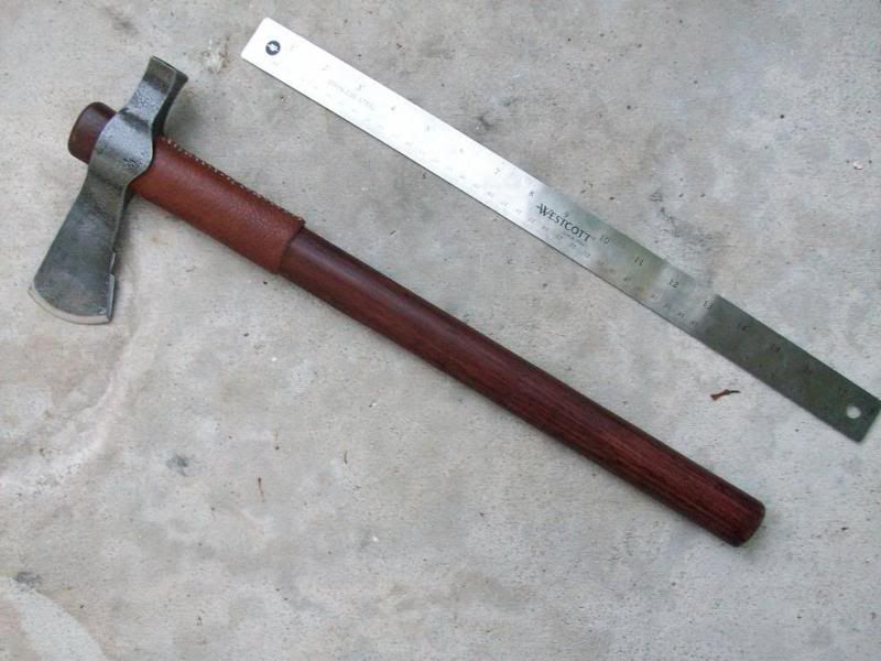

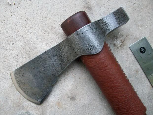

Here's my first tomahawk mod. Like I mentioned before, It's a trail hawk (at least originally) :
I don't consider myself anywhere near done with this thing. I'll just add on as I go.
Looks great Kissaki! What did you do to achieve the blade finish?
I sanded the blade with some sort of Dremel attachment and a sanding sponge until the only paint left was the stuff sunken in the crevices and pit marks. Then I submerged the head in a boiling mix of water + Vinegar (50/50) for a couple of minutes. After it was a fairly dark hue, I pulled it out, and used some 1500 grit sandpaper and lightly went over the blade with it, just to make the edges and high points on the texture a bit shinier than the rest of the metal.
Good work Kissaki. I like the hue of the haft stain. How did you manage the leather wrap under the head?
