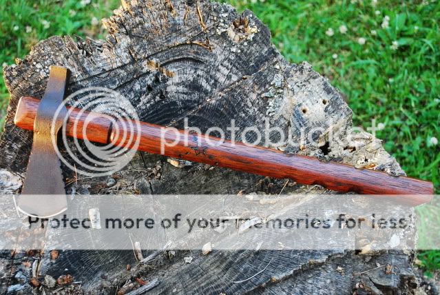

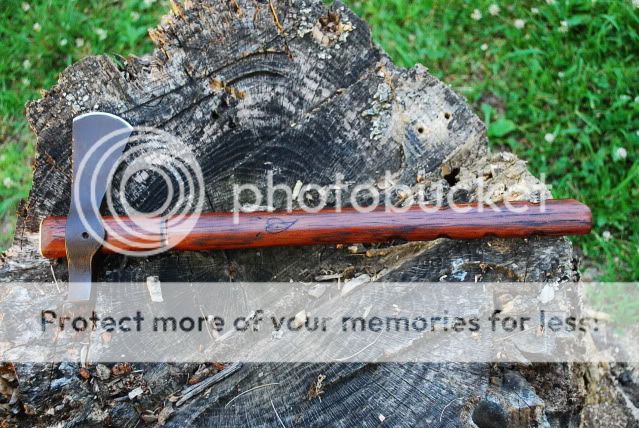

Good work Kissaki. I like the hue of the haft stain. How did you manage the leather wrap under the head?
Thanks! (The hue is "Rosewood", btw)
I cut the leather to contour the area that meets the head, then I stitched it on with some cotton "Butcher's Twine."

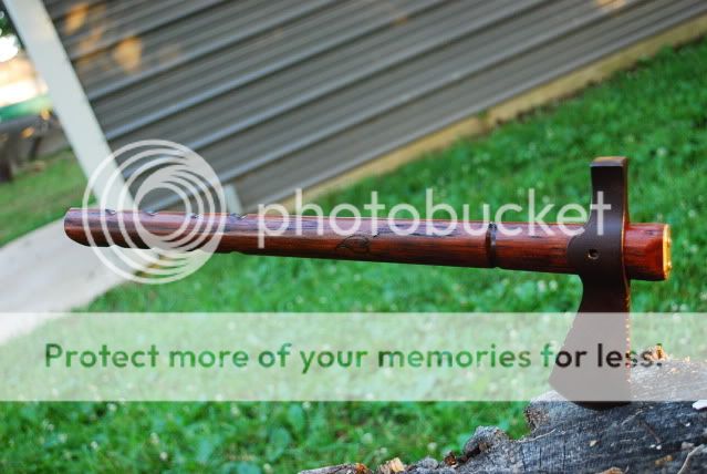

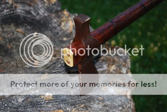

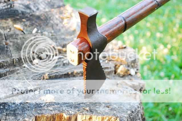

just finished my trail hawk. i am more into flintlocks so mine is more traditional. i wish i had welded up that hole on the side, thinking of a brass pin. wood is nice under the factory finish.
That's awesome! Is the head plum- browned? That's waht I thinking of trying on my pipe or spike hawk.
I filed the cap with it mounted it was on the end of the hawk, and used the same stain i put on some of the flintlocks i built. And yes it is mountain laurel forge brown. Need to make some short ones for throwing.
That end cap is an OUTSTANDING idea Bowkill...I think I'll try to do a cap on both ends of a haft.
