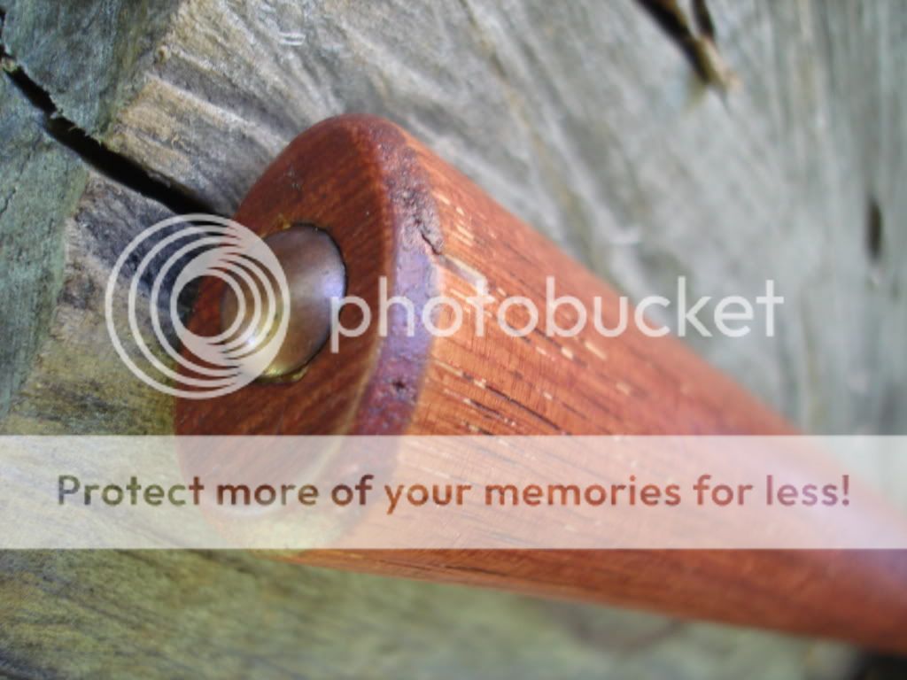

Hey guys! I've had a Riflemans hawk that I modded a few years back, but I never held a trailhawk till last week. Finally got a couple, and WOW! do these feel good in the hand. Very light and fast, and I love throwing them too!
Well it didn't take long at all for me to decide to mod one. I was thinking it would compliment my modded Laredo Bowie ...well anyway here it is...
I started by sanding down the head, then did some basic filework, stained it with gun-blue, then convexed the edge to a nice hair splitting shine.
...sanded the haft, then burned in the design with a cheap soldering iron. (the design was inspired by the hawk used in the movie The Patriot) ...had trouble with the staining, but after like seven coats of three different colors that I tried I finally said screw it, good enough!
^ Then I used solid bronze upholstery tacks to sort of cap-off the ends of the haft. FYI they are an EXACT fit for the machine marking on the bottom of the CS hafts! ....I like the look, and I figure they'd give a little extra sting when thrown.
...Soon to come, custom sheath courtesy of Goose 52.
