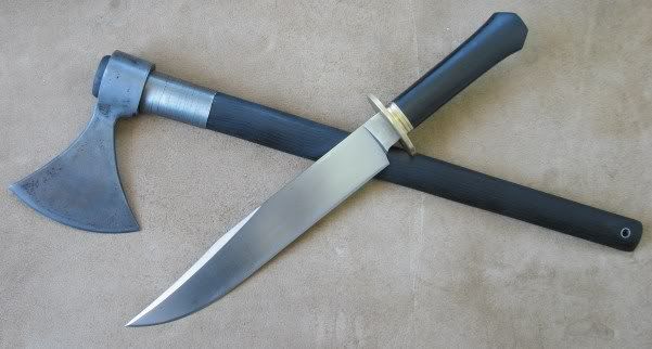

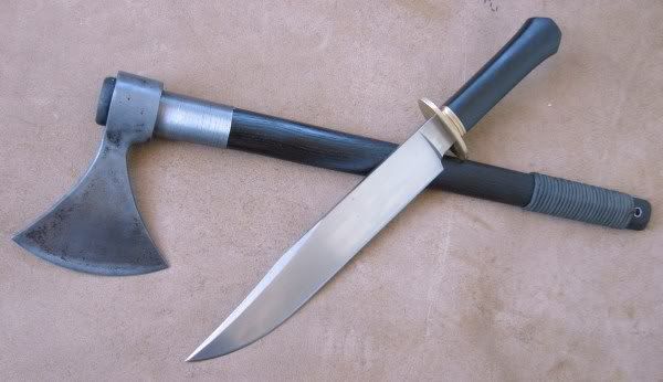

I wanna post my norse hawk here since this is the thread where I got all the advice I needed to customize it. Stainless wire, stainless lanyard tube, burnt haft, baked on vinegar patina. 4 inches of OD green chord wrapped handle and that'll do it. Can't wait to try a trail hawk!
EDIT: Like so!
Wow thats awesome. Would love to hear more detail on how you did the steel wire.
Baked on vinegar patina is nice, too, how'd you do it?

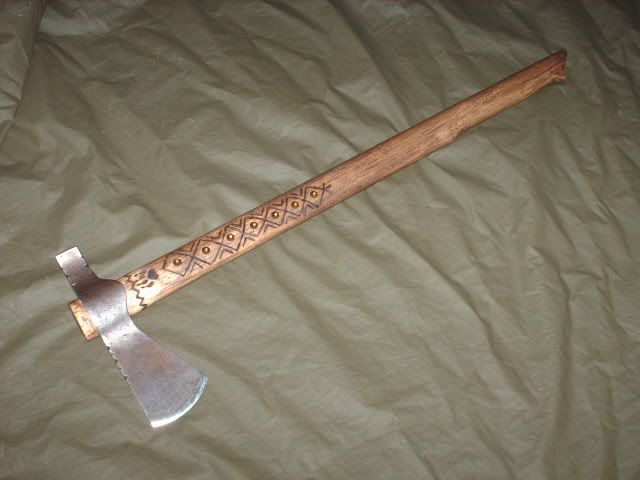

Ok so I'm just about done with my Trail Hawk project. I have it on a 22" handle carved into nice form and all decorated nicely.
I don't know. It's a bit tiny for use as a serious general purpose tool out in the woods but I bet it's a hella nasty combat weapon. VERY fast in the hand.

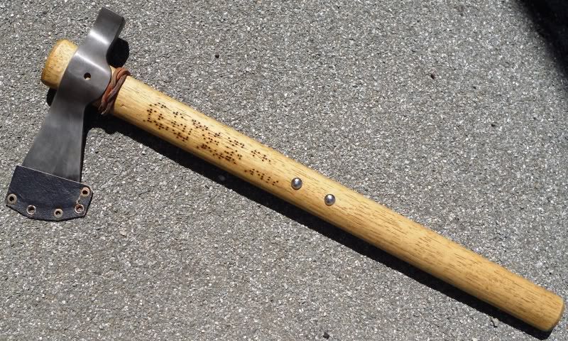

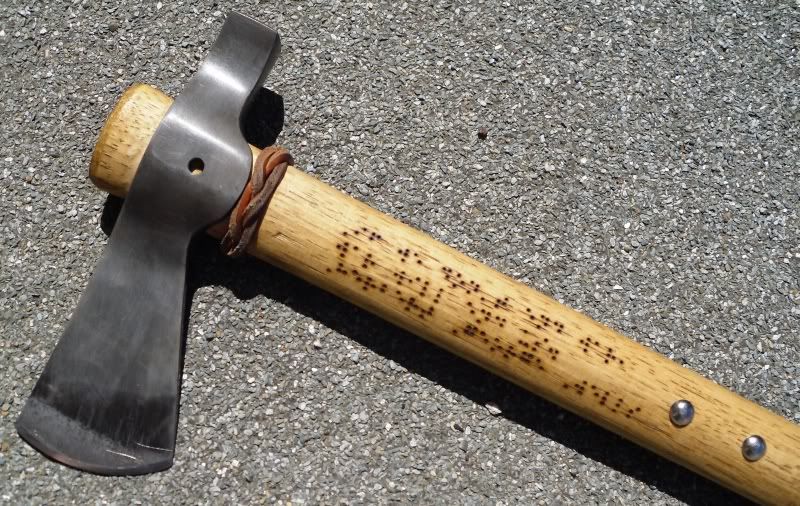

Alright, all the great mods here inspired me to take mine a step further.
I started out with a turk's head knot - used rawhide first, but it came off after it had dried; So I tried leather and it's still taut.
Then I added a little pyrography quote in braille and two tacks on each side of the handle. I have pondered whether I should have done more than two, but then decided it'd look tacky.:rolleyes:
I also made a little blade cover from old leather and copper rivets.
