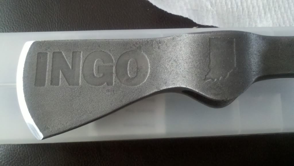

my first modded hawk I did for a local gun forum give away. I still need to do some file work on the head then assemble it all. the handle is stained "cabernet" and wrapped in OD cord to match the forums colors.

Here is my Cold Steel Trail Hawk Mod. I decided to go the more traditional route.
This is what I started with.
Here are the mods. I reshaped the hammer and blade. Did some file work, blued the head and stained the haft.

Moz on the etching question read back a few pages and its covered in this thread. I and others have posted details on what we've tried.
Moz I've come up with a new approach to the set screw hole:
I epoxy it in, making sure it doesn't project past the inside of the eye.
Then I use the trusty Dremel to cut in a groovy design, about 2mm or so deep.
After I patinate the head (H2O2 + salt), the set screw & hole aren't noticeable unless one is intentionally looking for them. The cut-in design and patination camoflage it excellently.

yes i was thinking bout the epoxy trick but wasnt too sure, does it withstand vigorous working? i should imagine it does but to be sure. thanks for the info though.
heres another question: would UHMWPE thermoplastic be suitable for a hawk handle?
MoZ
I don't know yet ;) It should though. It's not in a place where it will experience any serious shock or vibration.
