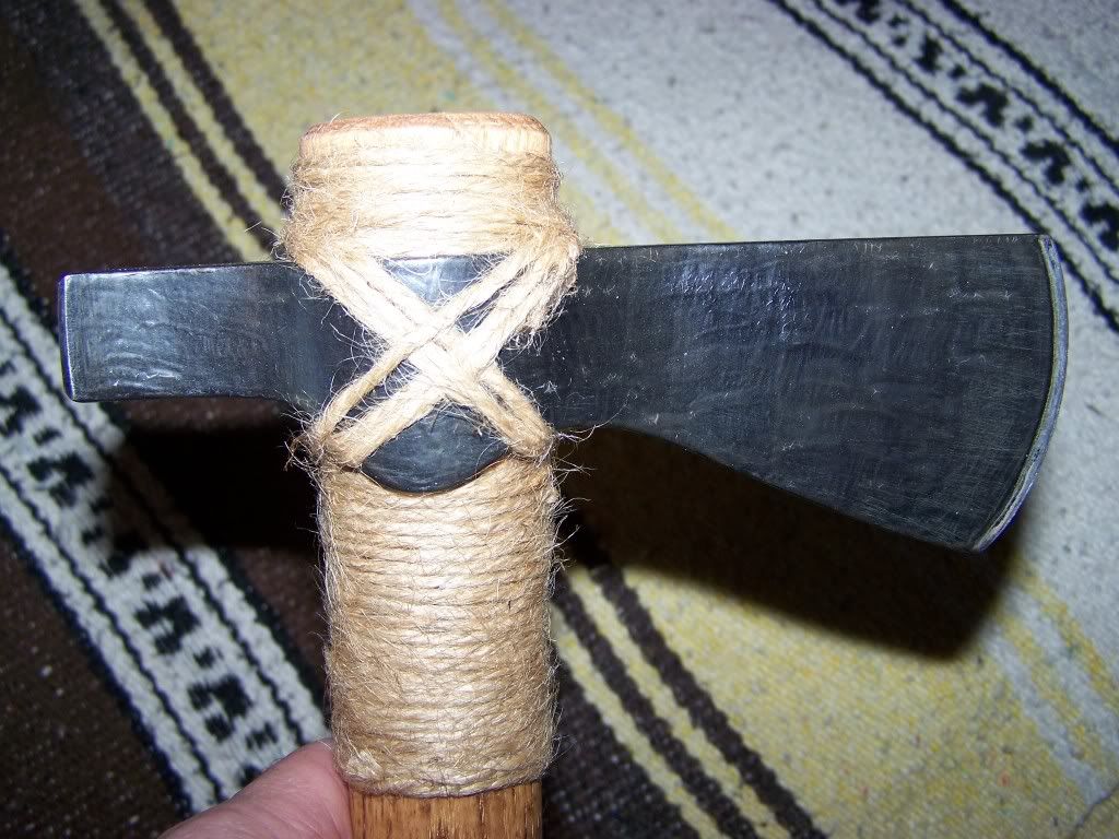

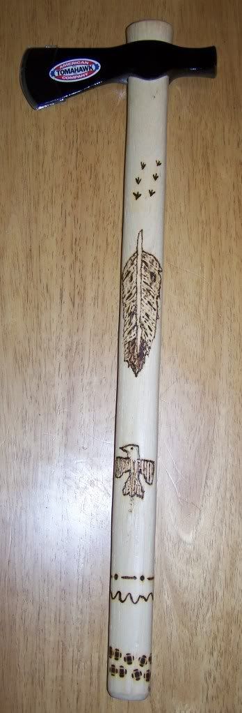

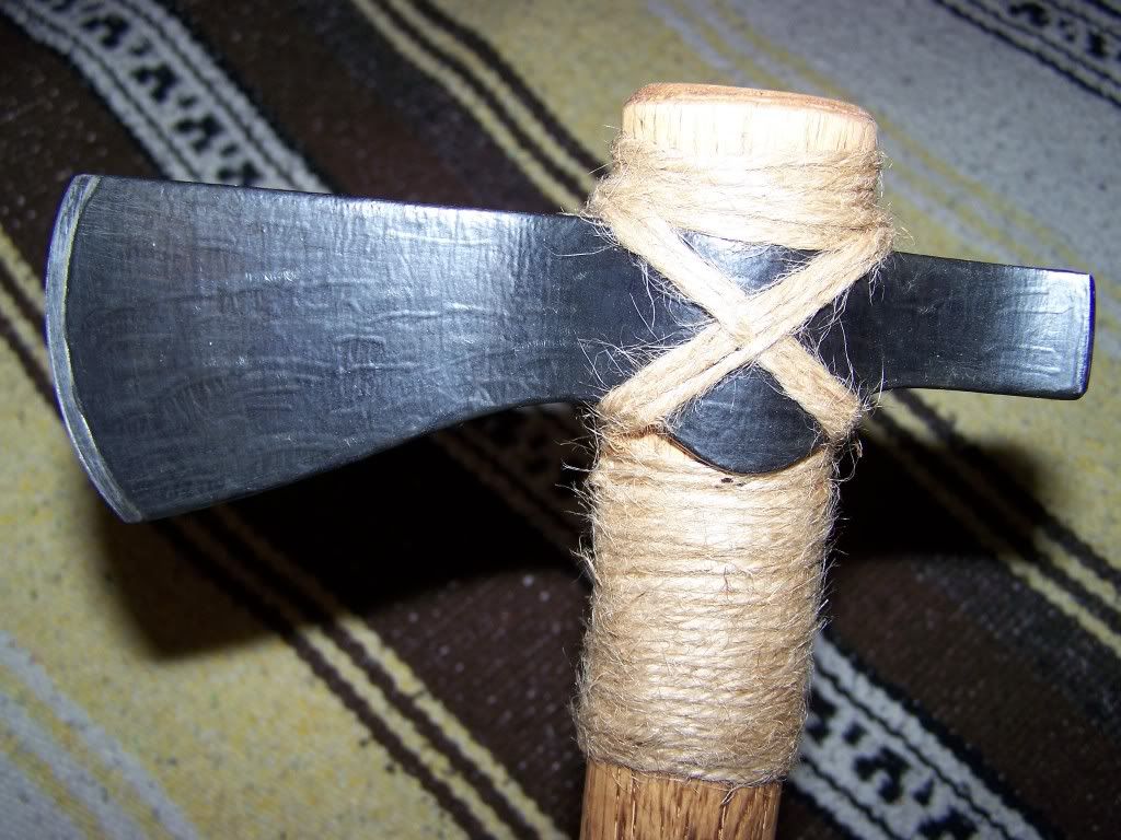

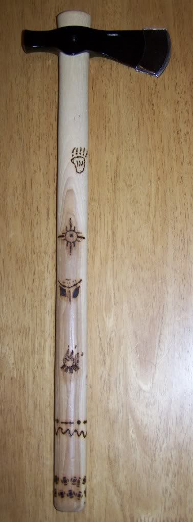

I got my first Tomahawk with Christmas money. Ive been looking to get one and after lots of searching, I decided the Trail Hawk was the look I was after. Once it arrived I wood burned some Native American symbols into it for looks and grip. I took the head off, stripped the paint because I didn't care for the gloss black. I stained the handle with early American Min wax stain, which unfortunately took away from the wood burned symbols. My goal was to make my tomahawk look like it came from the 1800's. I tried various paint colors on the head, didn't like how they came out, debated on keeping it bare but since I plan on using it alot, I finally settled on Rustolium rust inhibitor which dries to a black finish. I applied three coats the last of which I made the brush stoke ridges you see, I liked the way they looked. Also I used twine even though I have tons of para cord the twine gave it the look I was after. So this is what my C/S Trail Hawk looks like
