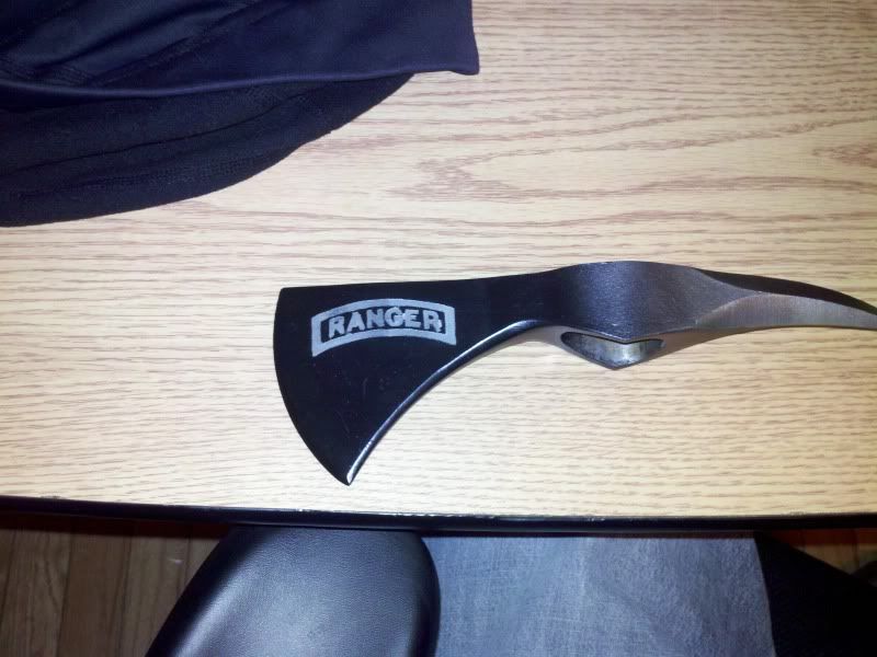

My 15 year old son decided that he wanted to try his hand at modding a hawk and here's what he made. He watched me make and etch one earlier and that's all of the guidance he needed. All that's left to do is sharpen the edge.
Not bad for paper, scissors, spray paint, etching solution and some elbow grease!
Nice work. What type/brand etching solution are you using?

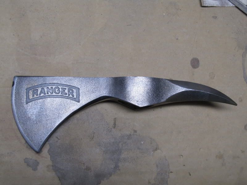

So, after reading all this fine information on the hawk mods, I decided to do a couple of my own. I ordered a spike hawk and and trail hawk from the interweb. I then promptly forgot that I'd done so, and placed an identical order about two days later (Jameson is a powerful substance :D ) So.... I have two of each. Christmas present time!! I have a buddy that used to be a Ranger who will be the recipient of my first endeavor. I present to you, the Ranger Spike :thumbup:

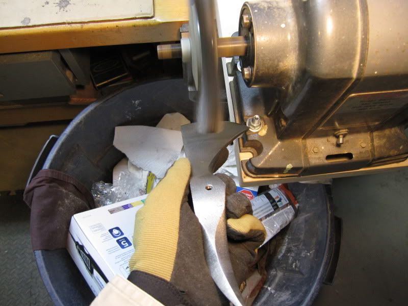

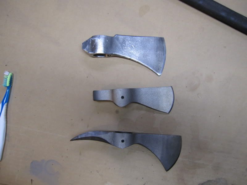

I started by stripping off the old paint with some flooring adhesive remover I had lying around. Let me tell you, this stuff is no joke and worked like a charm. I cleaned it all off, and then used a wire wheel on the ol bench grinder to brighten it up a bit.
I repeated these steps for the others, as well as an old Rifleman hawk I've had since I was little. You'll note I cut the head off that one. It's going to be a beater, as the old forging process appeared to be more crude and the pitting is extremely deep.

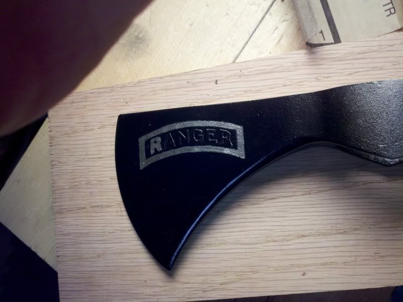

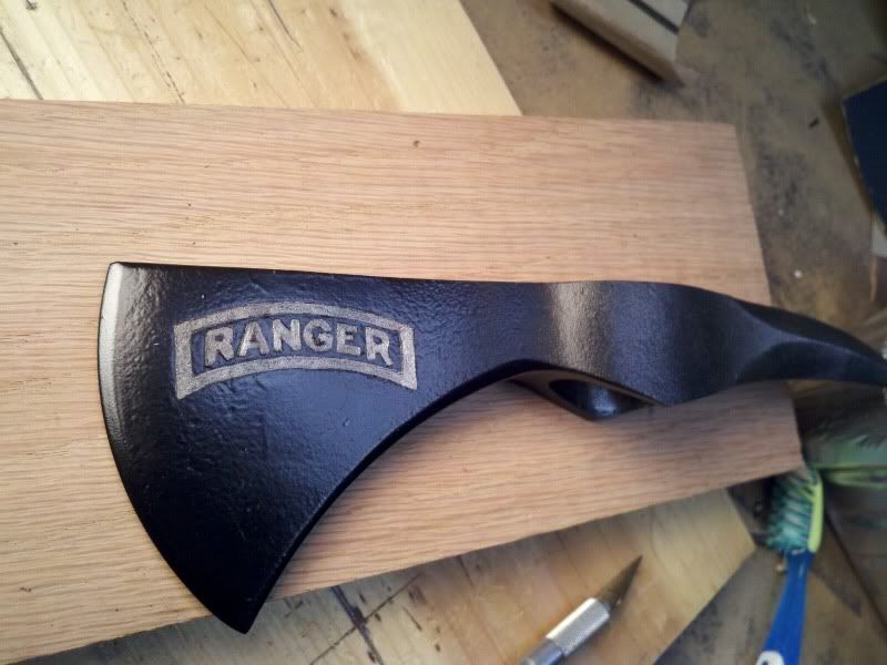

Next, I got online and found a graphic of a Ranger Tab to be etched into the blade. I cut out the solid lines for the border and letters (not easy) and glued them to the hawk head (down right excrutiating :mad:). I then spray painted the area to be etched with black krylon. I gave it 3ish coats and let it dry over night. The following day, I used an exacto knife and removed the stencils.

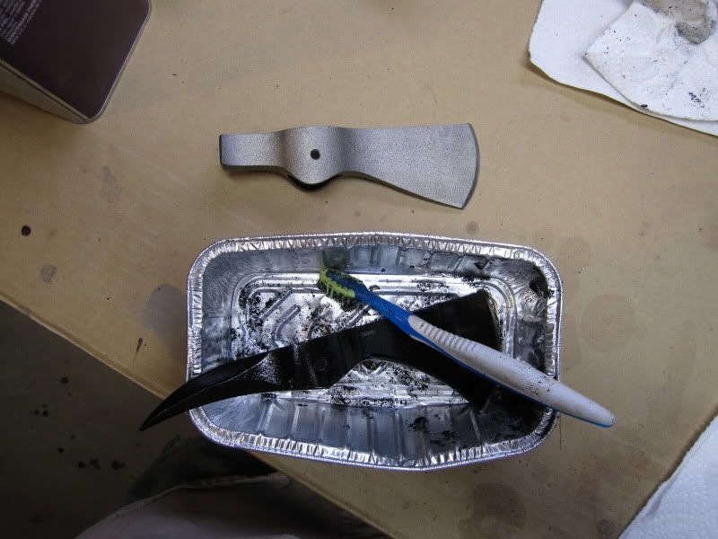

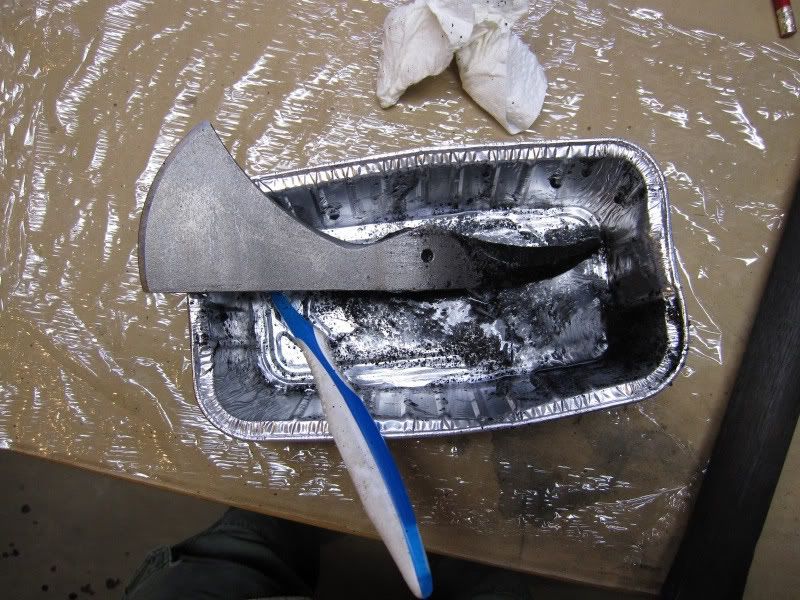

I bought some etching solution at Radio Shack (used there for etching circuit boards, thanks to who ever suggested trying them). I found a flower vase in the kitchen cabinet (thanks honey ;)) that was perfect for etching. I set the head in the solution, and the vase in a dish of hot water (I read that it works better warm). I used an old tooth brush to clean off the etch about every hour for the first three hours. I decided it was removing material slowly, so I let it soak over night. Total time in solution was about 6-7 hours. Next morning I took it out and cleaned it off really well with soap and water. You can see a couple places where the paint flaked off during cleaning.
I then repeated the paint stripping process and wire wheel cleaning.
Originally, I was going to patina this hawk, but I have decided now that I'm going to DuraCoat it. The etch was deep enough that it will stand out nicely with a coat of the DC and I'm not sure that I trust cold blue or brown to provide the level of rust resistance I'd like.
That being said, anyone have any input as to how rust resistant the cold blue or brown is? How about a forced patina with vinegar? Any other chemical?

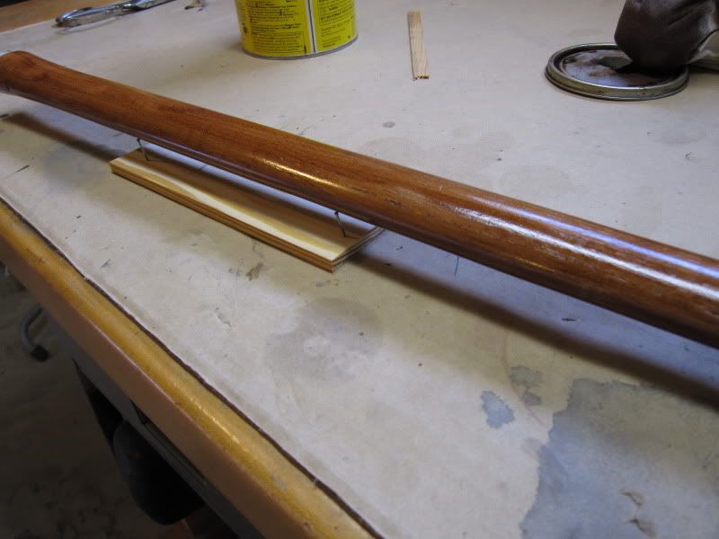

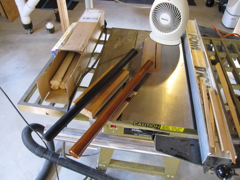

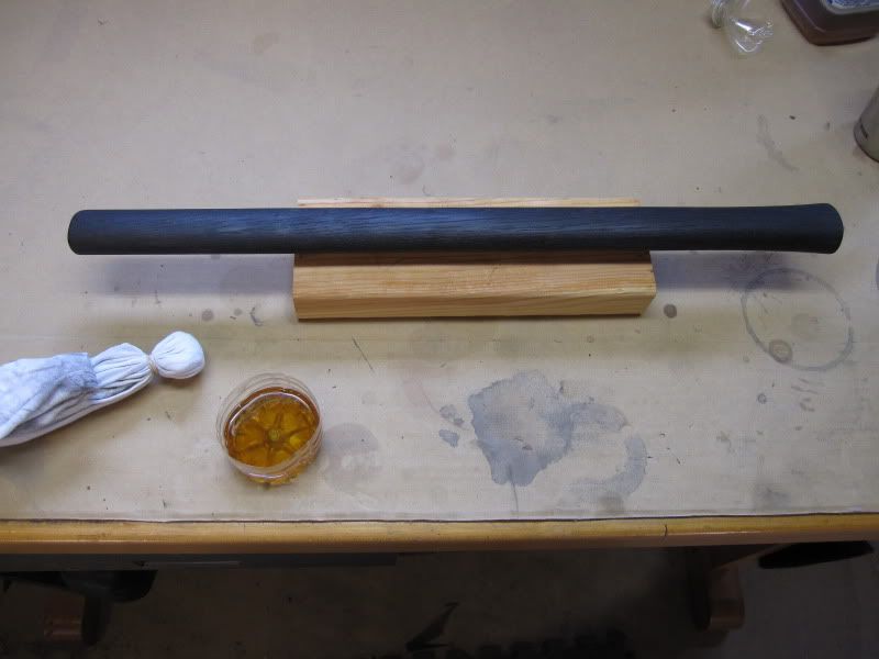

I liked Brother Q's idea about the charred handle, so I'm giving it a whirl myself. I used 80 grit sandpaper to take off the handle's existing finish, then smoothed it a bit with 100 grit. I used a standard propane torch and charred up a piece of hickory. The astute observer may notice another hawk head that will be featured in a later post :D
After charring, I took a clean cotton cloth and wiped off the waste material made ash by the flame. I sanded lightly with 220 grit sandpaper. I then used a cloth to apply a coat of Minwax Spar Varnish cut 50/50 with mineral spirits. It goes on thin and get into the crevasses really well. I applies a couple coats to get it sealed well. I'll be switching to full strength varnish for the next coat.
I plan on adding some cord wrapping to the handles for over strike protection and for grip traction.

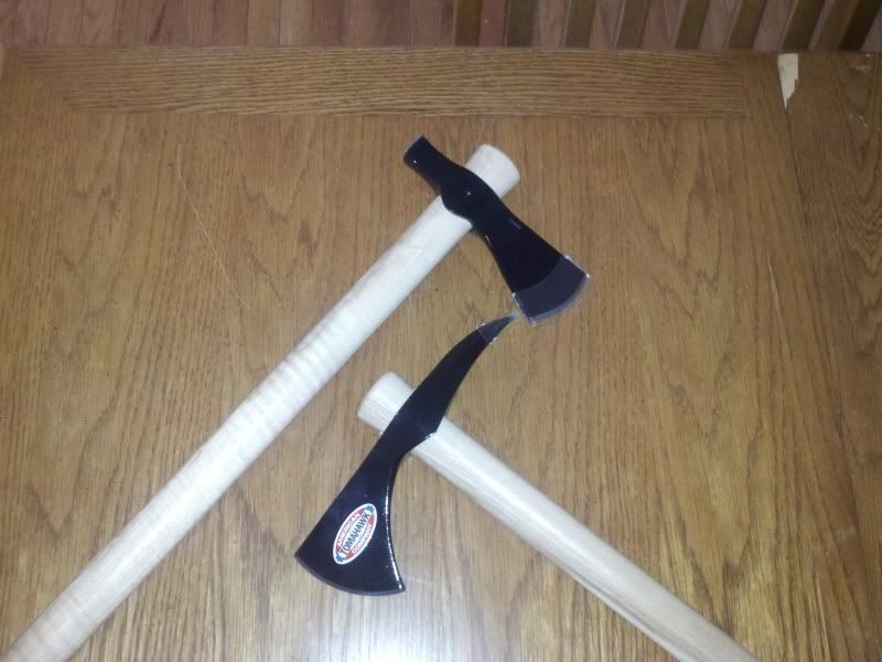

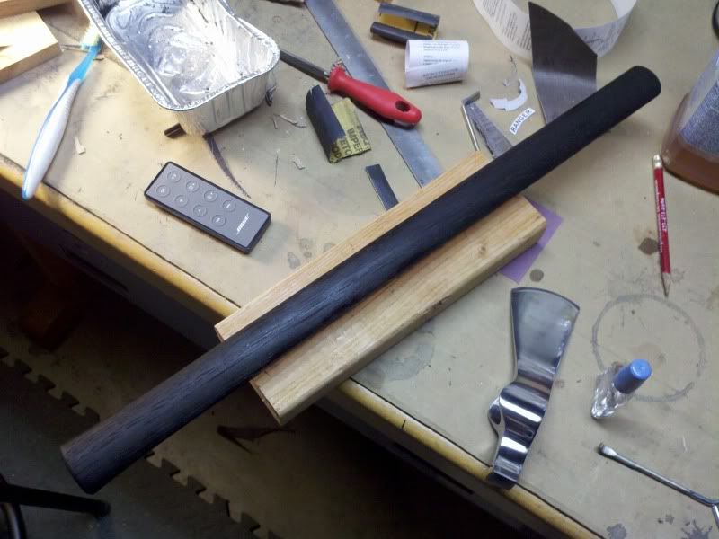

Also, I'm going to do a traditional/antique appearance hawk with a trail hawk head. One of the hawks I received had a handle with some really nice curl to the grain. I decided that would be my traditional handle. I stripped the existing finish off and sanded out some of the scuffs and scrapes from the factory head mounting. Then I applied some stain (English Chestnut from Minwax, I think). You can see the curl a bit better in the second picture. I have them sitting in front of a space heater to assist in the drying because it's cold in my basement.
I'm going to put another coat or two of stain on that handle so it'll get as dark as possible. The hickory seems to be only moderately porous as far as wood goes.

Thanks. I don't think the paint I used will hold up to hard use. I'm gonna try gun blue next.

Your etching turned out great, one idea re: the break down of the edges might be to scrub less. Just an idea.
Right on brother Pullrich. I'm thinking for my next etch that I'm just going to let it soak overnight and see how it goes. I'm not sure if that will work well or not, seeing as the waste metal created by the chemical reaction may actually serve to protect the exposed etch area by not allowing the etchtant to come into contact with it. Another fine experiment soon to be tried :) I'll keep ya'll posted.
Solid
We'll all be interested in how an overnight soak goes. I've been afraid to do that because when I've done ~2-4 hour soaks, with the hours split up by simple water rinses, the etchant has started to eat under the resist, muddying the lines of the design.
