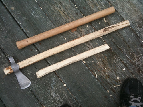

I went out and got the stripper can the next day. I used white ash for the 15" handle which was a pain to work with (took an hour to get right). I tried again and made a second handle with hickory that's about 25" long and it was much easier to make (Hickory is a great wood to work with though). It took about 20 minutes which wasn't as good as iawoodsman's video, but I'm still practicing. I'll post some pics tomorrow of it.
One observation I have made from making those handles is that just taking the head and making a handle at the campsite is an extremely plausible situation. This would make sense on tight weight requirements but you absolutely MUST practice this because my first go-round had me tired and annoyed; the second time seemed much easier. Or maybe it was my wood choice.
I think IAwoodsman used green wood to make his handle, which made it easier to work.
I didn't think of that but it makes sense. The ash was taken off a fallen limb while the hickory was a fresh sapling. That may have made all the difference.
Here are pics of my 25" handle... It almost looks better to me than the stock one. No one should have to pay $10 for a stick.
It's fit isn't perfect, but the way the head wedges in there makes it extremely secure...
Pretty awesome when the handle is long. What's weird is that it actually feels good in the hand and works great for two handed swings.
Next up is a full-size 35" handle. Dangerous? Maybe. Fun? Absolutely.
