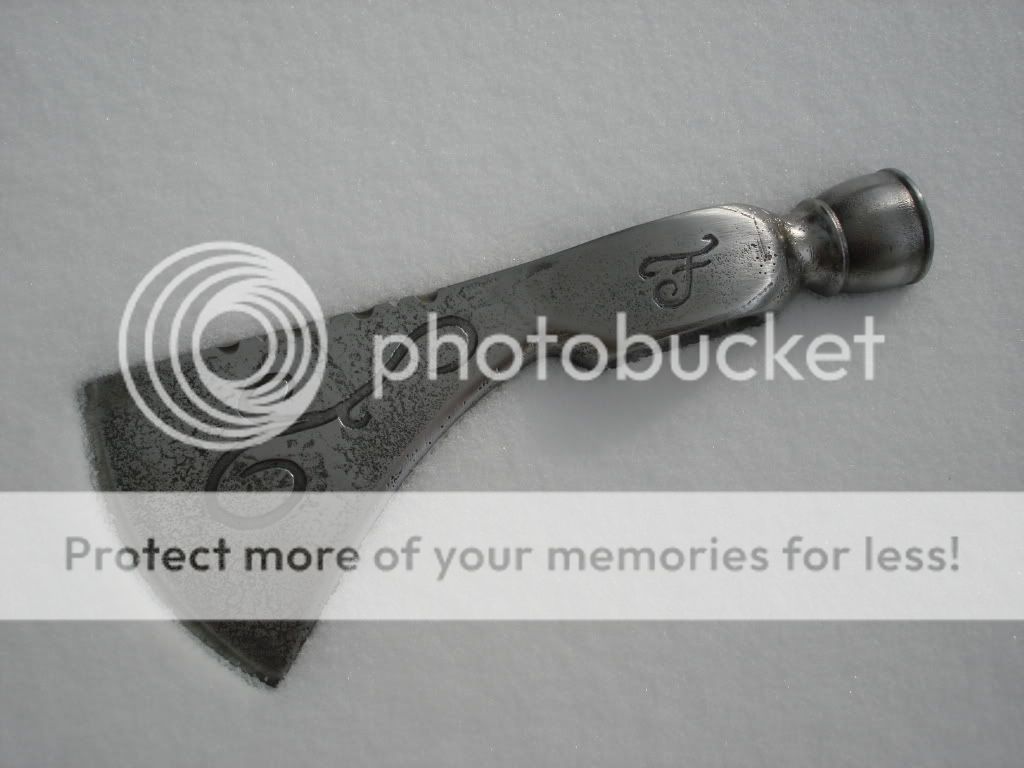

Been a while since I worked on a hawk, but I got my hands on a CS pipehawk and decided to try few mods...
Started out with some reshaping, by rounding off the sharp angles near the haft and pipe area. Stripped the paint (that paint remover is some nasty stuff!) sanded it, ...then dicide to try my hand at some etching, (thanks to Pullrich and others for the helpful etching info!)
I decided to leave a lot of the pitting since I'm going for the "functional antique" kind of look. I'm doing an old style vine pattern theme with my initial "F" thrown in there. The vine pattern took about 12 hrs, while the F didn't take the first time, so I had to re-do it with another 12 hrs of rinse and soke....

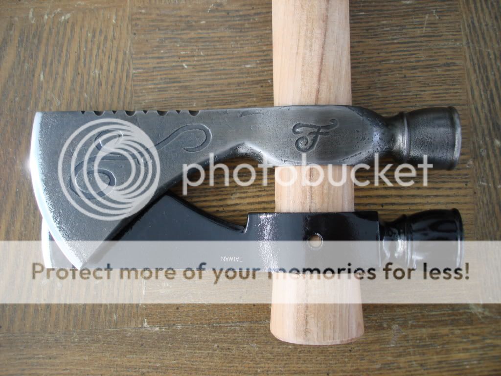

Did some vine pattern filework on the top, and a gun blue patina...
A before and after so you can see where I reshaped it. Also I purposely used the etchant to cause pitting on the areas I filed down to create a more uniformed old-timey look...

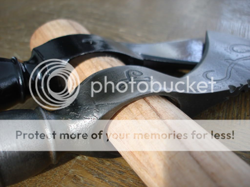

Sticking with the vine theme I burned this pattern into the haft, stained it, and put some brass tacks in the top and bottom. I also filed out the screw hole into this star pattern (thanks to hawkhead for that idea) ...then filled it with a liquid steel type epoxy. Sadly I should have done that after the etching since the etchant caused some unwanted discoloring...

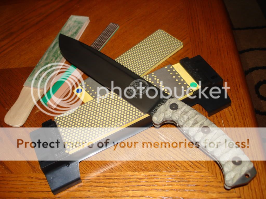

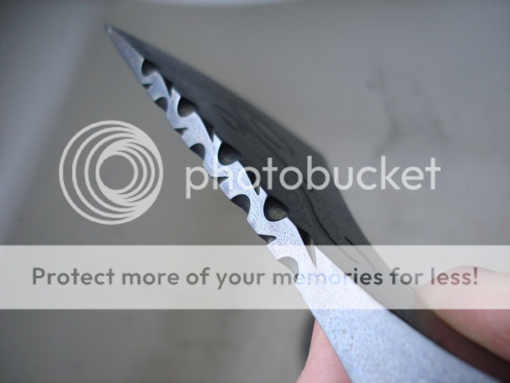

Messed around with some cord wrapping, but I'm not happy with it yet, so it will get redone soon. OH and I gave it a good hair shaving convex edge, cause you never know when you may need to scalp someone. :)

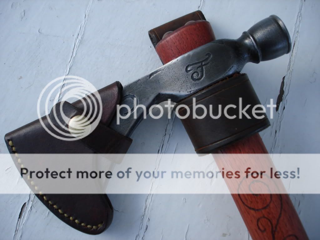

....and a pic of the sheath and belt loop, courtesy of Goose52....
