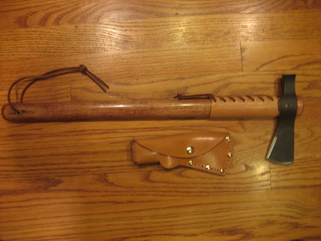

Here is my trail hawk out of sheath. Beard is sharpened,edge convex,head cold blued and cured in Breakfree. 1/4 brass pipe inserted in lanyard hole. I'm hoping this will turn out to be a great multipurpose lightweight hunting hawk. I have taken it camping once and am impressed with it,s cutting and chopping.

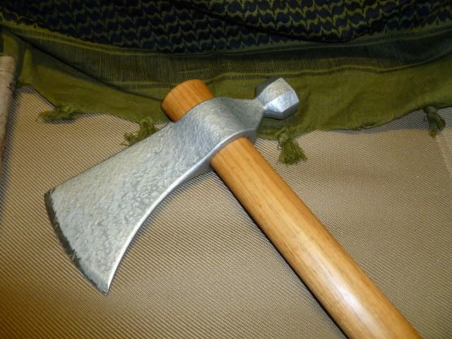

Finally got some pics of my modded hawk.
I painted the handle satin black with about 5 coats, and than five more coats of some satin stain. It really came out the way I wanted and it's pritty durable too with all those coats, no chipping yet. The head is colored with silver bake on Gunkote, a semi sharp convex grind and there's a mirrior finish on the hammer. I followed the directions of the members here to get that polish.
quike question about your leather wrap. Did you put it on and tie it dry or did you soak it before hand?

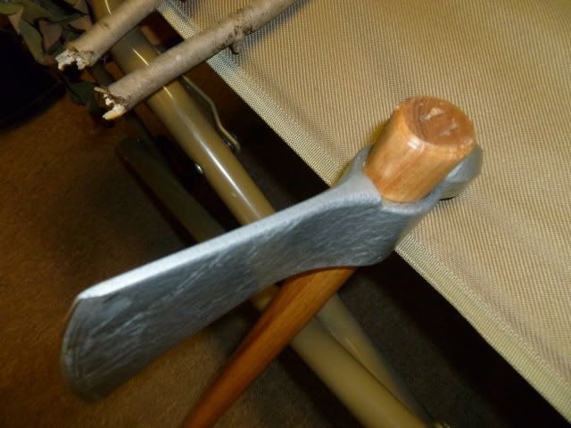

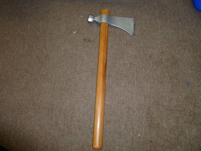

I went with the Rifleman's Hawk due to it's added weight and I liked the design of it. Just like many CS hawk owners, I quickly went to work modding my hawk and the end result was was satisfactory to me. Here is what I did
1- Took the crew out and tossed it in the can.
2- Removed the head, stripped off the black pain, sanded down the head.
3- Sanded down the handle, stained, repeated both three times.
4- Used Rustolium Silver Hammered spray and gave it two coats.
It's not much, but this was the end result:
The Rifleman's Hawk throws pretty well despite it's weight and you get used to it pretty fast. It's now a frequent companion in my outdoor adventures.

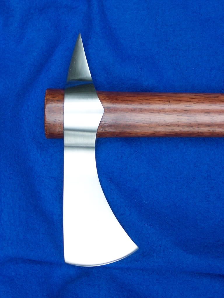

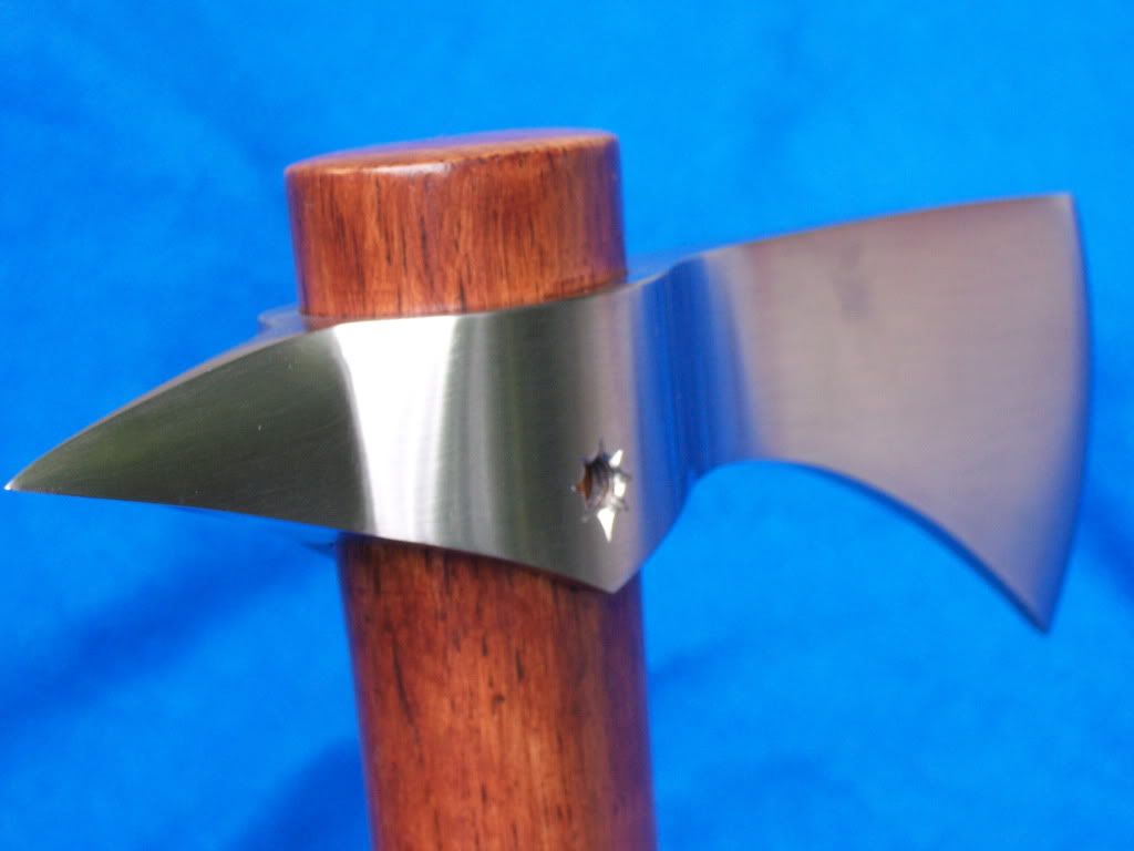

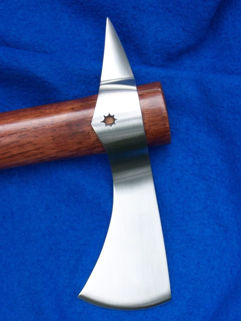

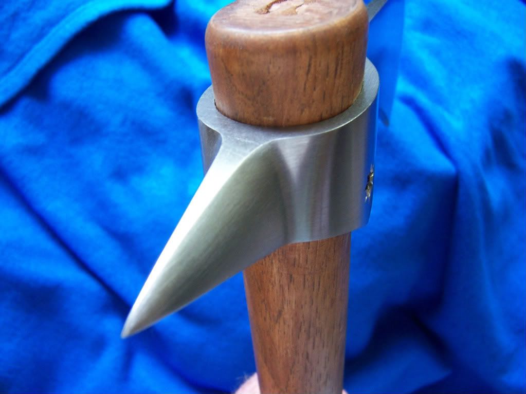

At last another hawk is nearing completion. It is a Trail Hawk. It has been substantially lightened and modified by changing the edge to convex, my star logo, tapered and rounded spike. The finish will be acid blue, the star will be pewter and there will be a rawhide wrap for overstrike . The haft is the original hickory, the finish is still being applied and rubbed out and it should turn out a dark honey color. This year has not been a good year for me as far as the hawks go due to work and family. There are still six other hawks nearing completion and another eight I have not started.
Very clean hawkhead!!
I used a product at my work called Hide Food. It is kind of a leather softener. It may be like saddle soap. We use it on leather car seats to keep leather supple so it doesn't crack and dry out.
