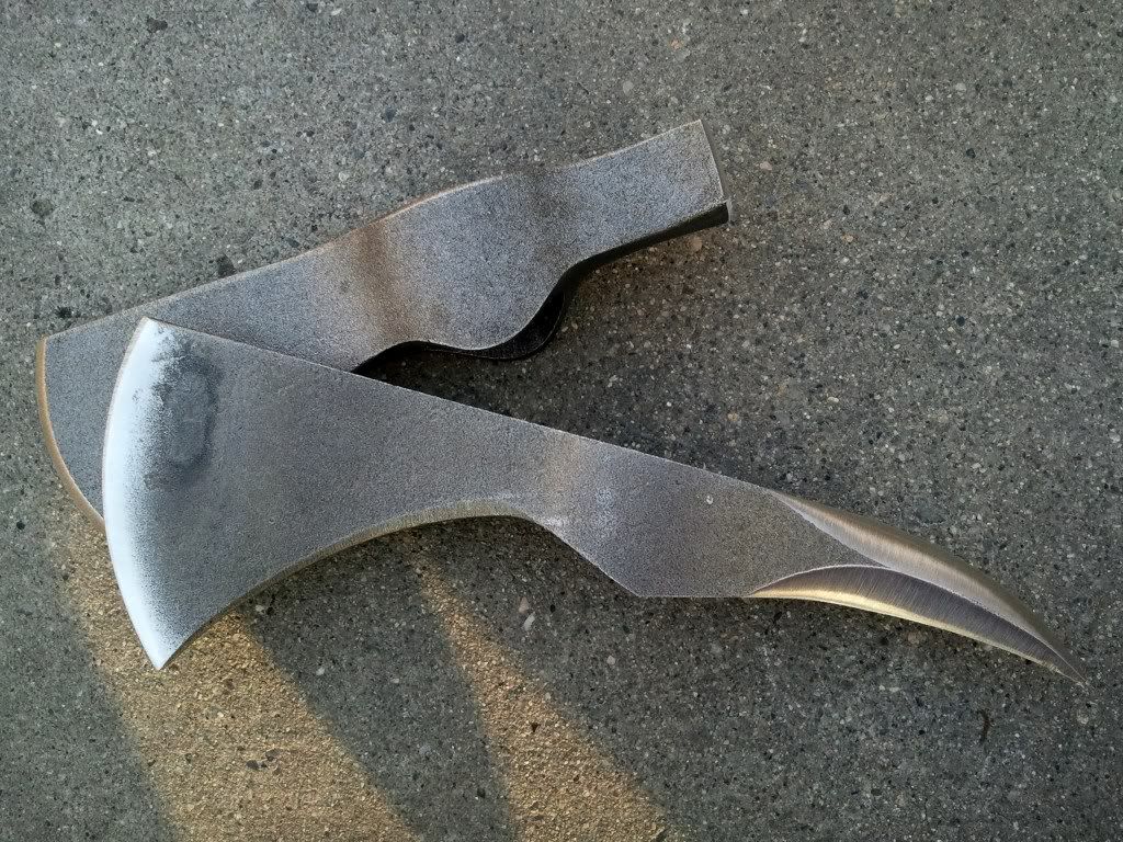

Here's a quick update on my cs hawks:
Both have been stripped and the spike hawk has gotten a partial convex and rough satin spike. Only had a small amount of time to work in the garage so didn't get too far but it's a start.

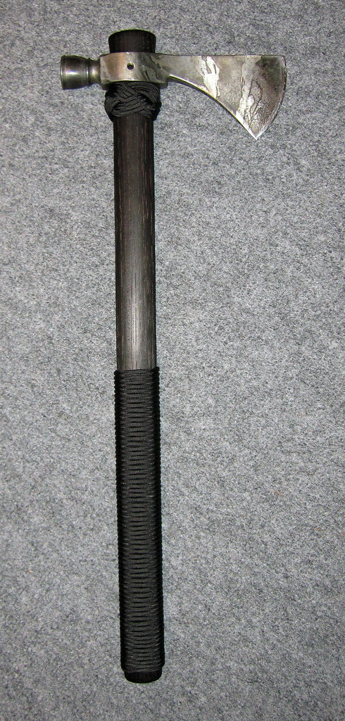

Well, 36 pages of Hawks finally sucked me in to yet another modding hobby. First time doing anything like this but man is this fun. Nothing too complicated - stripped the head, polished up to a point but didn't want to remove too much material and forced a patina. Burned the haft and while it was still hot (and for the next 2 days) let it soak up Skidmores liquid beeswax finish (linseed, turp, beeswax). As a bonus my hands will smell deliciously beeswaxy after a long day of zombie work. Paracorded it up and cant wait to try her out in the field!

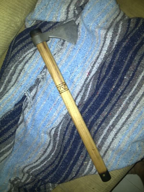

I wanted to make something that looked like my ancestors would have carried a few hundred years ago so I chose to keep it very simple.
The fact that I just started any sort of wood or metal work helped to make it look more...rustic.
The tools I used to make the burns. I heated the screw driver and pressed it against the wood until it cooled or i felt the mark was good enough.
I just realized there are bread crumbs on the cutting board in the picture. I apologize, I made a sandwich shortly before I started on this. I feel like a slob. A slob who likes tomahawks and sandwiches.
I chose to keep the haft as long as it was mainly out of the lack of tools to cut it. Here it is after I burned the ends and I finished my super advanced wood burning technique.
Oh, and I put four coats of Obenaufs Beeswax boot sealer on the haft to seal it up and darken it a little bit. Afterword I rubbed in a coat of olive oil. I would have stained it in coffee, but wasting coffee in this country is a cardinal sin.

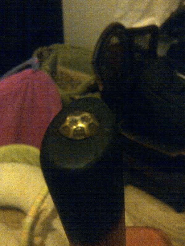

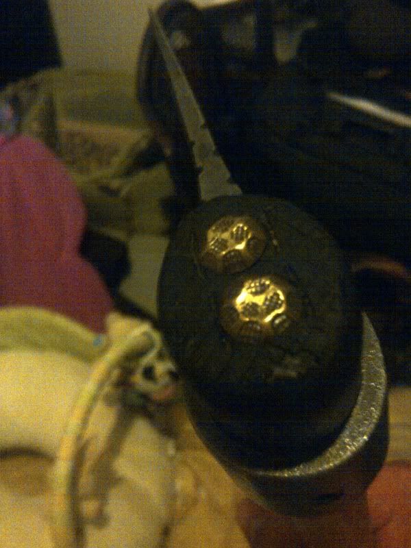

Finally done! Mostly. The two picks below were inspired by another post. I think the tacks add a subtle oomph to my rather plain hawk.
Not as good as most on here, but I think with practice I can ramp up the awesome. Next up I want to get my wife a Rifleman's hawk and go to town with a file.
