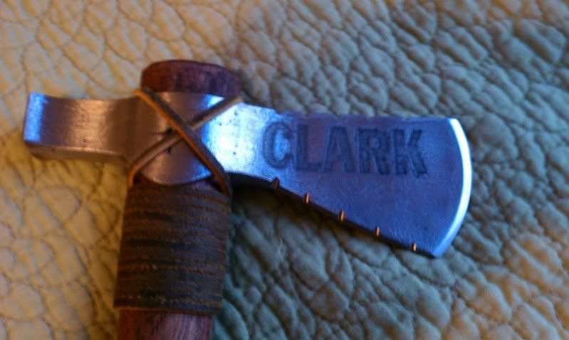

I used a multi-speed dremel on about 1/3 speed with a 1/8" double cut carbide burr to do the notches seen here:

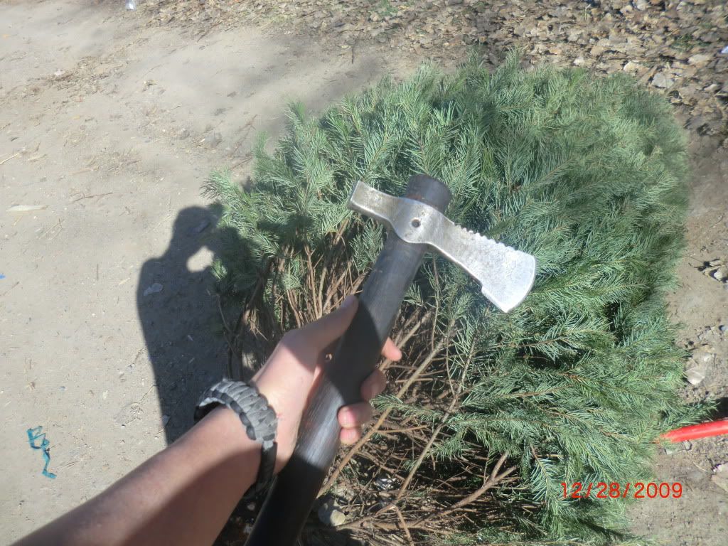

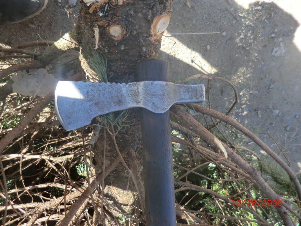

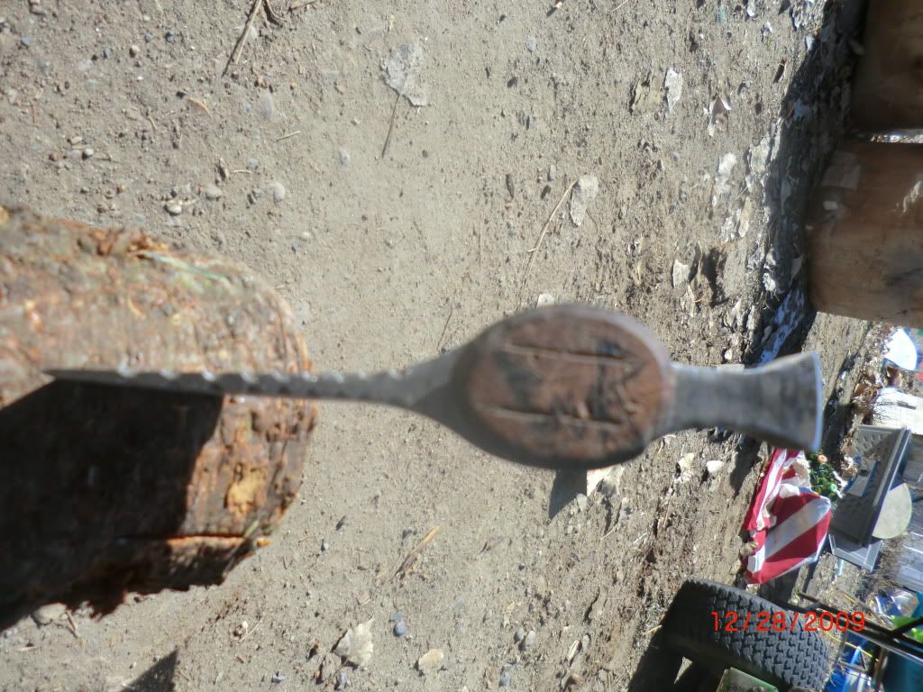

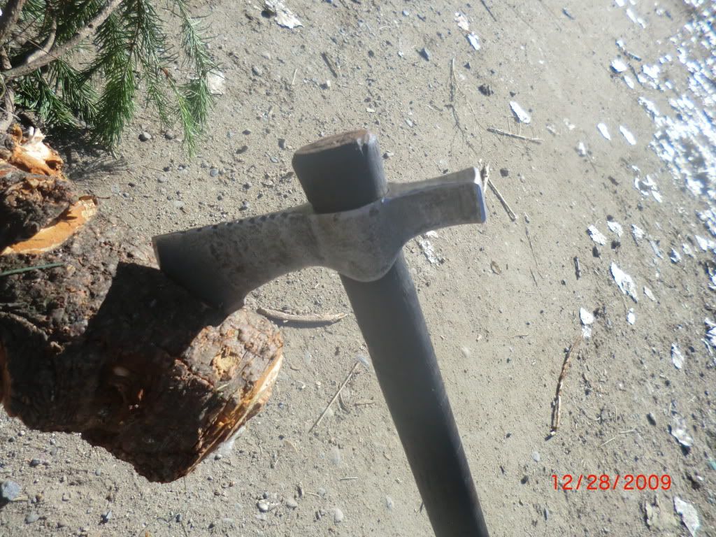

heres my hawk guys! it did have a nice stripe patina but then i processed and debranched about 50 to 75 frozen christmas trees(got the extra from a christmas tree lot that a friend of mine owns)but it held like a champ now it has a nice sap/resin finish haha but i cut a bit off the bottom for hooking and such and sharpened it for skinning and a firesteel did some file work on the top spine
