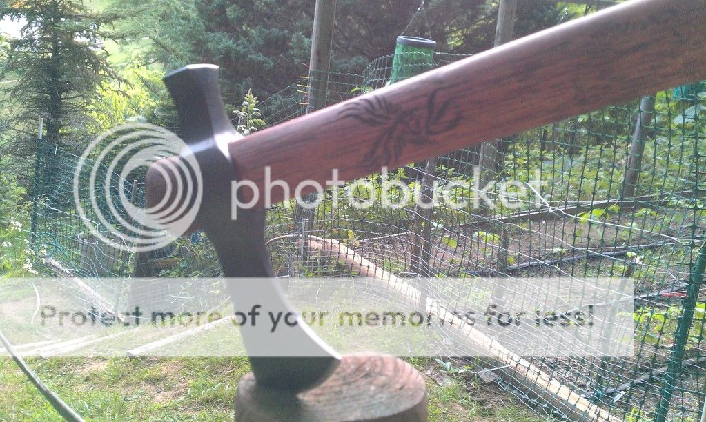

Ok guys I've spent the last three days reading this thread and I had to try modding a Trail Hawk for myself, this was my first attempt.
First I sanded the haft and burned it with a blow torch, then I applied two coats of stain and three coats of polyurethane. I stripped the coating off of the head and lightly sanded it then etched a design with etchant from Radioshack.
And no I don't worship satan...I just thought the cross on one side and a pentagram on the other was cool.

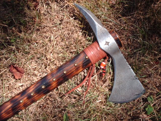

My spike hawk is actuallya CS Trailhawk and the hawk with skull crusher was a CS Pipehawk. I have eight more in the works, so stay tuned.
Looking forward to seeing them! Youre work inspired me to pick up trail and spike hawk. Both currently still WIP.

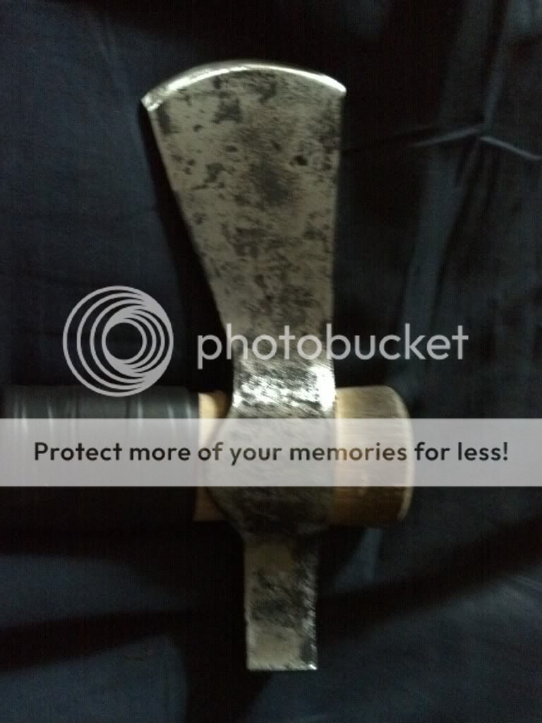

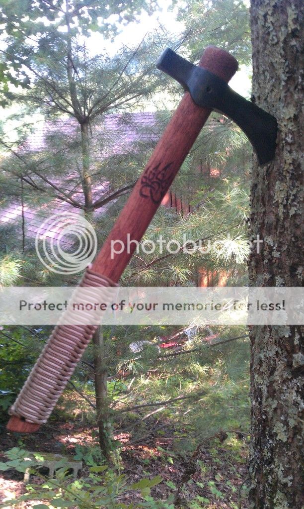

Time to add my own hawk to the mix...

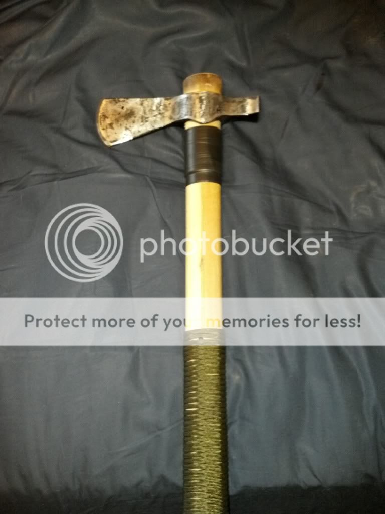

Not that fancy of a mod, but I like it:
Handle was cut 4 inches shorter then wrapped in OD green 550 cord. Just below the head is a mod my grandpa always uses on his axes, basically a duct tape shock absorber - mine is 7 layers thick, then tightly wrapped in electrical tape for looks & longevity (duct tape wears down in water/heat. Electrical tape doesn't.) Top of the handle above the head is burned just a bit. The head itself is belt-sanded to strip away most of the paint, leaving a neat forged pattern.

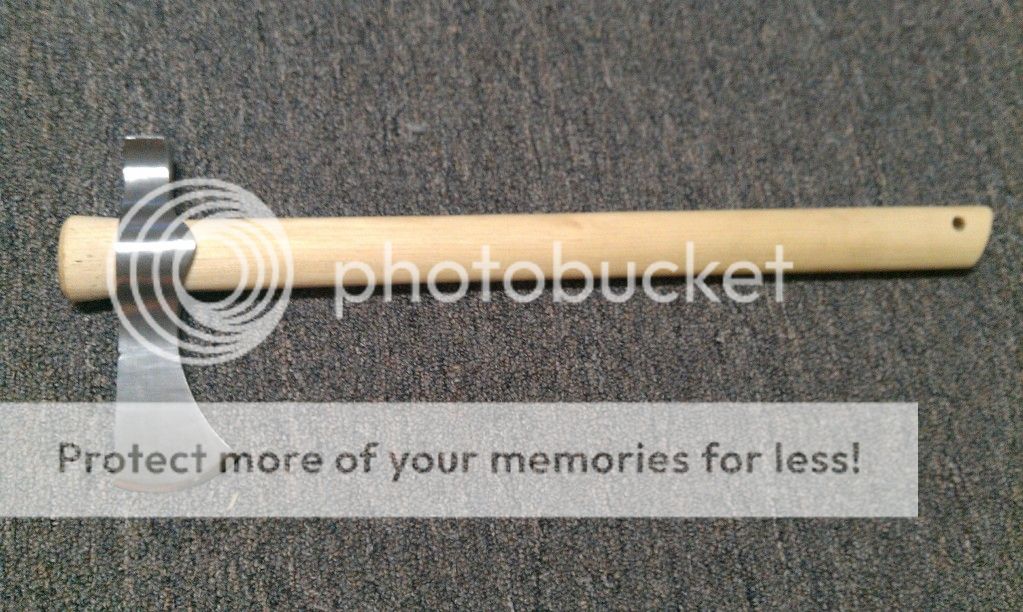

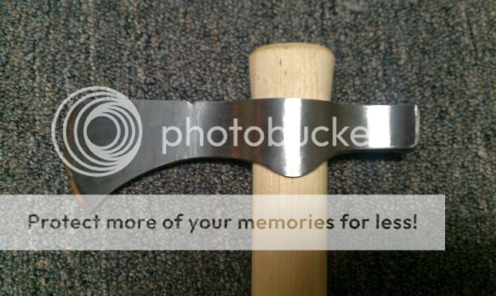

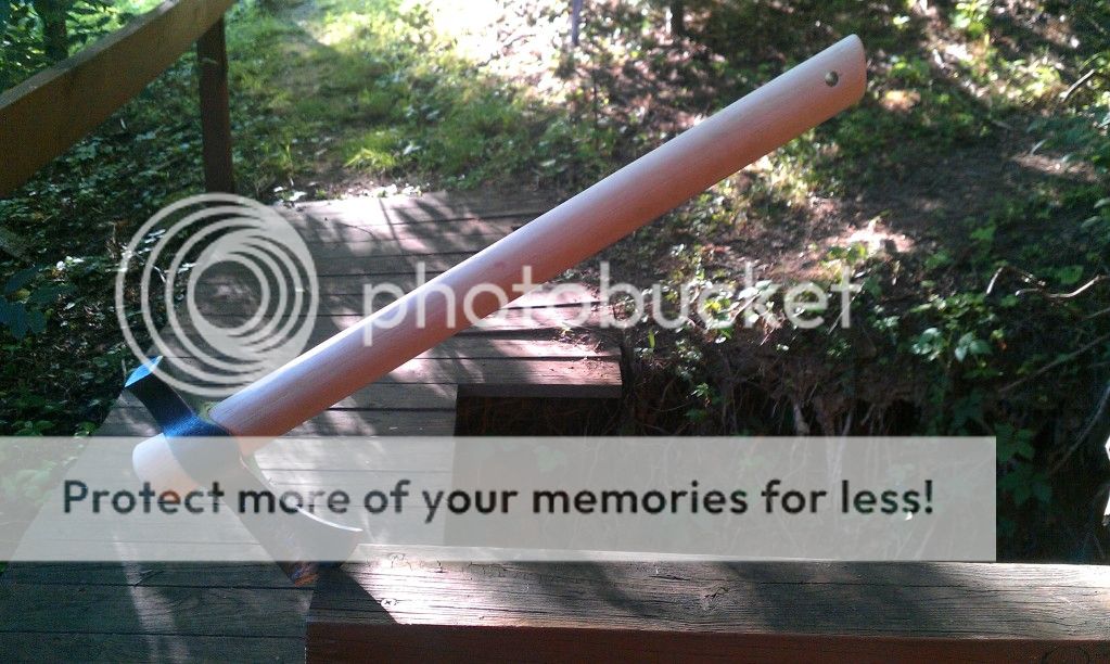

Here are a couple pics of the progress on my T-hawk. Altered blade geometry and ground out the pitting. Still have to oil haft, a little more sanding on the head, and some file work before bluing. Can't decide between a carved friction grip or 550 cord.

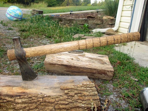

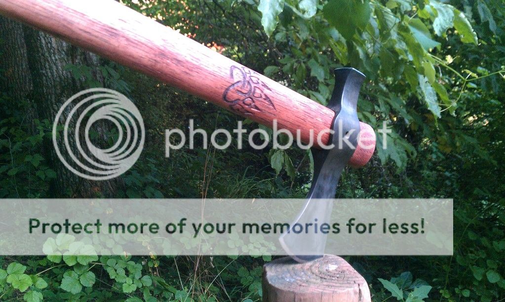

Here's my recently completed Trail Hawk Mod.

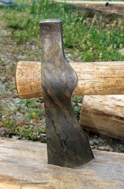

Cut the handle down to 19" and added fitted it to the head. Also beveled the inside of the eye so it would fit the handle better. Cut some grooves with a chainsaw sharpener in the handle, stained it with some walnut stain. Stripped the head with Jasso, soaked it in a bucket of bleach water to rust (came out with some cool streaks) then darkened it with tomato juice and put a bit of cold blue to finish darkening it. I'm quite tickled with the look. Oh, also convexed the edge so it's a sharp sucker.
I did not do any grinding on the head after I stripped it. I liked the rough texture and figured it would add to the old look.
I'm working on a spike hawk. Just put the rust stripes on it and will blue it on Monday.
Thanks for looking,
Charlie
Beautiful work, CShep. The patina you achieved is outstanding! I would like to try it on my next one... if you don't mind. I assume the tomato juice gave it the red streaks. Do you think using other organic acids, ie lemons, limes, etc, would have the same effect but with different colors?

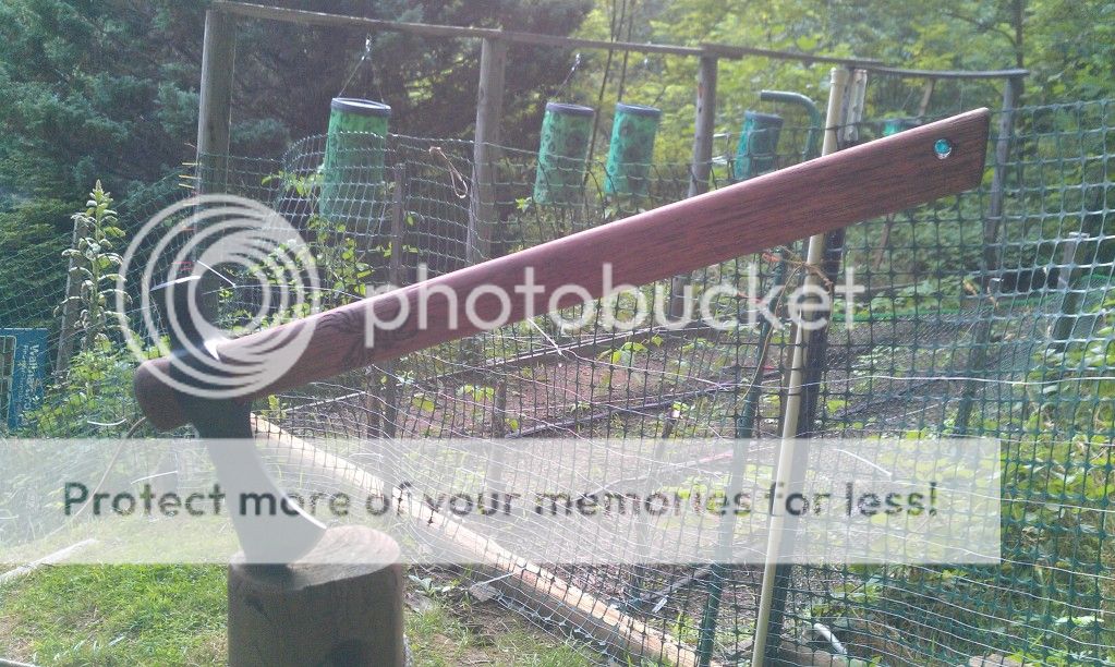

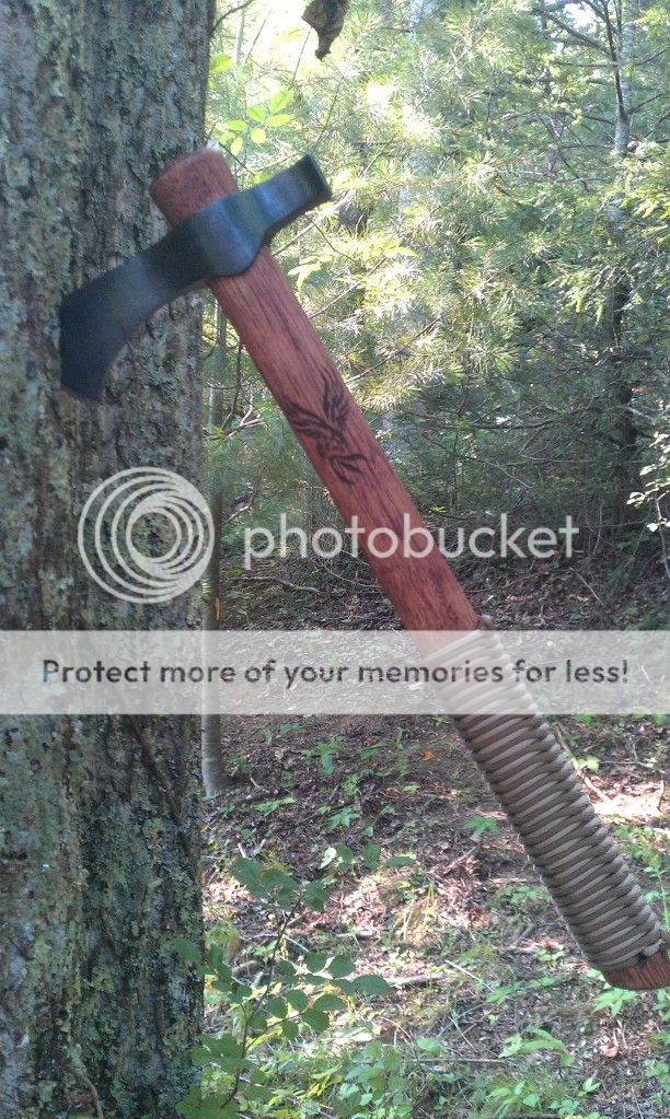

Here is my finished hawk, with and without wrap.
