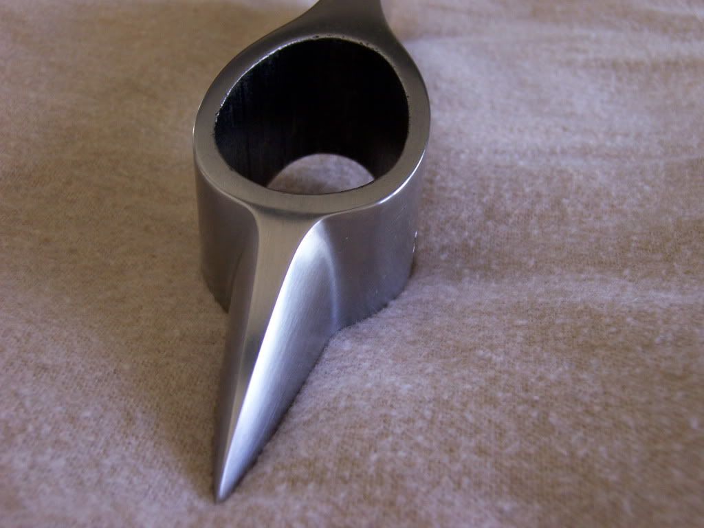

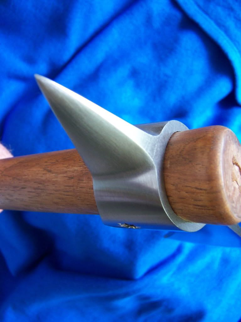

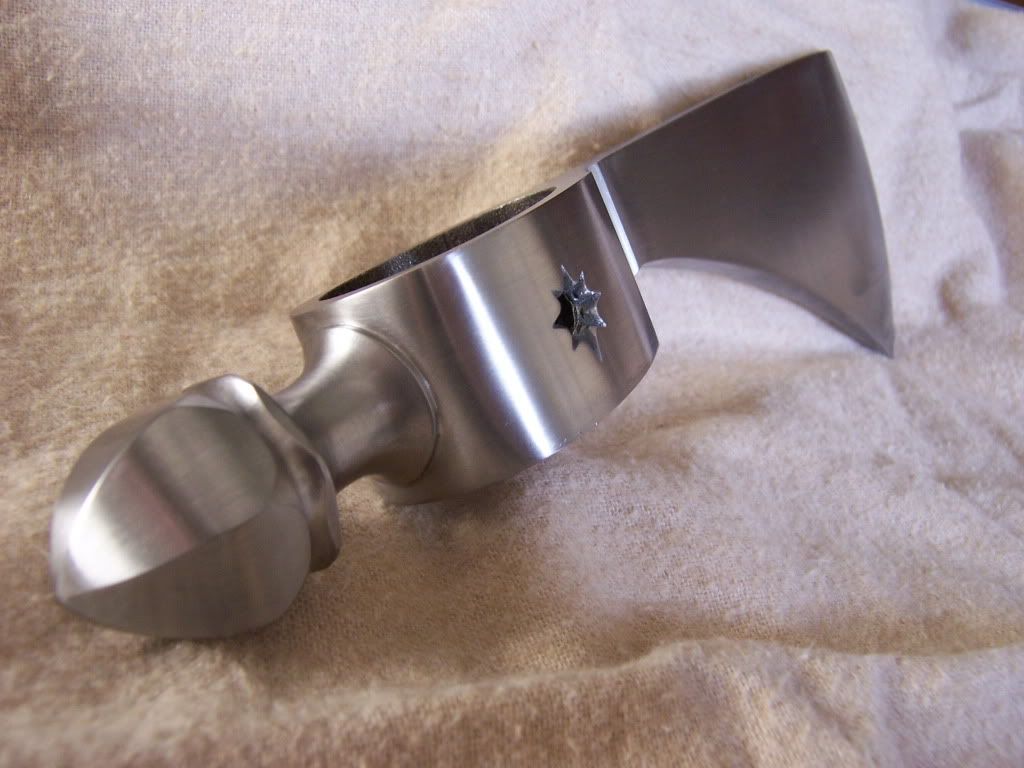

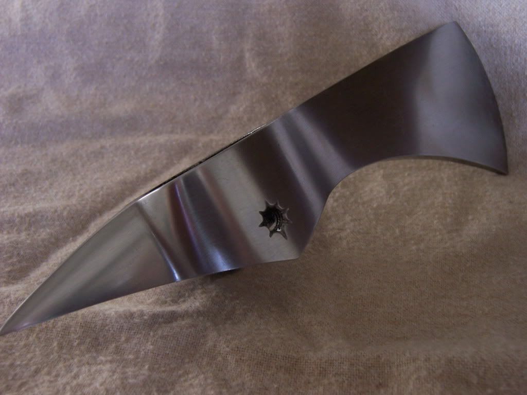

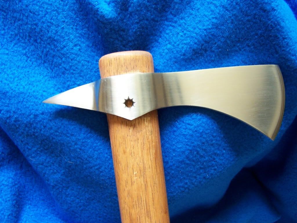

Back in business fellow Hawkmen! There are six in the works and I've got a few days off, so the first to near completion is a CS Trail Hawk. All surfaces were cut down to reveal a nice light hawk I call my Ultra Light Fighter. The head will be acid blued and there will be my pewter star. The pic of a CS Spike hawk, under modification will become the Light battle hawk.
I was thinking of doing something similar to my trail hawk but a square kind of spike. I must ask how you did yours!
Can it be done with a simple file?
regards.
Hi gorbys, All my modified C.S.hawks are done in the same manner. Strip the head, draw the shape of the hawk with a thin point Sharpie pen, gross metal removal I now do with a bench grinder, all my finish work is done with a Magicut file and final metal finish with medium and fine emery paper then 400 and 600 wet or dry lubed with WD40. The satin finish is accomplished with a green Scotch pad. In the beginning I used only files now I use the grinder to save time .
Hawkhead all a can say is WOW !!! Great work, i will be ordering my CS hawk and start to get busy! Again good job.
Thank you fellow Hawkmen. Keep on making hawks. 19 days to retirement, then it is full time hawks, bows, knives, hunting and fishing. Oops, almost forgot kayaking.
HandAxeProMan,
My spike hawk is actuallya CS Trailhawk and the hawk with skull crusher was a CS Pipehawk. I have eight more in the works, so stay tuned.
hawkhead, sorry I misread or assumed (you know what that does). I love BOTH, but I really love the small "Spike Hawk" you created. I will definitely stay tuned for all updates on the other eight.
