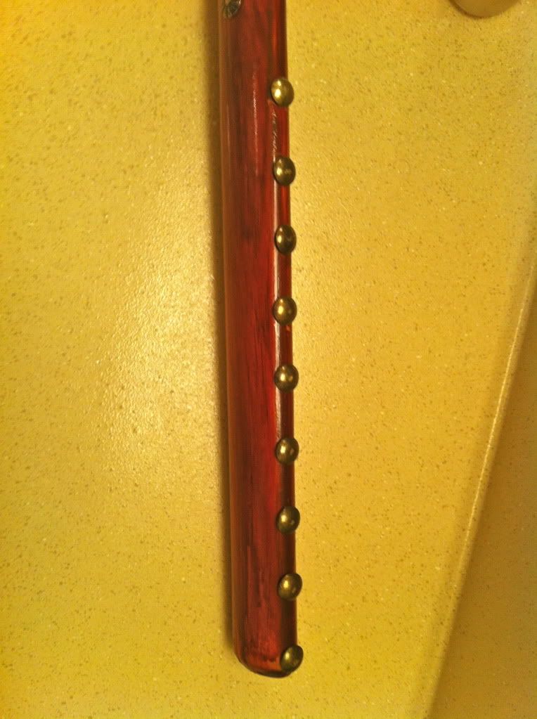

Hey Ponsau,
I just checked out your Norse Hawk - it looks just awesome! Did you do anything with the setscrew hole, doesn't show in the pictures. I'm thinking about putting some sort of decorative screw in it, looking similar to the ones on the handle here:
I had an older Norse hawk that had no set screw. They used to come without them. Yeah I want to put tacks or something like those on the handle of my pipe hawk as well. The pipe hawk has a set screw I will remove, but want to file it and fill it. I'm busy moving so haven't been able to work on it. I have seen these tacks at leather stores and furniture stores here. You could try a hobby shop as well.

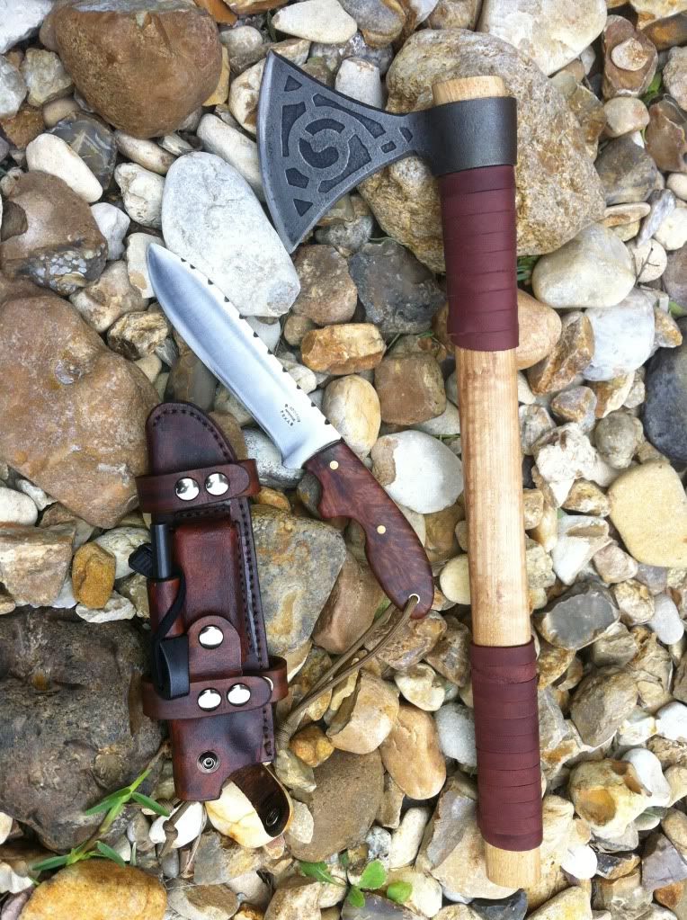

@Ponsau
Hey,
I just took another look at your pictures again admiring your awesome hawk ;-), and I was wondering whats the knife in the last picture? Looks quite cool, and I like the sheath with the holster for a fire-steel.
