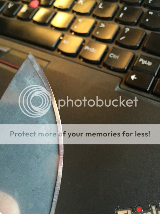

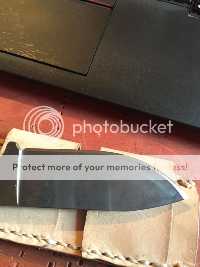

I got my Becker BK24 knife and over the last week its D2 blade has held up amazing. Thank you!
What I still cant grasp is how the heck you can get it so sharp. I have similar tools as you, yet can never get my knifes as sharp. You doing something very right or got some magic tricks going, either way keep it man and congrats on finding that secret recipe.

would you mind posting a pic of the bk24? I've got one I've thought about getting a regrind on several times.
Josh, what did you do to this one?
I don't have any pics... Maybe bigC does. I simply reprofiled the edge to about 15 dps then microbeveled on the Wicked Edge with a 1k grit edge.

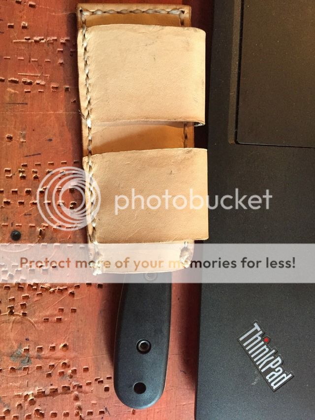

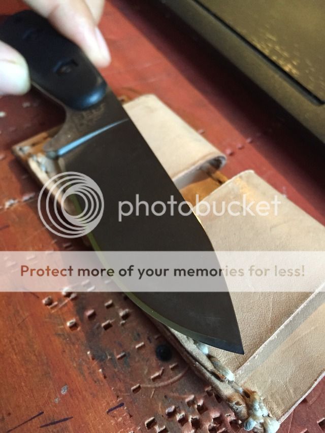

I been putting to use a lot both in the kitchen and on my outdoor needs. Crazy sharp still but I do put it through leather with .5 micron after using it heavily.
