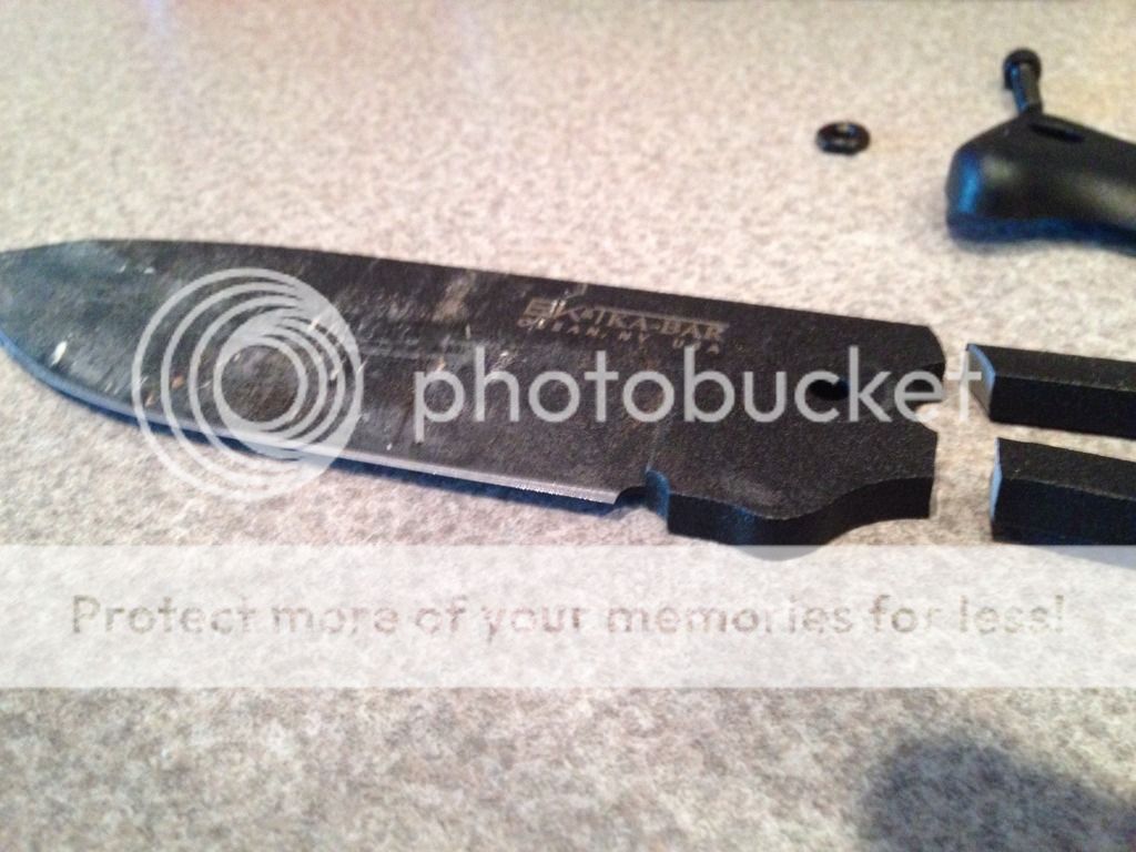

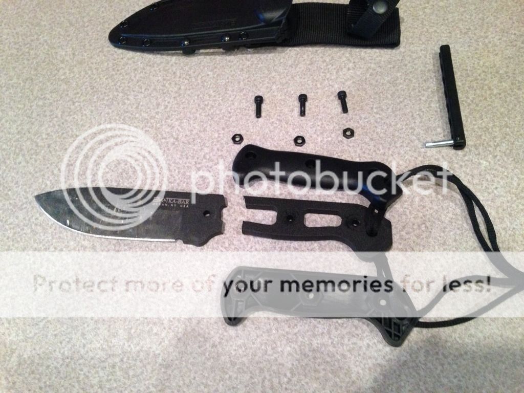

My bk2 broke under the scales!! WTH!

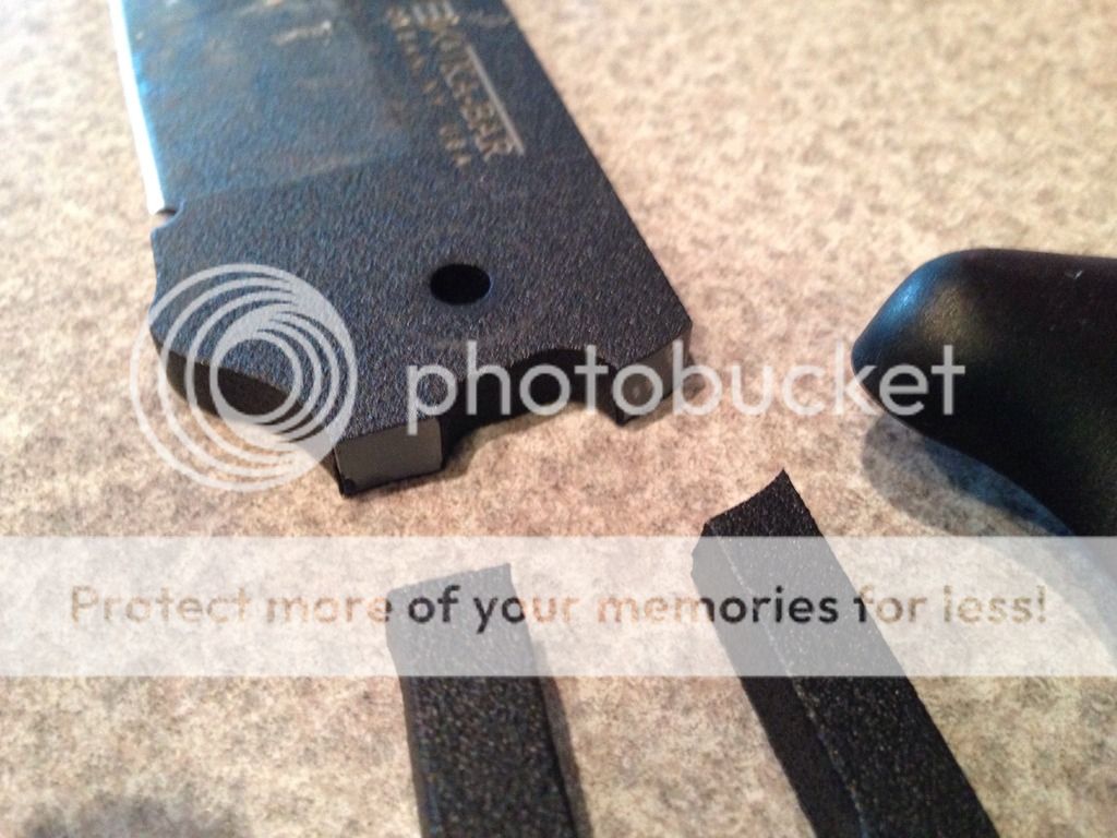

The reality of this situation is that nobody other than the OP knows just how much of a beating that knife took before it broke. From the look of that log, it certainly appears that there had been other unsuccessful attempts at batoning through it; and that comes as no surprise given the knots. I understand that the hype suggests the BK2 is indestructible - a veritable beast that will take every ounce of abuse that can be dished, and laugh at you while asking for more - but, at some point, common sense should come into play. Now, maybe the the OP was having a good time beating his BK2, and he didn't heed (or didn't recognize) that little voice that sounded....or, maybe he literally gave it a few whacks and it crumbled in his hand. All we know is what we've been told - I'll leave it at that for just a moment.

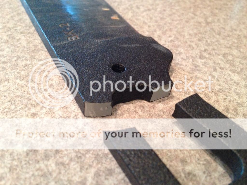

In another such instance of a Becker breaking in that manner, Ethan stated that it was a heat treat issue. I'll be honest, I don't know enough about such things to make a claim either way. Maybe the heat treat is to blame, and the knife broke before any reasonable person's common sense voice would have complained. Then again, maybe, just maybe, the OP should have considered that batoning through that particular log wasn't the best idea. Maybe not at first - nothing wrong with trying, right? - but by the time he was lining it up for the third attempt? Of course, that statement makes an assumption that those other marks were by attempts with this same knife. If I'm going to run with that assumption, I can't help but suggest the idea that the wielder of the knife is at least partially at fault. Yup - even if it was a bad heat treat. But that's just me throwing ideas out there.

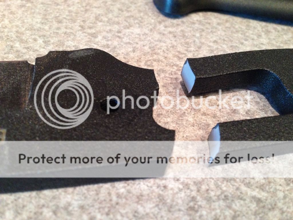

I wonder if the area it broke was the soft steel meeting the hard steel, temper line? Seems a rather clean break.

Hey man, no worries. We're about honesty here. To be fully honest, the reason the log looks like a carved up pie is because I got halfway through the log to split it (unsuccessfully) with my 5160 RTAK II, and I bailed on that due to it being 3/16. I simply figured that the bk2 with the CroVan and 1/4" thickness would best it.

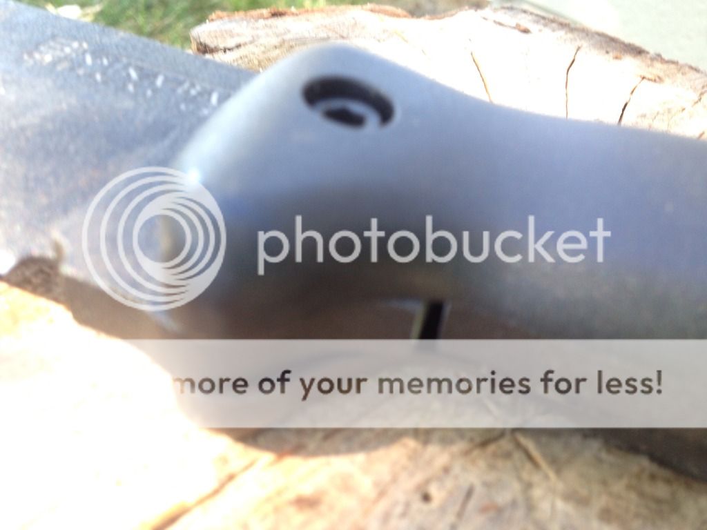

I have to admit I have had my bk2 for 3 maybe 4 years, and I used it as my only camp knife many a trips, I've beaten it through wood it was to small to span, I've beat the handle, I've just plain beat it lol
I under stand *proper form* but I never even heard of proper form when I was beating my bk2 in all the wrong ways... probably much harder and many more times than the OP.
I personally think there is a flaw in HIS knife, and beating the handle exposed it. Better to find out his knife is flawed this way than actually depending on it.
If there is a flaw in the steel, feather sticking won't expose it.

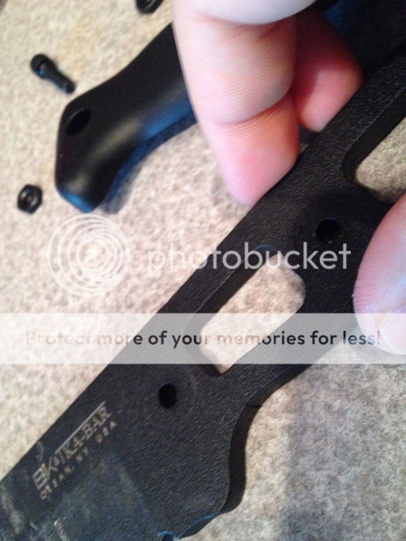

For my money, if were looking for a BK-2, it would be one with a solid tang (i.e., no cutouts) or bust! YMMV.

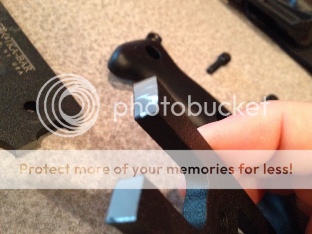

To my uneducated eye - the breaks don't look right to me. As I said before, though, I don't know enough about that matter to make any claims.

Is that rust? What is the small dark inclusion that appears on the bottom of each section of tang at the break; they may be stress cracks from the original heat treatment. Can you post a close-up image of those areas.
Certainly, and last night I did a bit of searching around Bladeforums and Google for instances of a busted bk2. 1 was the 2 that was thrown hundreds/thousands of times, and then the other 4 were broken similar to op's. All of which were admittedly doing heavy lifting including the guy who was bashing his 2 through a log with the back of his axe. This is what I could find, all of them laser etched. One of those breaks was slightly different than op's but similar enough. In those instances it was thought there could have been a potential heat treat problem causing breakages across the temper line, through the cutout. Does this represent a more rampant issue? Don't know, again though it would be interesting to see the data.

I already put her back together and put her away, but what it looked like to me was the coating slightly curling over the edge of the break on the bottom side of the break. Maybe I'll try to get another/better shot of it, buuuuut I think I can say with certainty he that it's not rust.
