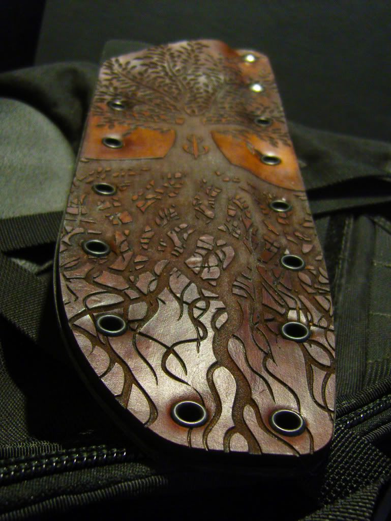

Hey Patrice if you want a rattler theme for the sheath just let me know. I'd be happy to use my 130w Co2 laser to engrave a wicked rattler theme. No charge.
Here is a sheath I did a few months back. The detail is truly impressive. PM me if your interested.
The knife looks amazing BTW.
That looks great William and I do appreciate the offer. I'll give it a go to see what I can come up with and if I am not satisfied, I'll take you up on it.

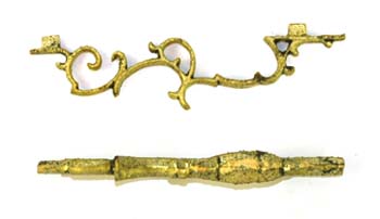

Patrice, I think if you thinned down the ring guard a bit in thickness towards the end it will help it look lighter. It reminds me of some of the fancy trigger guards on old rifles.
-Xander
That is a really good idea Xander, thanks. You would not have a picture of the type of riffle guard you are talking about? I am always on the lookout for ideas for future knives.
Here are. Couple quick pics I sourced from Google images, but if you do an image search for "ornate trigger guard" you will get lots of good results.
-Xander
maybe if you make the guard longer, same size loop, and then bend it along the curve of the handle in a mortise so it would sit flush?
