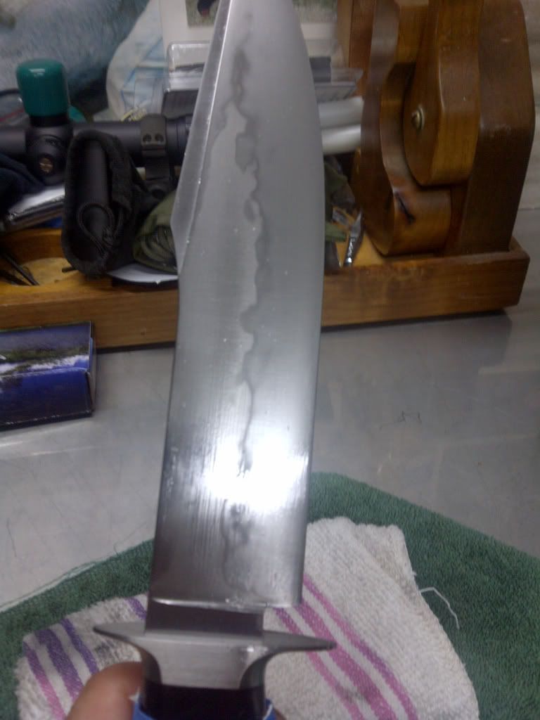

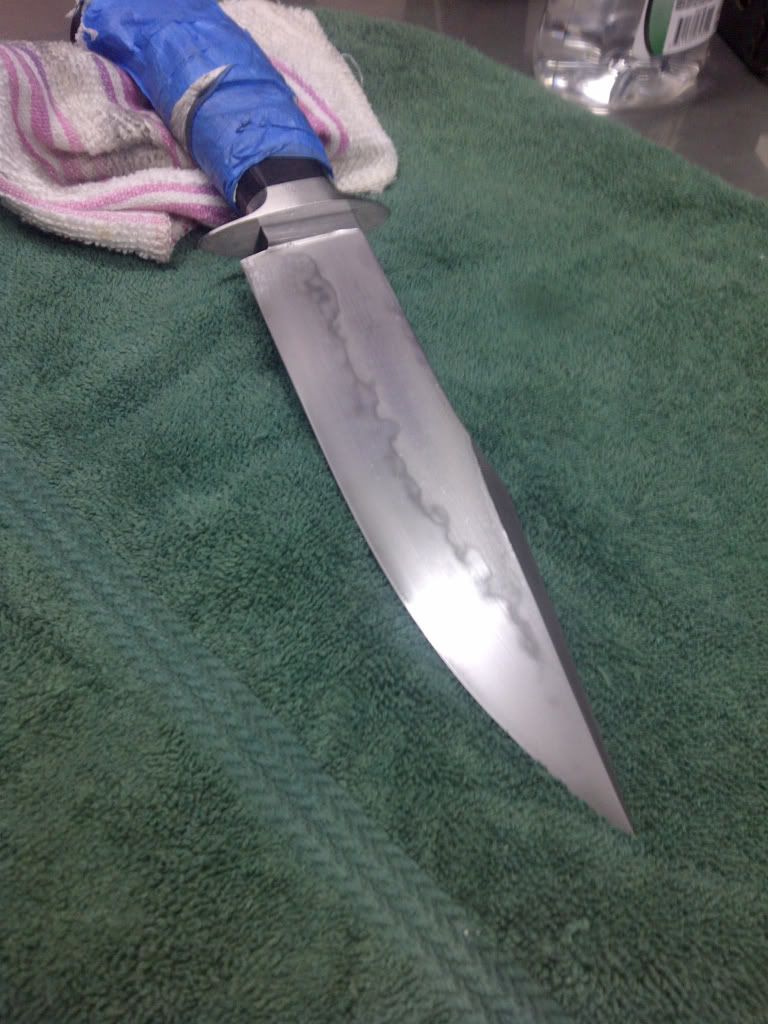

A lot of u might say that this is sacrilege to alter a Wheeler but as you know some of these had a temper line but it was not brought out i have another one of these coming and the proto had such a neat temper line i gave it a quick etch I'm not yet done polishing it out but I think it looks pretty cool
Here ya go
Thanks guys
This was just a quick etch and the photo was taken after I just unmasked the guard and gave it a quick rub down with
Flitz The blade was then covered in oil and the pic was with a cell phone so I think it looks pretty good
After some more work it should look really good not anything like if Nick brought out the temper line but for my user
Blade I'm happy as hell

Joe, I'm a little disappointed.......I thought the handles would look a little better. That almost looks like blue masking tape.:confused:
Paul
Just FWIW- I would NOT recommend anybody do this, unless they do it the way that Joe did. Otherwise, the chances that there would be etching solution down inside the guard and handle that would later cause rust and other issues would be VERY high.
Nick I did not dunk the blade
I masked everything including the ricasso
I held by handle tip down and applied acid with brush
No etchant came near guard so none could get in handle
I just masked everything in case of a slip or splash
Okay, I "yelled" at Joe for no good reason. :foot:
Of course it looks really cool! :cool: I was just concerned about the acid getting down into the handle.
What he did is just fine. When I saw the tape I ASSumed he dunked the whole knife which, IMHO, is a huge no-no.
I still love ya buddy no worries
Nick was concerned that people would dunk there entire knives in acid which would be bad so please don't :)
